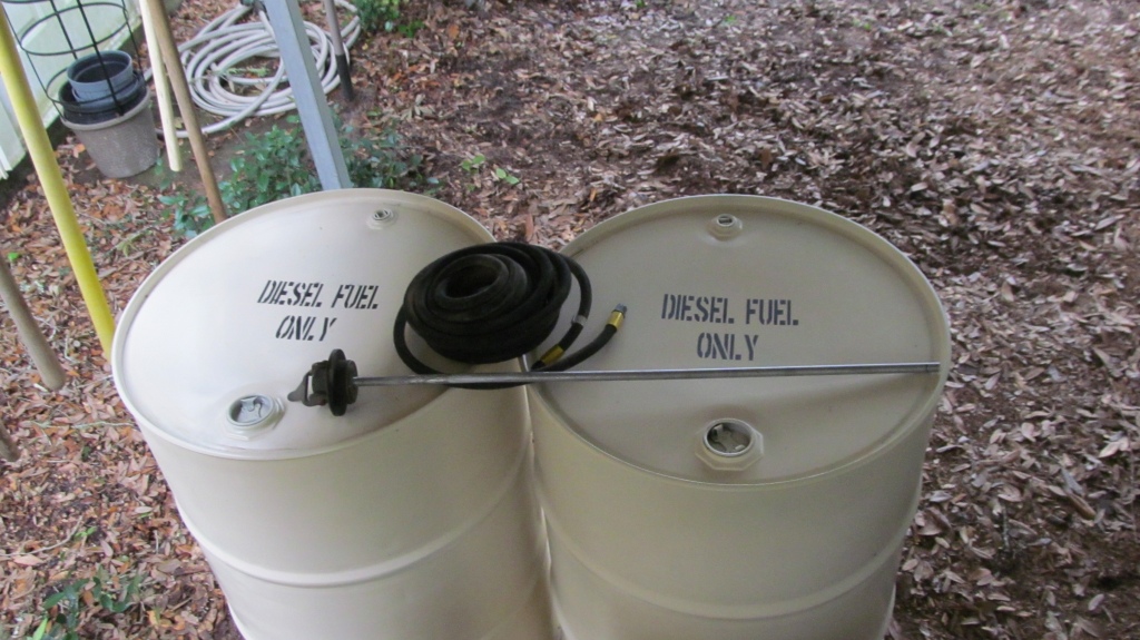

I just set up a diesel generator so I wanted more than the 20 gallons I had been keeping on hand in cans. I did mine on the cheap and got two 55 gallon oil drums. The drums were clean with only some new motor oil residue in them and cost me $15 each. I painted the drums to blend with the color of my generator. My generator has a transfer pump/float switch that sucks fuel from the drum to fill the tank on the genset and shuts off when the generator tank is full. So far I have just used a separate 12v pump to fill my 5 gallon cans from the drum and I still pour the fuel into my tractors.
Local supplier delivered 100 gallons of off road diesel for $2.26 per gallon plus 7.5% sales tax. They have a 40 gallon minimum and the price goes up to $2.55 if you buy minimum. No delivery fee other than fuel cost reflects amount purchased.
