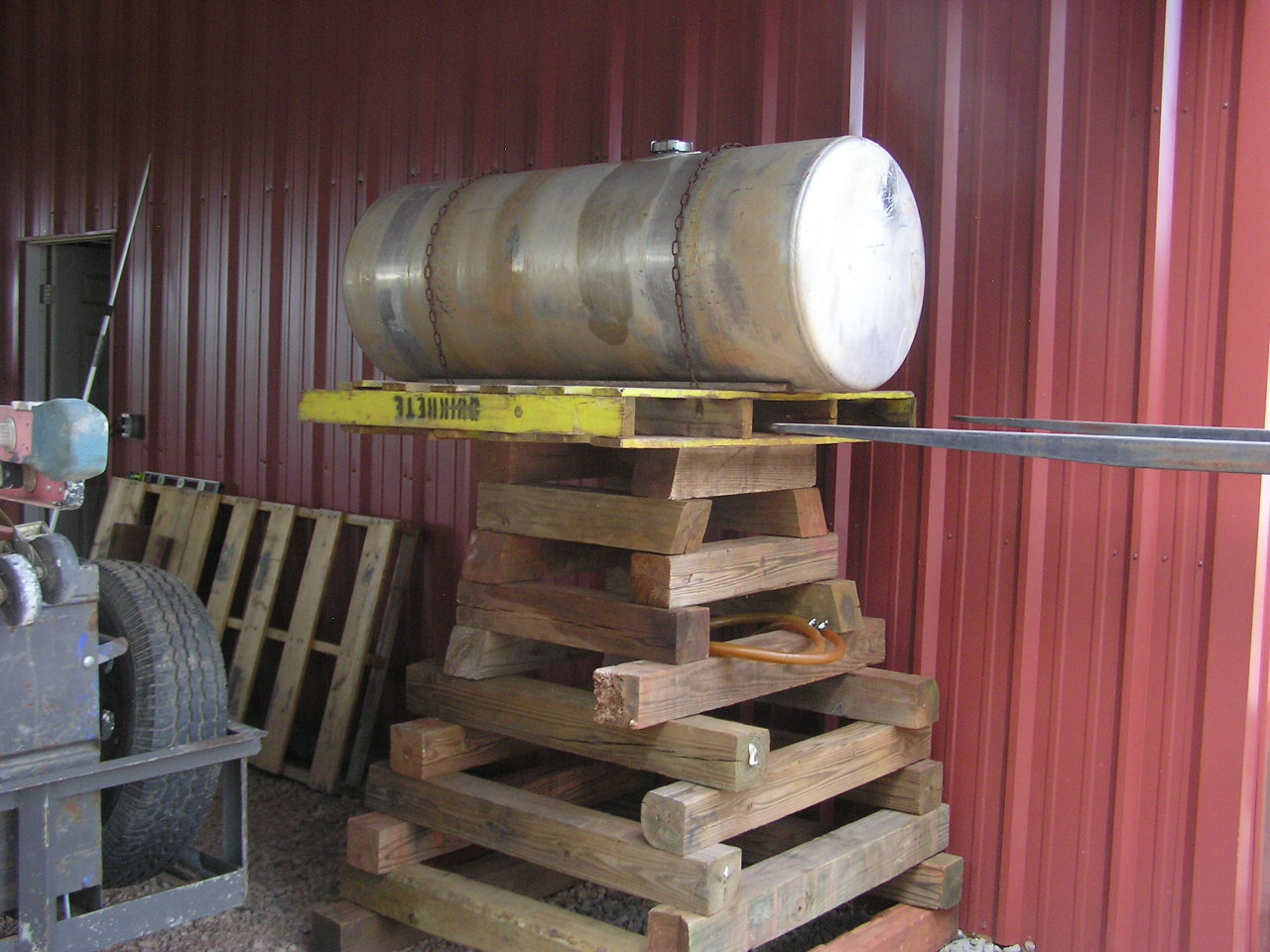

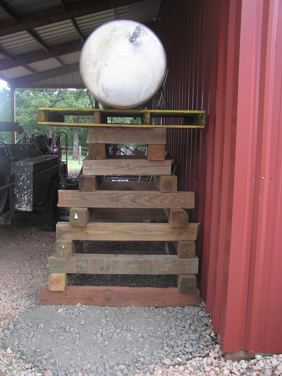

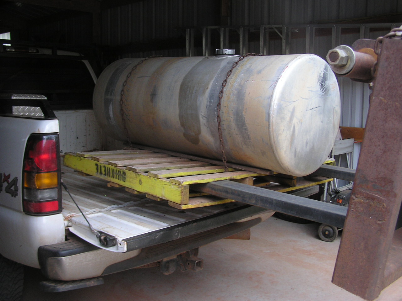

I started with a 55 gallon drum strapped to a pallet with a manual pump. Would fork it onto the truck & run to the gas station down the road to fill it with off-road diesel. Then fork it back off into the barn.
Upgraded to a 300 gallon tank on a stand in the shop & delivery. 250 gallons (what you can safely put in a 300) will probably last me a year or 2, but I wanted a stash to have in case of emergency. Also bought when it was cheaper last fall.
If you get a lot, get it in the winter so it's a winter blend & won't gell. Even so I put some biocide in to prevent slime growing & some Pri-D as a preservative.
