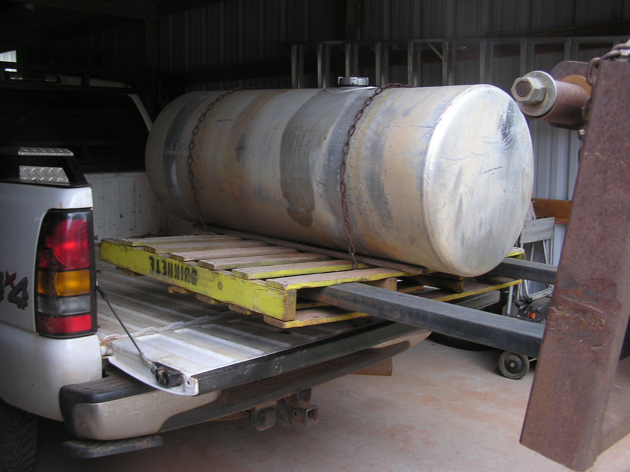

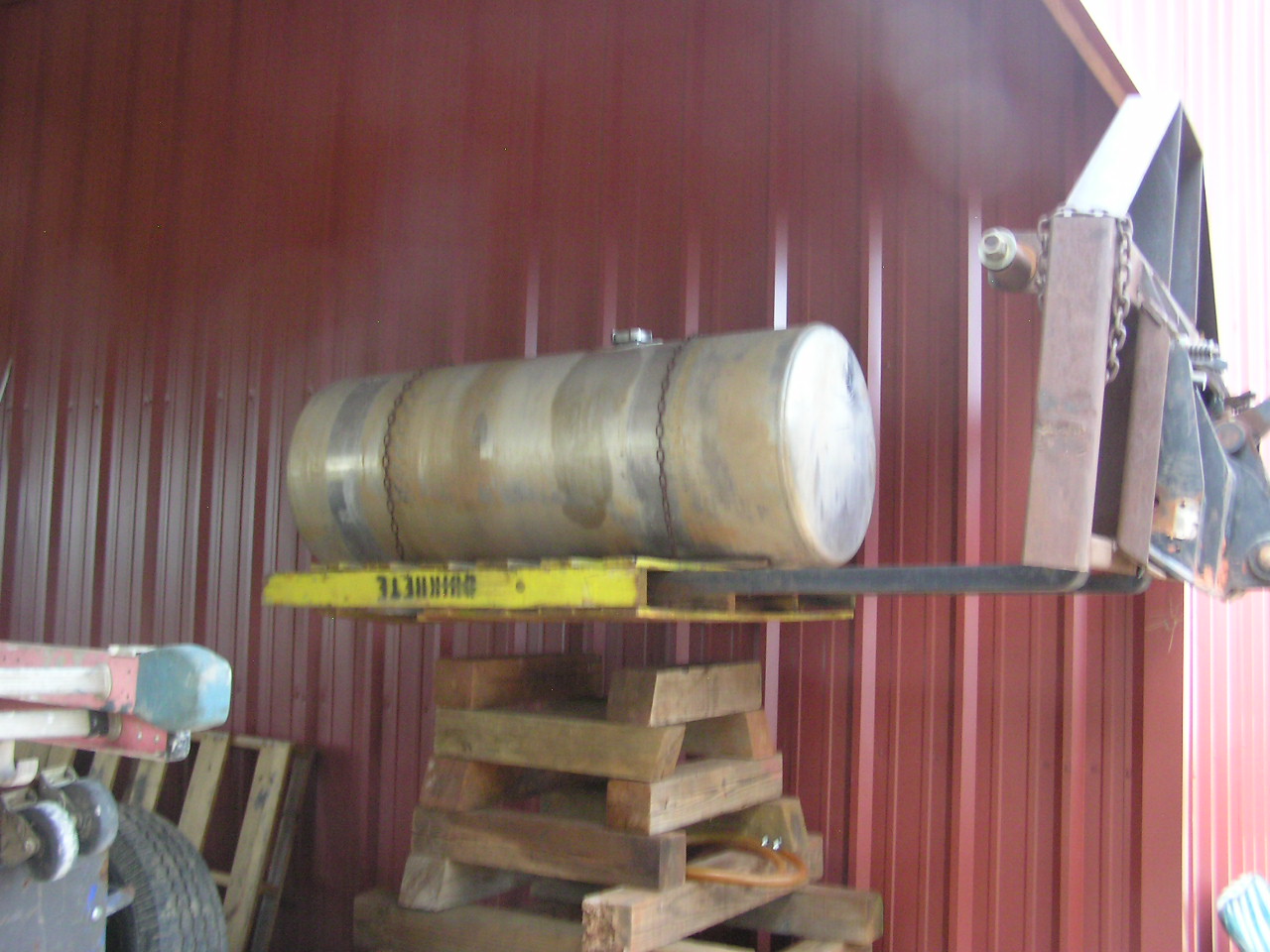

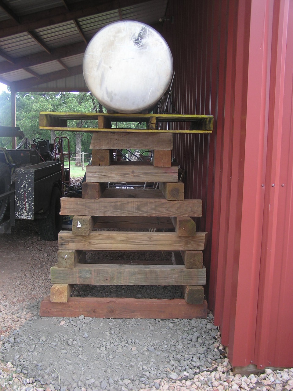

Several years ago on craigslist, I found a 100 gallon saddle tank. Removed the drain plug, put in a quarter turn ball valve. Fastened it to a pallet. Made up a clear tubing fill hose. Gravity works, slow, but free. :D

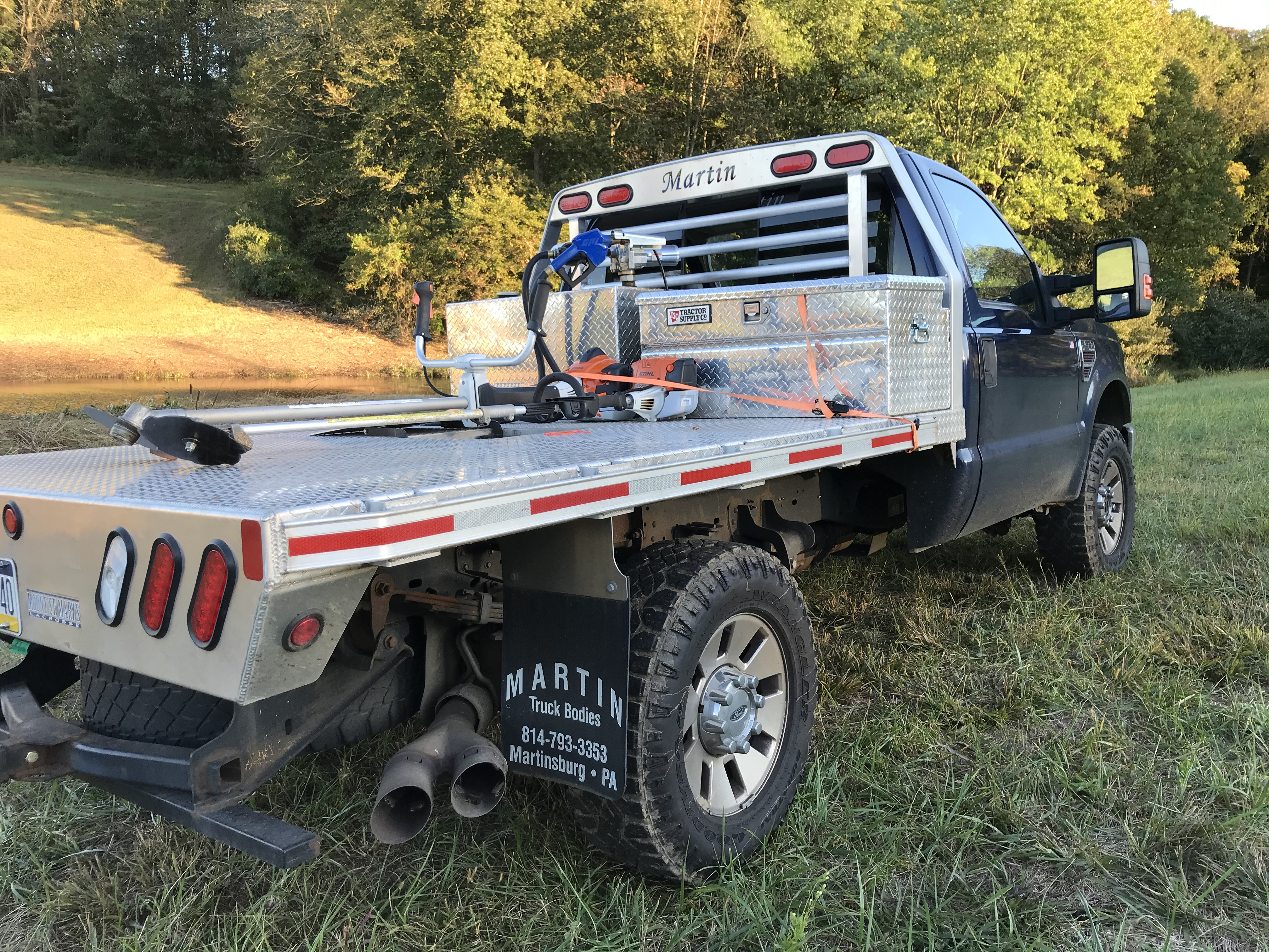

Can you do a truck mounted transfer tank & pump? I’ve had one them mounted on various trucks for 25 years and it’s one of the handiest items you‘ll ever own.
