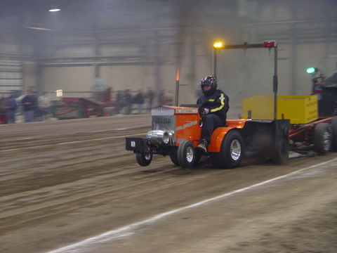

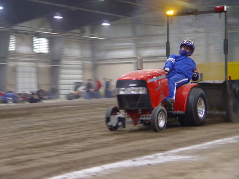

Columbus, OH Winternationals 2010

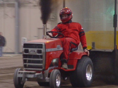

Columbus Winternationals 2010 #2

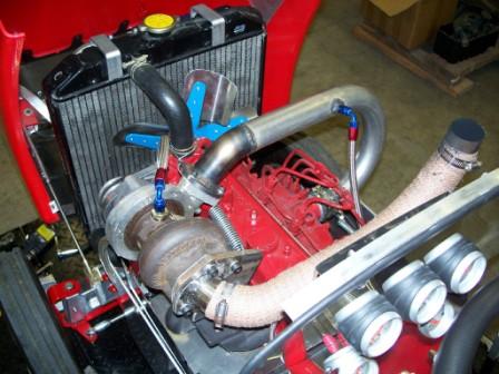

Iam starting a build on a diesel puller and i was wondering what size turbo are you useing and where to get one?

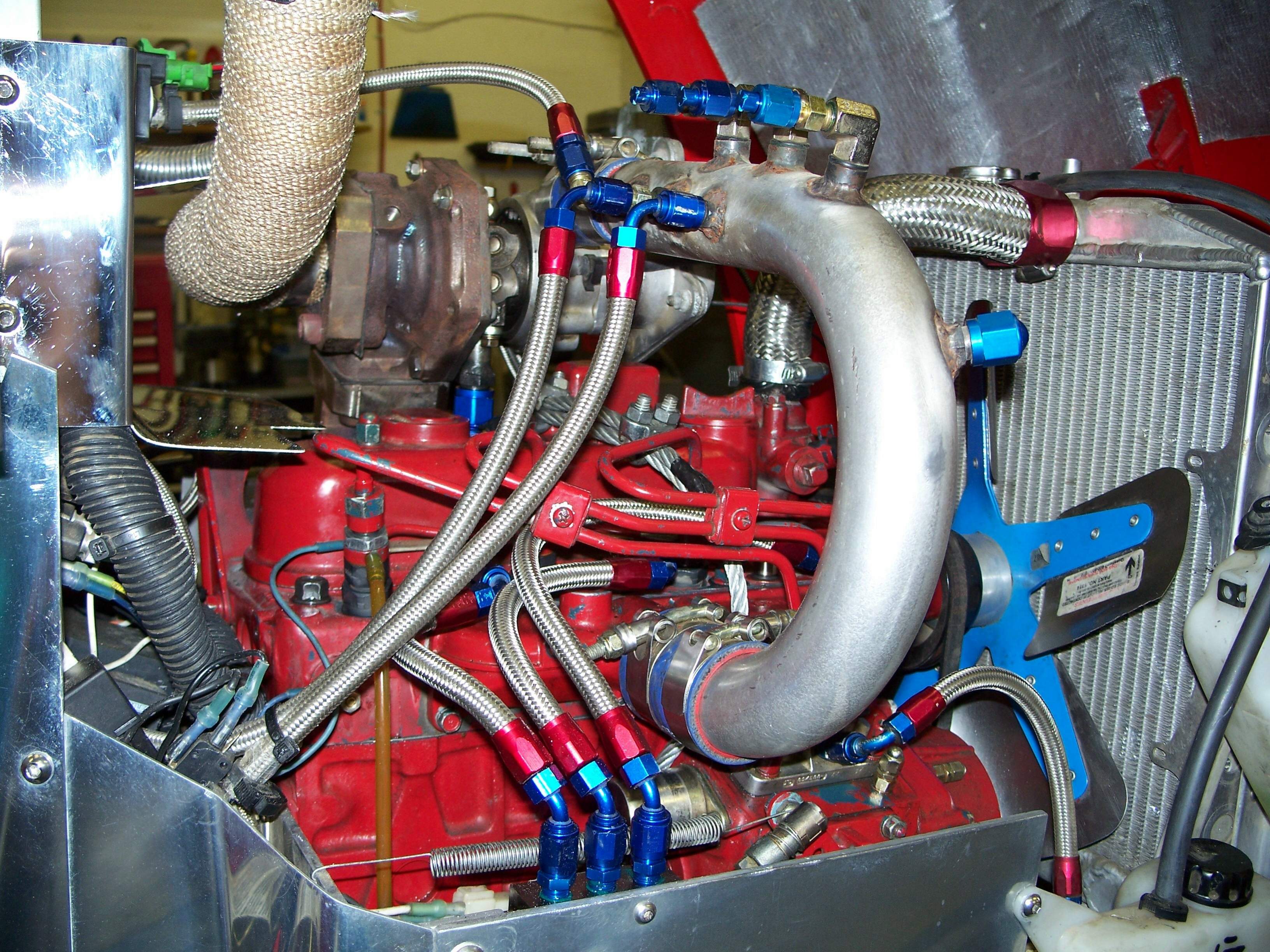

Depends on the engine and what you are doing to it. Direct injection engine or indirect. Garrett GT12 & GT15 are popular in the 60-75 cube 3 cylinders. Mitsubishi TD02 twin scroll works well and is a whole different approach.
Ebay or any good Diesel Service company sells them.
Columbus Diesel Supply. Diesel Service, Parts and Repair.
   / Diesel garden tractor pulling #49
How did you go about getting oil to the turbo and do i need to anything to be able to handle the turbo such as better head studs ect.?
#50
Take a feed from the oil pressure gage port. Drill & tap hole in side of block for drain back or weld fitting on oil pan.
We run 40#+ of boost so things have to be done to control heat and pressure. How far you want to go depends on your wallet. Stay under 20# or so and things get much cheaper but you won't go as far down the track. Depends if you have any intentions of pulling nationally or just some local stuff mostly for fun and to impress the neighbors.
A good fuel and turbo setup will be at least $2000. Then you need water injection, etc.
