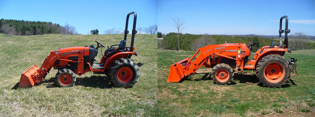

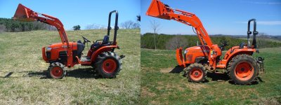

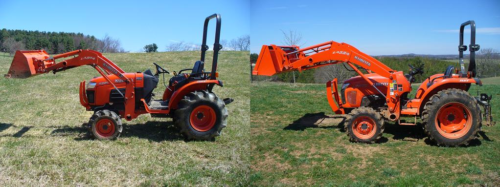

Here's the length comparison between the loader on the B3200 and L3200, as I suspected the loader on the L3200 sticks out a good bit further. All measurements are from the bucket pivot pin to the front axle center line. The distance from the bucket edge to the bucket pivot was 24" on both tractors.
Ground level:
B3200: 30"
L3200: 46"
At 4' to bucket bottom:
B3200: 43"
L3200: 59"
Didn't take any measurements at full height, just some pics for comparison.

Verticaltrx,
Wow--thank you so much! This is really helpful.
I have been debating, of late, between a ("non-Grand") L and one of the older "Premium B's," which are the same length (99.2"), width (53.7") and wheelbase (65.6") as your B3200. The weights are just about equal between what I'll call "The Three B's" as well, with the B3030 at 1,852, the B2630 at 1,786 and your B3200 at 1,762.
Because I plan to use my forks, inside my buildings, as much as possible, I am concerned with maneuverability. So your comparison is extremely helpful to me. And I suspect I will also have a hoe hanging off the back, frequently. (Of course, a BX25D would be best for inside use, but I've also got almost 2 acres to take care of, with snow, yard and other uses which require the higher ground clearance of the B's, so unfortunately, I've ruled out the BX25D).
Your pictures and measurements really made up my mind for me--I can't afford another 16" of FEL hanging out there, while I swing around, inside the barn and and garage--hoe or no hoe.
So, a 1.3' bigger turning radius, plus the 16" longer FEL that you documented, kind of tears it for me. The L3200 is simply more than I want to contend with, in small spaces. Again, while the larger B's might be "pushing it" (for inside work) I do need their ground clearance (14.6") vs the BX25's 8.7".
So your real world "face off" between the B3200 and the L3200, again, is very helpful, in enabling me to rule out the L3200. Which is a relief in another way, as the L3200, at 2,623lbs, is 859lb. heavier than your B3200 (and 837lb. heavier than the B2630 and 771lb. heavier than the B3030). That's 800 less pounds I have to worry about, upstairs, in our 150+ y.o. barn. :rolleyes:
To the OP's question, yet another difference between the L3200 and the B3200 is ground clearance. The L has 13.4" and the "Three B's", surprisingly, have 1.2" more, at 14.6". Not a big deal, but I didn't expect that, given the much larger rear wheels of the L3200.
I have to also commend you on your excellent photography and measurements, not to mention the time and effort you expended to get them--thank you very much! Your photography is very consistent, and really allowed me to see the difference in sheer bulk, between the two machines. No wonder you find the B3200 more nimble--it is, in length, width and turning radius.
The only smaller (relevant) dimension of the L3200 is wheel base: 65.6" for the "Three B's" and only 63.3" for the L3200. Yet it's still 7.1" longer, despite the 2.3" shorter wheelbase. And the shorter wheelbase still results in a greater turning radius (8.2') than the turning radii of the B2630, the B3030 and your B3200, at 6.9'. I still find that odd, as I said earlier, but I defer to s219's observations, below:
