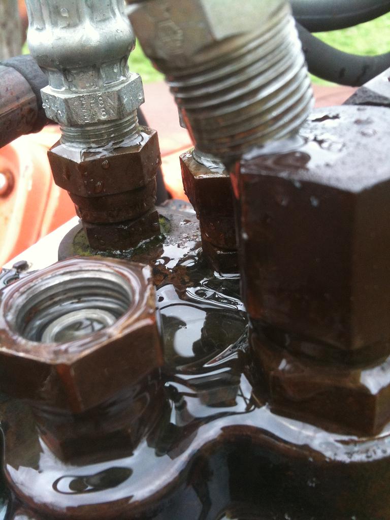

Me again,
In researching my little Kubota problem I've seen valves with both SAE and ORB (O-ring Boss) fittings.
I removed one work hose from my valve. The fitting has a bevel on the inside and it appears to have an O-ring in the base of the valve. The hose is marked 3/8 for it's ID. The OD of the thread is 5/8".
Is my little Kubota set up with ORB or SAE fittings?
Also is there any interchangabliity between the two types?
Thx.

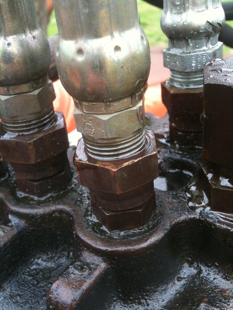

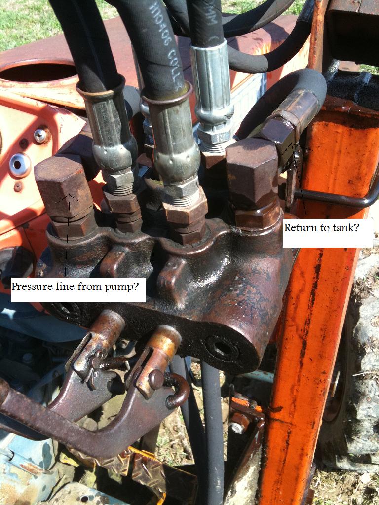

See pics. (Ain't this new-fangled tech neat?)
The right side pic shows the entire valve.
The left pic shows a hose end and the swivel adapter thats screwed into the valve base casting.
The middle pic shows the threads on the end of the hose and the O-ring at the bottom of the swivel adapter. I am not able to remove the adapter from the casting, need a new thinner wrench to remove it.
I am trying to determine the ports I have on the casting so I know what kind of replacement control valve to buy.

Billmiller 54,
Your hose ends appear to be 3/8 NPT & they should NOT have an O-ring in them. The hose end should have an internal angle of 30 degrees and the swivel fitting has the 30 degree cone. If the hose ends are not tapered on the inside they will not seal well on those swivel fittings. Might be why there is O-rings in them.
The mating connector that screws into the valve body might be SAE ORB (Society of Automotive Engineers O-ring Boss).
#6 SAE is 9/16-18 thread
#8 SAE is 3/4 - 16 thread
It may also be ISO 6149 which is the metric version of SAE ORB style. They look very similar to american SAE ports.
/ Difference between ORB and SAE #8
Oldnslo nailed it. That is pipe thread and there should not be an o-ring in there.
/ Difference between ORB and SAE #9
Agree, hose threads look like tapered pipe threads. Are you original owner? Wondering if the O-Ring was factory, but doubt it is.
I needed a thin wrench for a quick coupler. Bought a set at Harbor Freight just for this use.
/ Difference between ORB and SAE #10
I agree. Both are pipe thread, and the o-ring shouldn't be in there. The cone in the male fitting is supposed to create a seal inside the hose end.

You guys probably don't need my input but the way I read this is the OP'r needs to change his valve and can't get the swivel adapters off (6fpx-6mb) to identify to replace it
On stuck ones, best to slice off the swivel nut then use a box-end wrench or socket to grab the remaining hex.....
More than likely it's a #6 male boss (SAE/ORB) on the control valve but best to remove and measure....
Adapter fittings are cheap, maybe best to just buy a valve you want and put on new adapters.....:thumbsup:
/ Difference between ORB and SAE #12
You are right OP wants to know what ports are in his valve, per post #3. So he needs to get the adapters off and see what he has. The swivel with an O-ring in it and NPT hose threads got me off track :eek: thanks for pointing this out.

"SAE" really refers to the organization that controls hundreds of different SAE specifications, but in hydraulics, it's most often used to refer to ports and fittings using SAE Straight Thread O-Ring (aka O-Ring Boss or "ORB"). In that regard, the "difference" between SAE and ORB is absolutely none. They are two different names for the same connection.
There is no way to identify the ports on the casting without first removing the swivel adapters. it could very well be and SAE/ORB port, but if your equipment is foreign-made, it could also be metric or BSP (British Standard Pipe). Once you remove the swivel adapter, you can identify and measure the threads to be sure.
The tables here will help you identify all of the popular hydraulic ports and connections.
