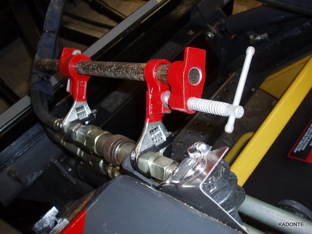

Here is a picture that I put in my "projects folder".
QC tool to push them together, don't know who made it:

Xfam, that seems like an incredibly hinky setup. I mean at that point why not just screw and unscrew and bypass quick connects at all?
