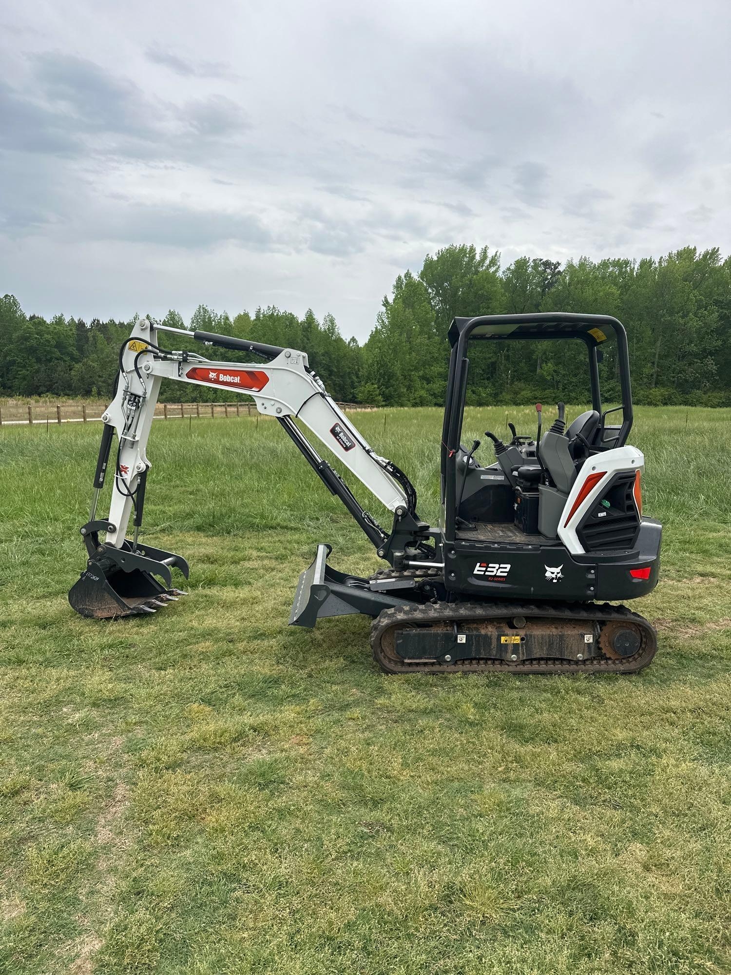

So I rented an excavator (bobcat E35) with a one foot trenching bucket and started digging. It was a little sketchy since I had to dig directly adjacent to our primary underground electrical service, but thankfully that trench was 6+ feet deep. I had to go ~700 feet from my neighbors backyard pole, behind his pole barn, through his garden, down a steep 35 foot hill, around some big trees, and to behind my house where they put the pedestal. From the pedestal to the house they just pushed a small coax line into the dirt, I've had to repair that part also after my front loader snagged it (why do I keep digging and landscaping this area? my wife would sure like to know).
