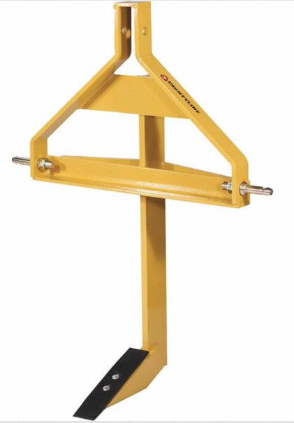

I suggest using HDPE black plastic flexible water tubing rather than rigid PVC. If it breaks you can hook one end to your tractor and the other to new tubing and pull it 75' underground digging only one hole on each end.
And the reason to bury deeper than 12" is to not break the water line when it is run over with the tractor. Or truck. Or whatever.
That's using your head for something other than holding ears apart. I built a single shank root plow and while I was at it I made provisions to bury pipe. Old window weight on 12" of 7/16" chain,open hook welded to heel of plow. Drop end link of chain over hook,drop plow in hand dug hole,tie pipe to window weight and ease away until plow reaches secound hole and raise plow pulling a couple feet of pipe out to daylight. I generally make a couple passes with plow to loosen clay soil before pulling pipe. To connect pipe I use a dutch finger type plug then drive screws through pipe in front of steel washer. Mark pipe at 10-20 ft intervals so you will know exactly where end of pipe is if it come's loose from plow. Unless tractor labors to pull it or someone is watching pipe disappear you don't know when it come's loose. Don't even ask how know that. On long stretches I pull till it break's loose,dig end up,expose an extra foot,start a new pull then come back and splice pipe.
