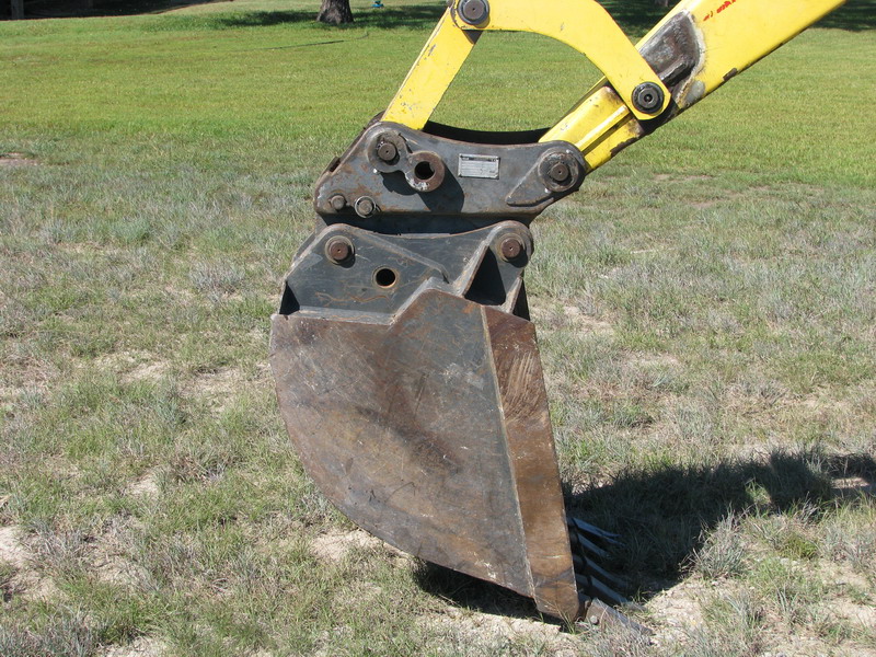

Eddie, I might have an inexpensive solution for you. There's a rental yard in Decatur that has two dippers off a LB75 and LB95. He says they are both the same. They both have very minor dents and he got them replaced with insurance. The LB95 dipper looks new. He's asking $450 each, but I was thinking of offering him $750 for both. I didn't do it yet because I had no place to store them until I get my shop built. I have no idea if they will fit your tractor, but I've put a couple of photos of my LB75B's dipper below. If you look at the close-up, you can see where mine has been welded once. I wanted one of the dippers for a backup, but if you want one, I'd split whatever the guy wants for the pair with you. You just need to know if it will fit your tractor. From the photos, your dipper sure looks similar to mine.

Eddie, I like Jim's idea if they are a close enough fit. 2nd, around here, there are plenty of welders who have their own truck rigs. Now that its cooler, working out in the open is not a big problem. I don't think its really that big a deal. If you have some scraps and a torch, you might can help the welder cut and fit some side plates and a bottom plate to shore up the crack welds.
Could save a bunch of time and extra work to fix it in place.

Quite a few years ago, my father owned a business, Buckets and Booms, Inc., that specialized in building and repairing large buckets, crane booms, etc. That would have been an easy fix. They would have removed the bucket, cut the remaining metal, and pulled the dipper stick. It could be fixed in the field but the realignment would be easy on a concrete floor. Weld it up, fish plate it, paint it and re-install.
If I remember correctly, Eddie has another piece of equipment he could use to lift the dipperstick. The removal and re-install is a pretty straightforward do-it-yourself project.
Any competent welder can weld the pieces back together and reinforce the area. If he's not familiar with equipment booms, it might be wise to help him with the shape of the reinforcing plates so the welds don't go straight across the stick. Copy the shape of the existing plate.
