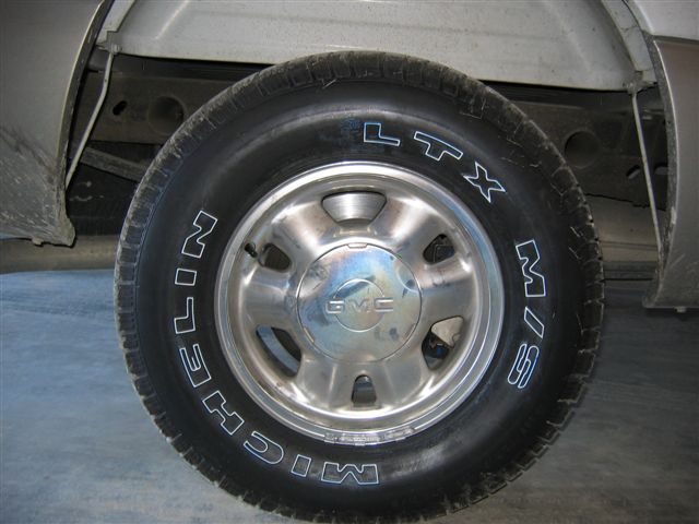

Ron - yes the wheels are aluminum, but the old tires drove and rode fine and did not vibrate. And, I can't see any damage that might have been done during installation.
Attached is a picture of the right rear tire, the one with excessive weights.
   / Disappointed with new truck tires
#17
Well, I'll try again with the picture.

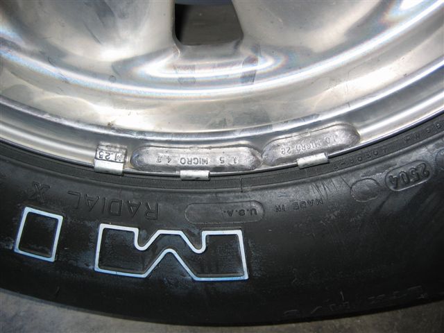

Here is a closeup of the weights.
#19
Tire pressure recommmendations per the driver's side door: Fronts 30 lbs, Rear 35 lbs. I checked the pressures - LF 35, RF 36, LR 35, RR 33. I adjusted the fronts to 30 and the rears to 35. We'll see what this does when I can get on the highway. Funny, the fronts look a little low to me, with only 30 lbs in them.
   / Disappointed with new truck tires #20
Total of the weights is 2.75 OZ which should be OK. When you get past 3 OZs the tire may have a problem.
If you are getting vibration then they did not balance them correctly.
If the problem is something other than vibration the weights have nothing to do with it.
