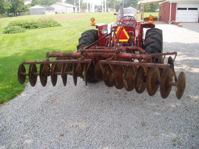

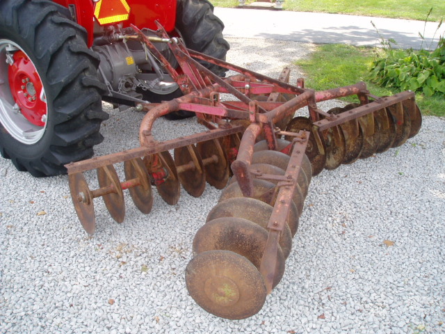

A GOOD 3-point disc will get the job done. Just far too many "not so good" versions on the market for my liking. That one of yours looks to be stout enough to handle being used hard, even having extra weight hung on the frame. It helps that you're in flat country too. A disc just works better on flat ground.
Here's my 3-pointer. (Massey Ferguson #25. 9'er.) I spent a LONG day dragging it around this past wed. Very pleased with the results.

Looks like a good old disc, but what impressed me in the photos was that pretty 150 it was hanging on:D. The paint on the spin out rails ain't even scratched:D :D Do you have a full set of pic's posted anywhere?
Yes 150's are great pieces. About the only place a 135 could edge it out was turning radius due the the 150's straight front axle. The extra weight and creature comforts were a big improvement.
Next time out at the farm I'll take a shot of my old 3pt King disc. She was a brute in her day, with worm geared gang adjustments front and rear and boxed beam frames.
