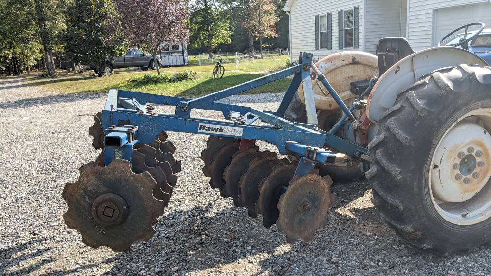

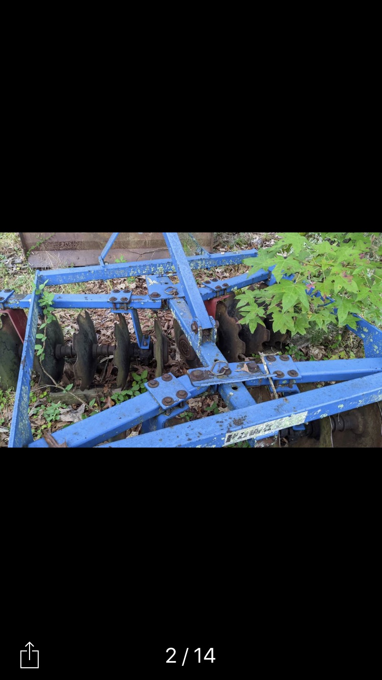

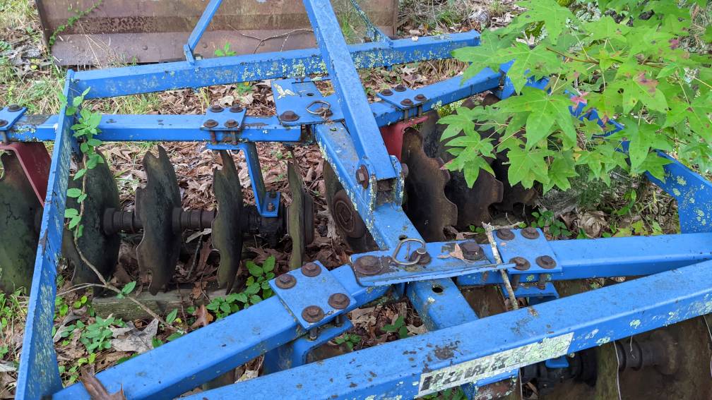

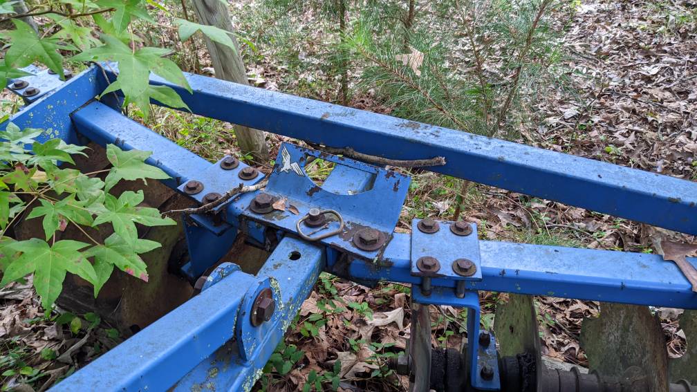

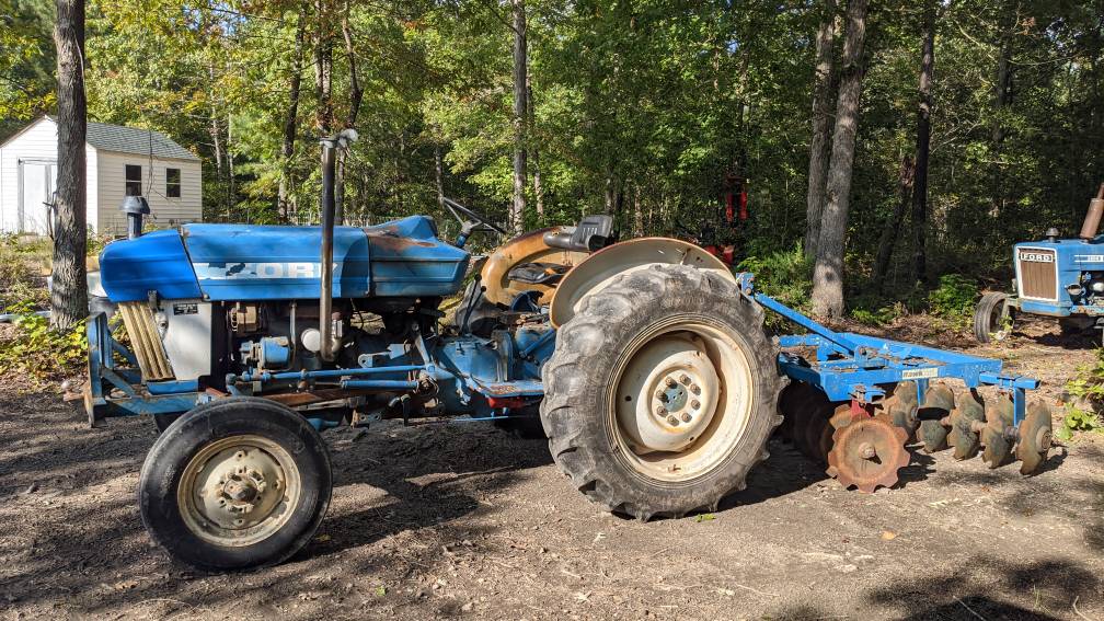

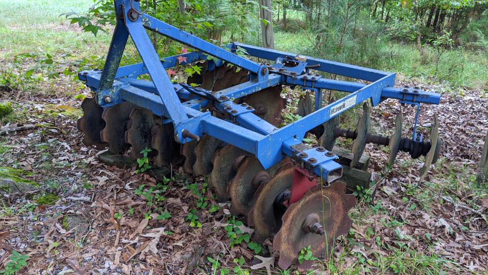

Need a disc for planting small experimental food plots for my sheep and deer. Neighbor wants $300 for this. Looks to be in good shape. I think it's a 7'. I know weight is the key to a nice disc, hence the segmented wheels because it's light. Was just thinking it would still be handy for breaking up a couple few inches of the ground. Thanks in advance for any opinions/advice! PXL_20200928_121040049.jpegPXL_20200928_121058063.jpegPXL_20200928_121138798.jpegPXL_20200928_121104026.jpeg
/ Disc Opinions #2
It's adjustable and from the looks of the disc blades it has been used very little , in this part of the country it would be considered a great deal , you may have to make several passes in unbroken ground but it will do what you want. I have a Bush Hog brand that is almost a twin to that and I have done everything with it from making beds to plant watermelons on to small deer plots, and while I have larger disc's offset and leveling, I would never get rid of my little harrow.
/ Disc Opinions #3
In my part of the country, that's a steal. I paid $450 for a Ford 202 disk and the guy who sold it to me had other people beating down his door to buy it out from underneath me while I drove my trailer back to pick it up. That disk should more than do the job.
/ Disc Opinions #4
I would jump on that. Nice that it is 3ph and you can easily position the thing.
/ Disc Opinions #5
I paid much more for a similar disc. Yours looks almost new. Depending on soil type and condition, you may need to add some weight to help with penetration. I use two poly 55 gallon drums with various amounts of water added to provide needed weight to penetrate my Alabama red clay soil. A poly 55 gallon drum filled with water weighs about 460 lbs. Two barrels (one per side to balance) partially filled will give you a nice bite. A couple of welded brackets will provide a cradle for the barrels. Speed will also determine tilling effectiveness. Good lick.

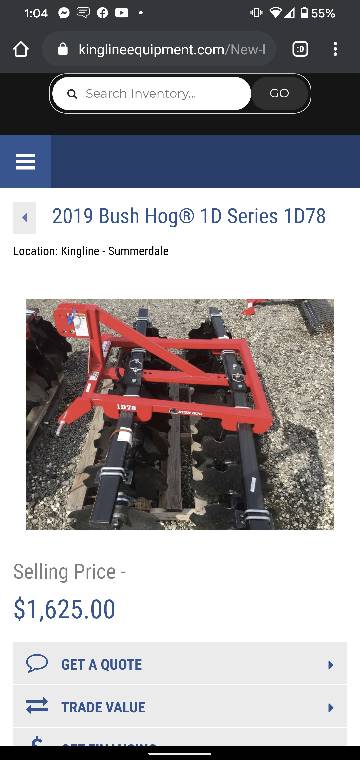

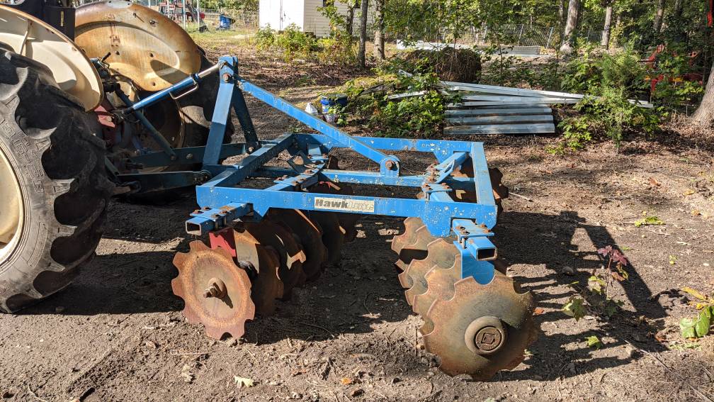

Thanks for the replies everyone! Definitely very similar to the Bushhog brand. Love the blue color since it matches my tractor. Lol! I'll try and post up a good video of me using it once I get the bearings greased up. Everything seems to spin nicely though.PXL_20200928_200339397.jpegPXL_20200928_200345960.jpegPXL_20200928_200355495.jpegPXL_20200928_194903630.jpegScreenshot_20200928-130417.jpeg

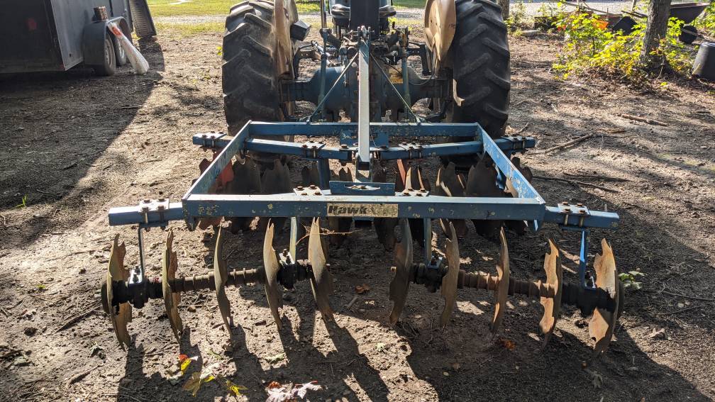

Not sure if any holes are hidden under the plates or not, but cased upon what can be seen, both the front and rear are set to a center position. You have at least 1 more and 1 less aggressive setting on both gangs.
There are many ways to increase weight of the disk, all depending upon how much you wish to add and your fab skills. Some have been suggested.
Discing from different directions (90 and 45 degrees) will help to break up soil also.

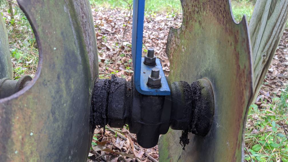

Thanks for the info! What grease do you recommend for the bearings?
/ Disc Opinions #13
As for grease, the best is the grease you will actually use. Meaning you can buy a high quality grease but if you do not use it, it does little good in fact it does less good than a cheap grease that is used each time the disc is used.
All that said, buy a good quality grease, never the cheapest and use it before discing.

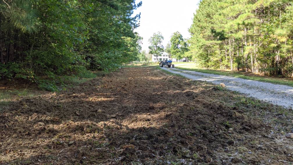

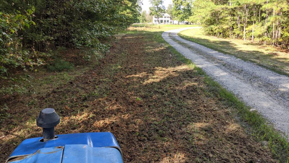

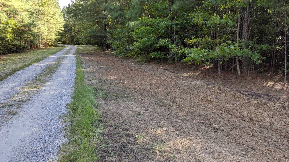

Not too shabby before I changed the angle to the most aggressive holes. Then it was awesome. Definitely could have played with the top link some. I really need to get a hydraulic top and side link.
Ford 3910 Hawk 6' Disc First Pass - YouTube
Ford 3910 Hawk 6' Disc - YouTube
Ford 3910 Hawk 6' Disc Max Angle - YouTubeView attachment 671721View attachment 671722View attachment 671723
Don't know how many passes you had to make, but you have that ground plenty good enough to plant a food plot.

Not too many. I think it's perfect for what I'm trying to do. My hay guy has is going to sell this cultipacker to me for real cheap once he's done with it. I should have everything I need then.
