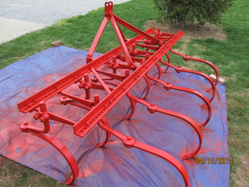

Forget the plow and harrow and all that stuff. It's too much setup work and they will just get in the way 99% of the time and rust in the rain. I would go with a simple Dearborn/Pittsburgh cultivator (or similar) like this one that I rebuilt and now use as I am telling you to use.
Here it is
http://www.tractorbynet.com/forums/attachments/312434-1950s-dearborn-cultivator-find-rebuild.html
And here's my rebuild thread above.
I'm as much as a plow and tillage guy as the next but multiple passes with this will do a better job and you don't need 30 acres to learn the drill. There's no dead furrow to contend with and no trying to smooth clumps of dirt and debris. Each pass makes things smoother. It will pull up some rocks but pick them up and call it good. These are the perfect garden implement and there are zillions of them around. Use it with 1 3/4" or 2" straight points and not shovels. Piece of cake and it's way more fun to use.

So with this, a cultivator is all I probably need?
Is this close to being a "chisel plow" which I see some of around me?
What width should I be watching for?
Thanks.
Thanks.
Well, it's all I would need based on decades of figuring this out. These cultivators are from the 1940's to 1950's and there were untold zillions of them made to go with the 8n's and similar sized tractors revolutionizing agriculture and the family farm. This is the type of implement that took the family farm from the hand hoe to mechanized thinking. It did a remarkable job of that and that is about the level many are at when first planting a large garden or an acre of something. Almost all of these are 7' 6" and sell for several hundred $$ at auction. The spring shank ones, like I have, work best and they originally came with 11 shanks, so get them all.
I've bought, sold and used a number of plows, harrows and such over the years but keep coming back to the way that has worked best and been the most efficient. The simple cultivator. To start with more complex ideas like a plow or this or that right now would take hours of education and experience plus much second guessing and fact-checking while you learn. Save that for winter and the time for the family.
The harrow shown, yes, is close to being a mini chisel plow (if you put chisel-like points on it) after you make multiple passes but will leave the ground smoother with successive passes. It will also pull up rocks that you will need to pick up but will make that task easier and will be more gratifying to use. In the end, you'll have to use what you think you should and I'm just offering my experience and what I have learned.
You will be able to satisfactorily pull this with your tractor if you take it easy at first.
EDIT--Any other simple cultivator would work as well.
