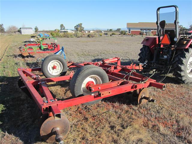

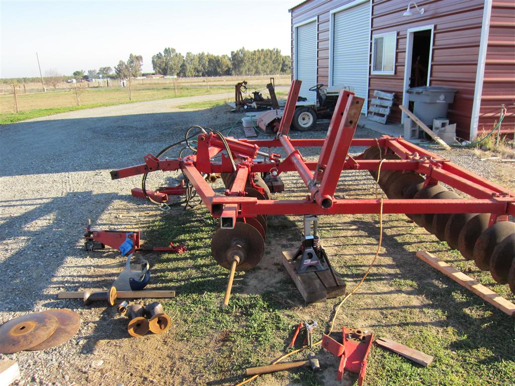

I bought an old 14 ft wheel disc for $600. Made by Krause. Cut the axles down to make a 9-ft wide disc that I pulled with my Mahindra 5525 (55 hp engine). Worked like a charm in my soil.
Good luck

Good job Flusher. You ended up with a very heavy duty disc for it's size. And you created a size that worked best for you. :)

If I recall you're out of farming now, so it's probably not an option, but maybe someone else reading this can try it. In that situation, you could buy the 14' disc for $600, cut it down to 9' for your uses, and weld up the rest as a 4-5' disc for someone with an ATV for SCUT. Probably sell it to them for $600 on a good day.:D
