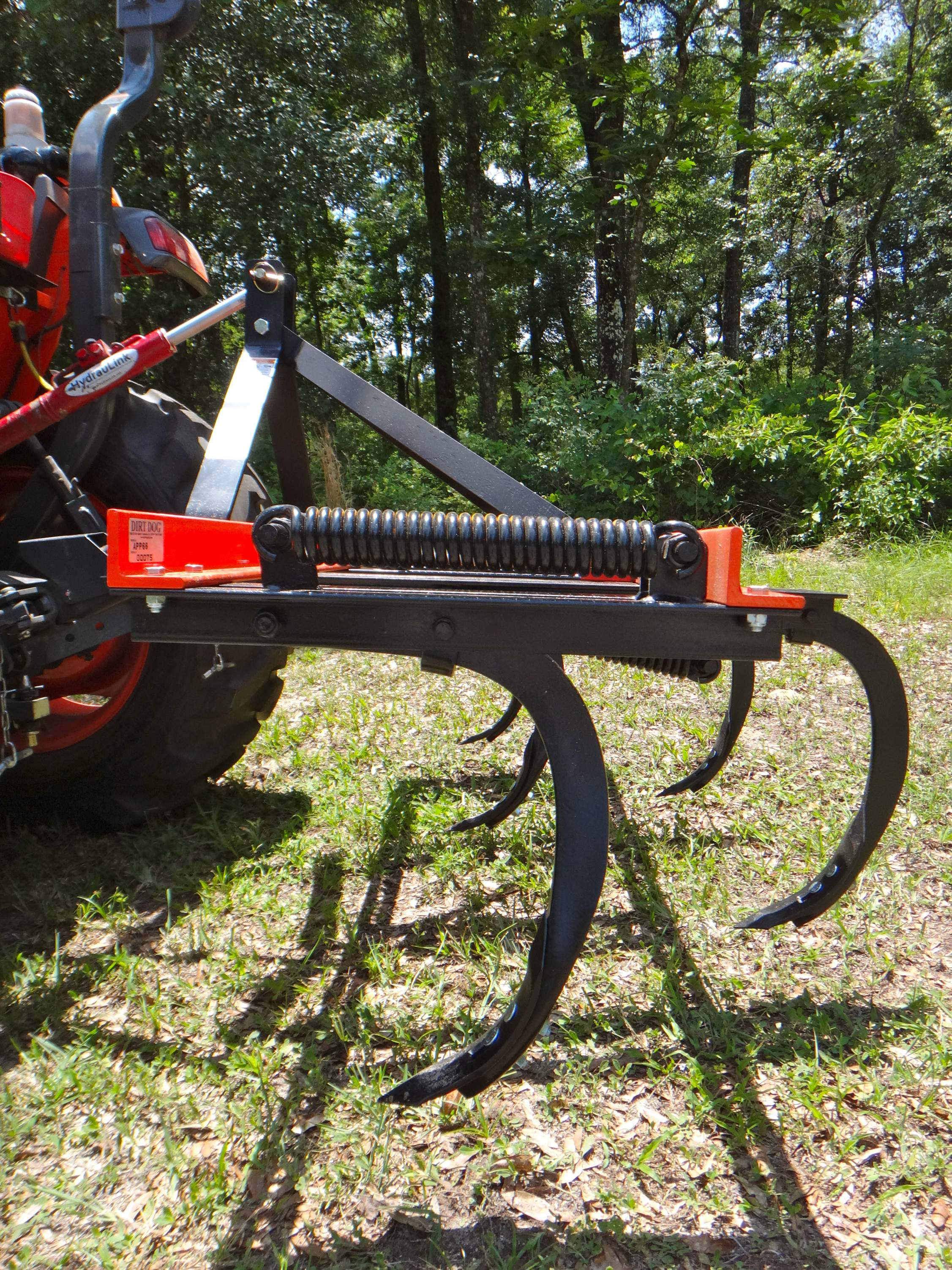

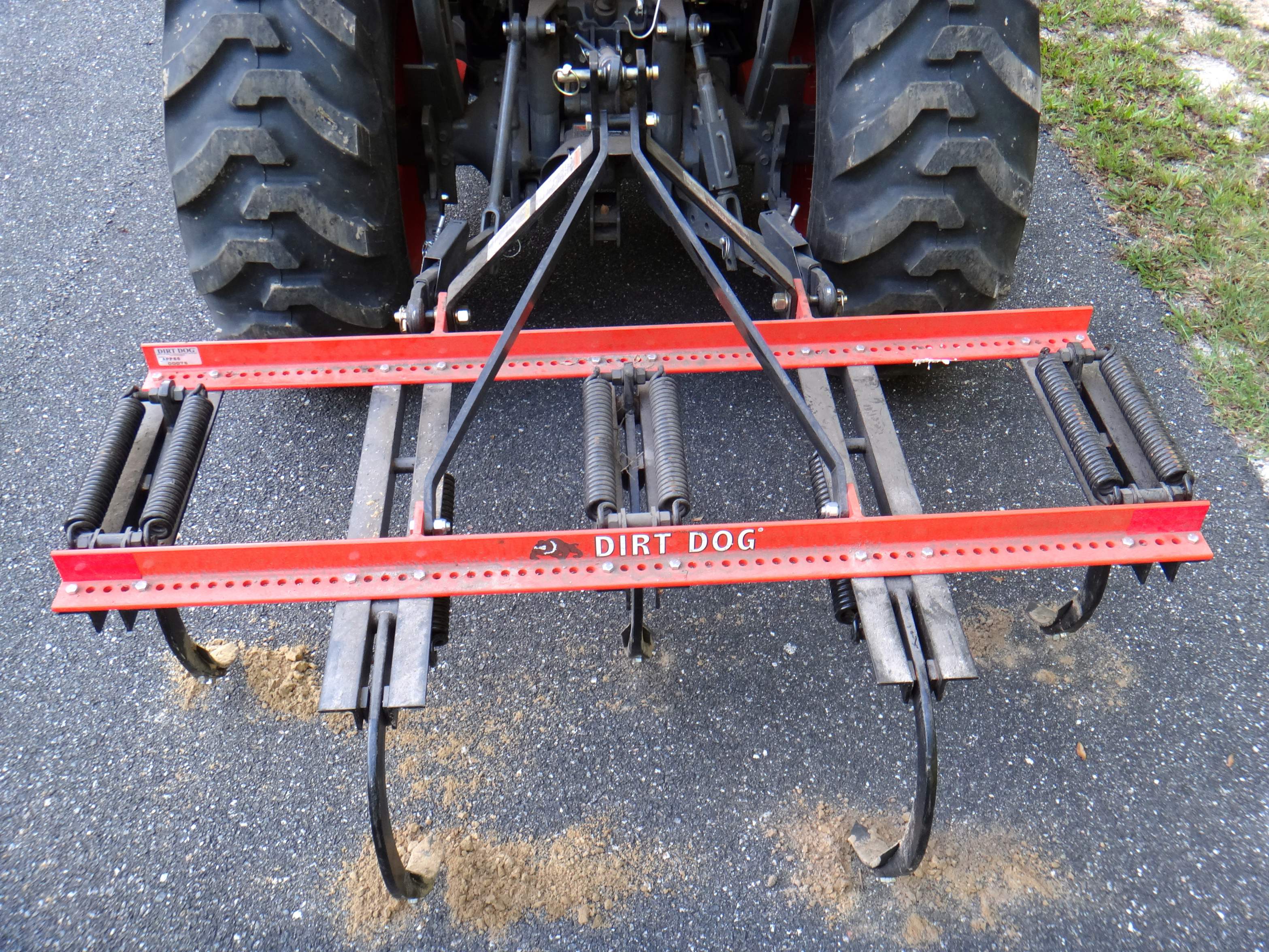

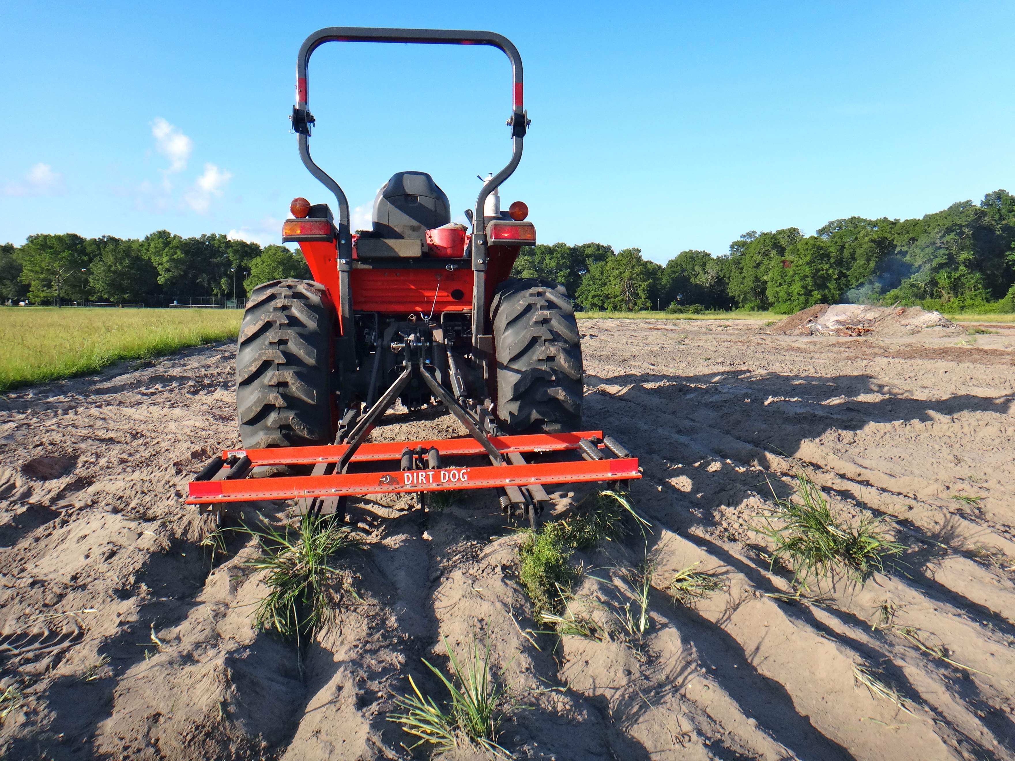

The lightest Disc Harrow which is moderately effective has 18" diameter pans. The lightest Disc Harrow which is effective has 20" diameter pans. To pull a Disc Harrow with 20" pans at a brisk pace requires a 3,500 pound (bare tractor) tractor and 4-WD. Both 18" and 20" Disc Harrows are really SECONDARY TILLAGE implements.
Beginning at 22" pans, better 24" pans, Disc Harrows can serve as PRIMARY TILLAGE implements in soft soil.
Lighter tractors have to mix soil with PTO powered roto-tillers.
Both Disc Harrows and roto-tillers are soil mixing implements.
If it has been ten years since your ground was last plowed, plowing will raise fresh nutrients to the surface. Roto-tilling will produce almost the same result. Discing, less.
There are "rules" for PTO powered implements. For ground contact implements it is tractor weight.
Consider a Field Cultivator, which is excellent for regular pasture aeration after you break up existing irregularities.
VIDEO: field cultivator small tractor - YouTube
LINK TO IOWA FARM EQUIPMENT: Chisel Plows
