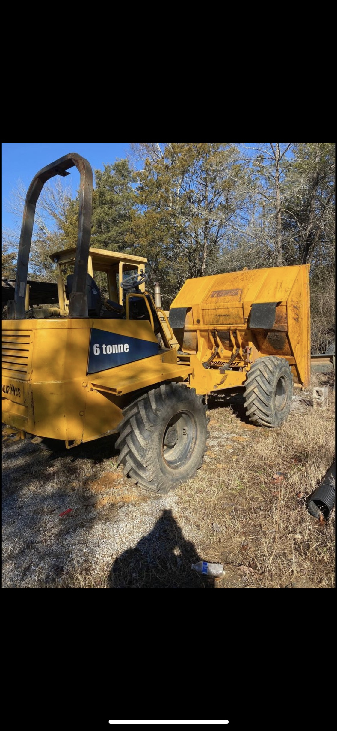

I saw this little off-road dumper on market place for 9 grand. It would be perfect for what you need

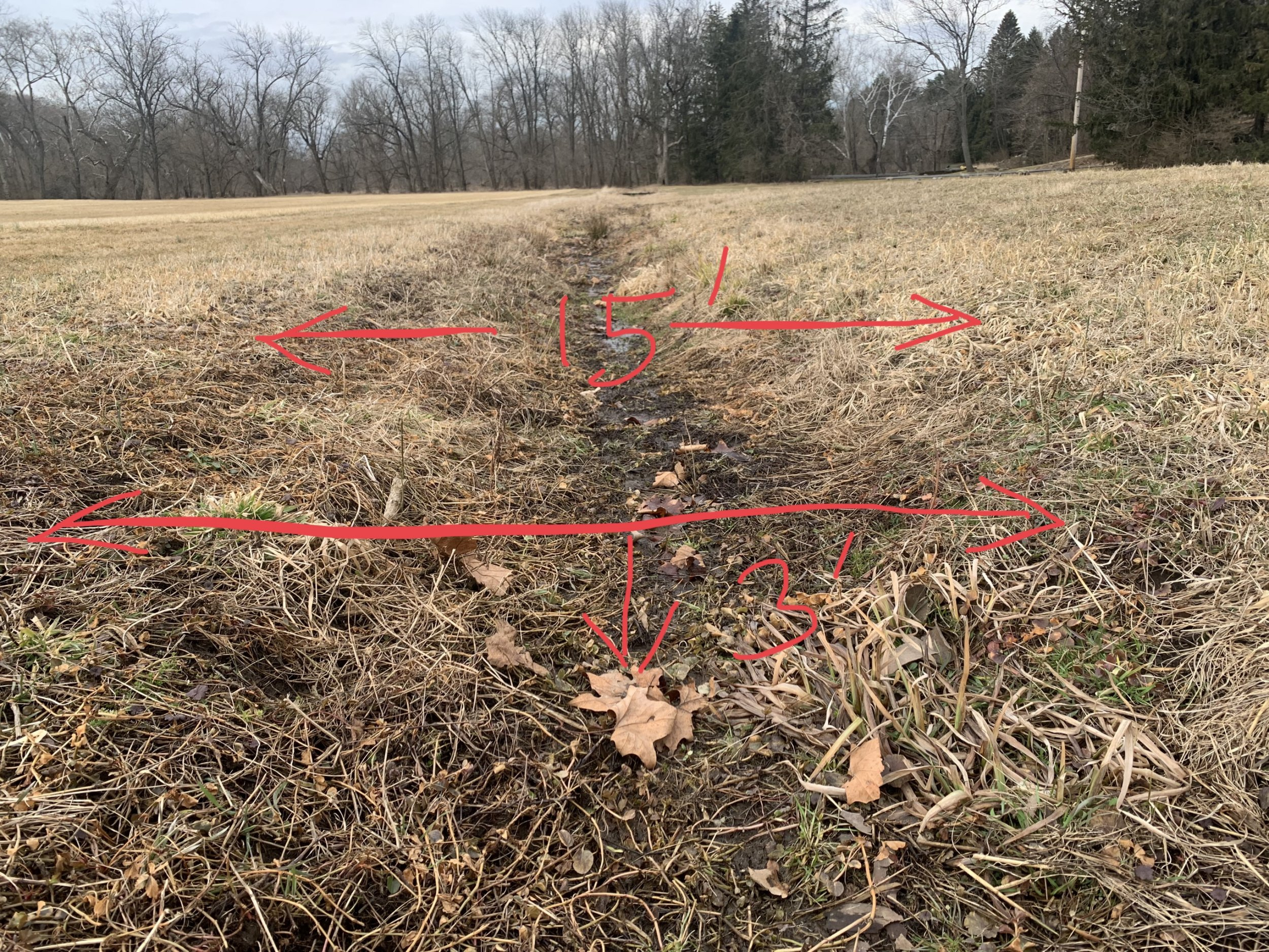

So just to reel this thread back in a little, here’s some of the ditch pictures. Like I said, they are only about 15’ wide.
The mile estimate is both sides. So 1/2 mile of ditch, but having to work from both sides is about a mile.
I figured small machine would run along one side, tracks parallel to ditch and scoop turned 90* to tracks, and spoon feed spoil into farm tractor right behind me. I could also do piles of spoil every so many feet (according to mini ex reach) and clean them up later, too.
Heres a portion on the ditch. Max width is 15’. Max depth about 3’
Average width is more like 12’ .
Loader bucket is pretty big. Kubota 96” high capacity bucket. Should be able to hold 4-5 scoops?
I think what will slow the job down is the wait for the tractor to drive to spoil pile and back.
Maybe its time to think about a dump trailer? Ground is kinda soft for that, tho.

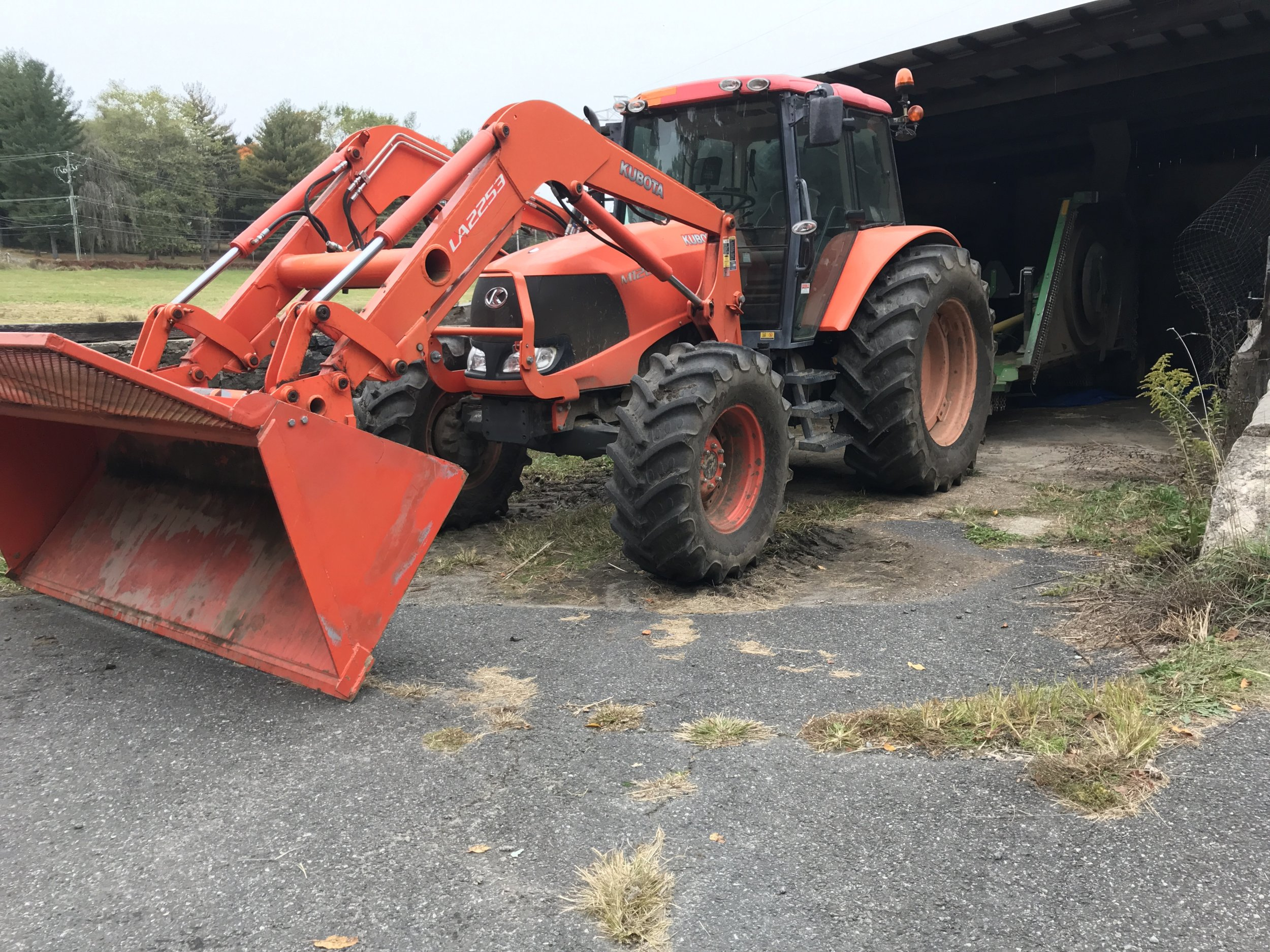

The property owners is going to have us build an earthen berm behind their stone grist mill to help redirect future flood waters. My plan is to use tractor with high cap loader bucket to shuttle dirt about 1/2 mile to earthen berm
I would consider renting a dump truck to do the half mile run. Contact a local dump truck/gravel company and see how much to rent a solo truck and driver by the hour. It would save a lot of wear and tear on your machine. When I retired, I think a solo was $125 and a truck and pup was $150 but you could load the crap out of them with no scales or road travel to worry about.
