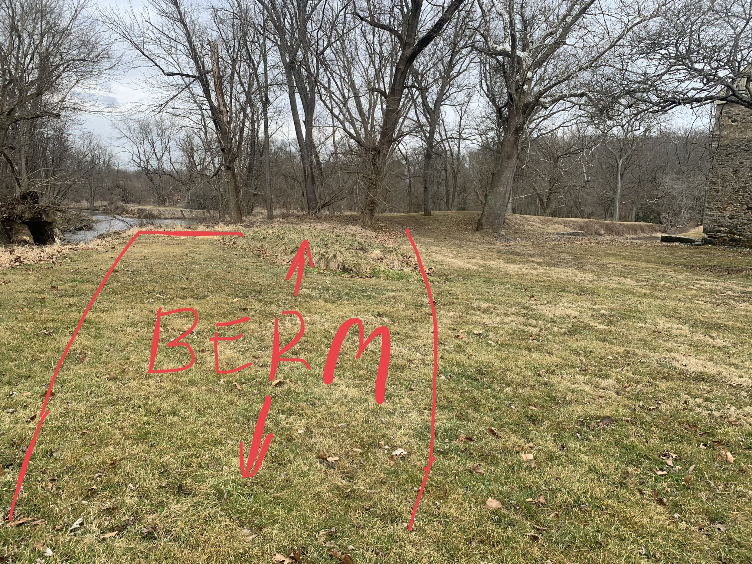

My two cents. I'd rent something similar to a hitachi 250 (could go bigger but of course more cost)~ $3500 a week, pull everything from one side with the additional reach; a Volvo 25 to haul the spoils ~ $5000 a week. Probably about 12-16 buckets per load depending on material. Maybe 400 gallons of fuel total @ $5.00 is $2000. Production should be at least 1500lf of ditch per day. Dump tight piles where the berm goes. It looks to average 4-6 ft in height. If it's dry enough, shape the berm with the excavator on day 5. If not shape it to drain and return with a small lgp dozer when it does dry.

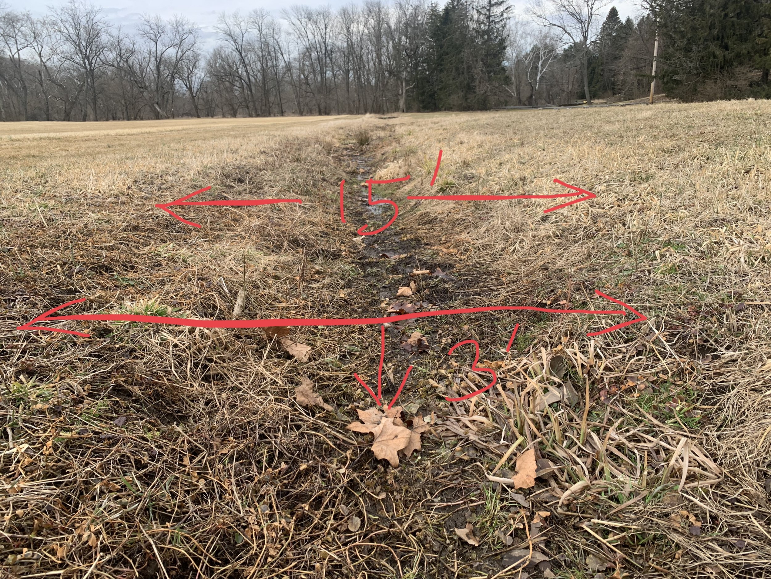

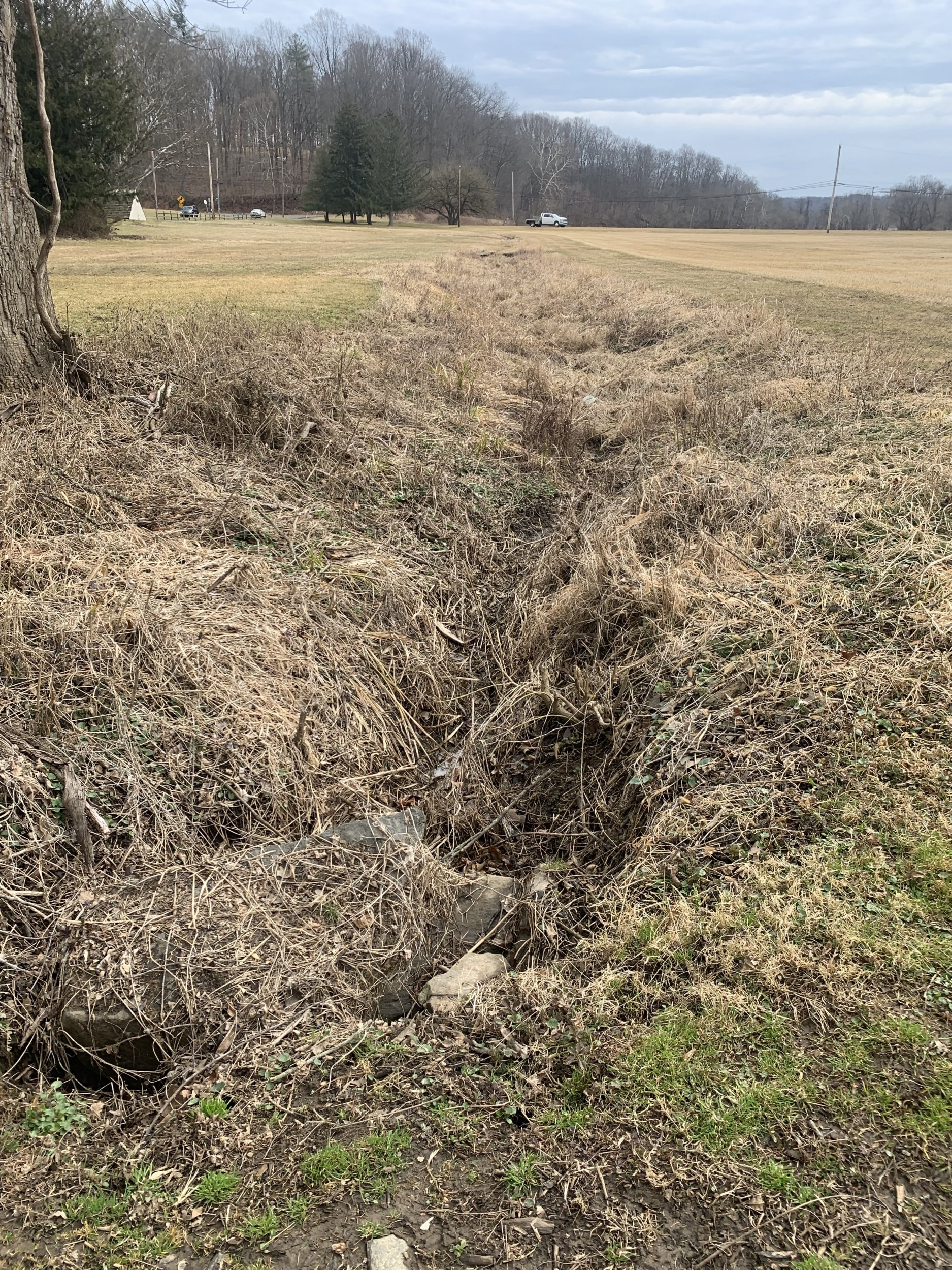

Take a look again at these ditches. They’re far too small and the property much too soft to handle large machines.
The property is historic and cant be trampled on with big gear.
In this case, smaller and easy going is better.

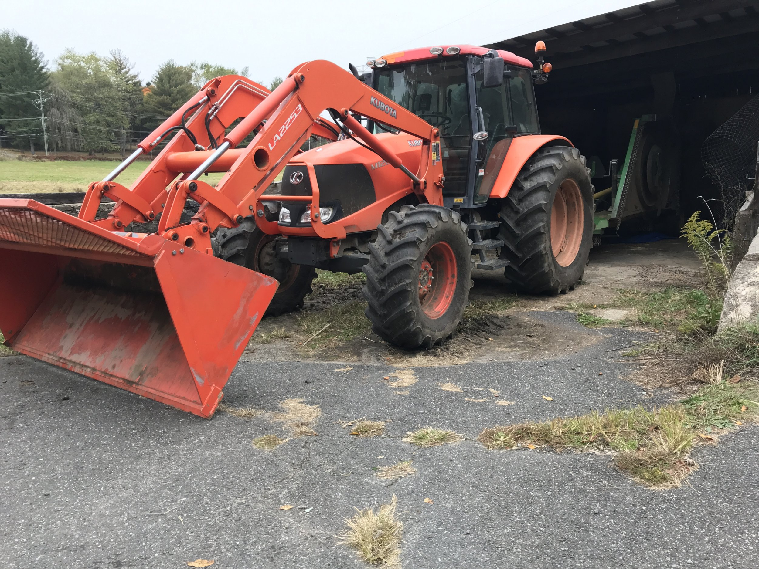

It would be nice to pick up a real heavy duty dump trailer and pull it behind my tractor for this job, then use it for over the road use as it was originally intended.
My 16k dump trailer will get you stuck in a hurry with the narrow 17.5 wheels. A dump truck would probably preform better than it does. If you outfitted the trailer with a more off road tire and bypassed the electric pump to use your tractor remotes it wouldn’t be bad. But I’d hate to see the price a wheel conversion and good trailers are insane too.

It seems like a road grader could reshape the ditches because they’re not too deep.
