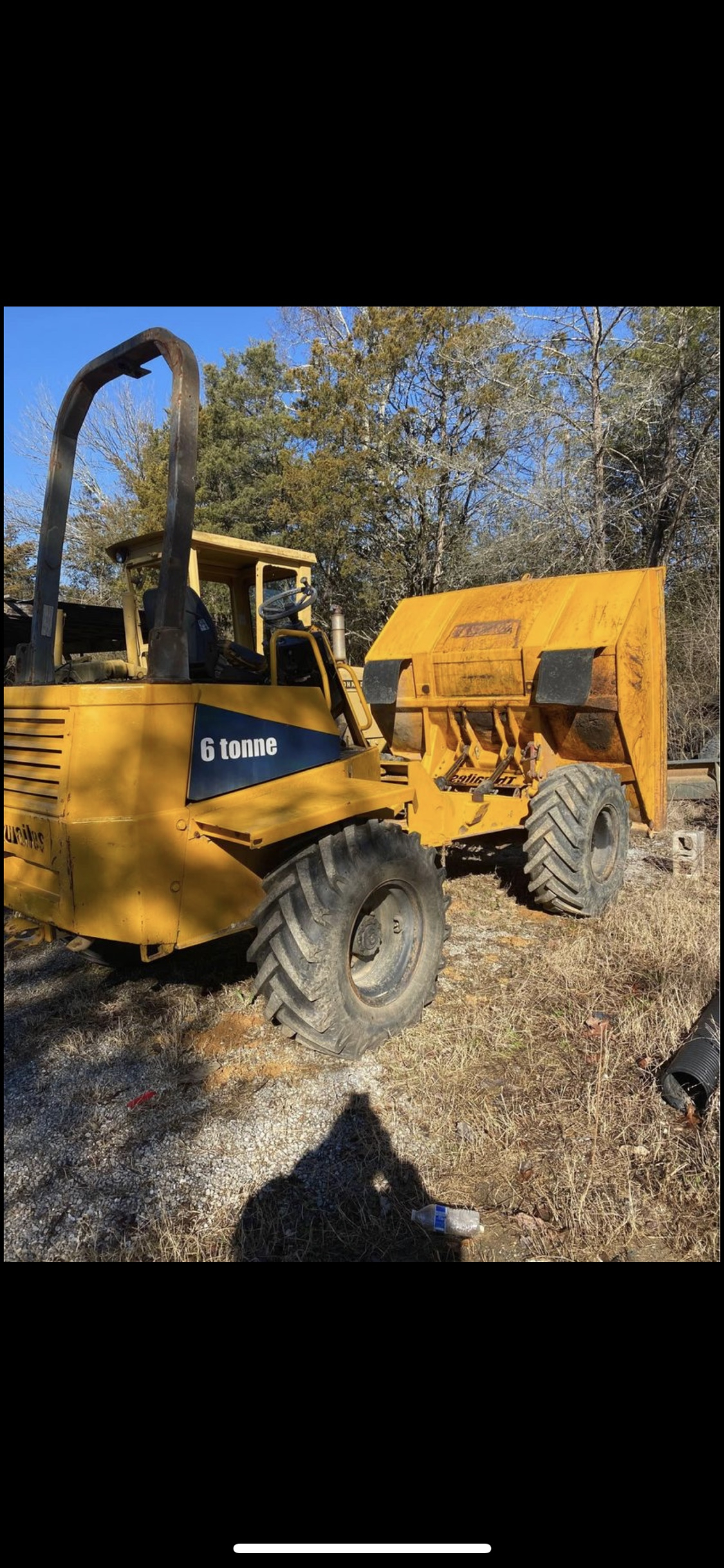

Looks perfect size, low compaction, but slow looking
