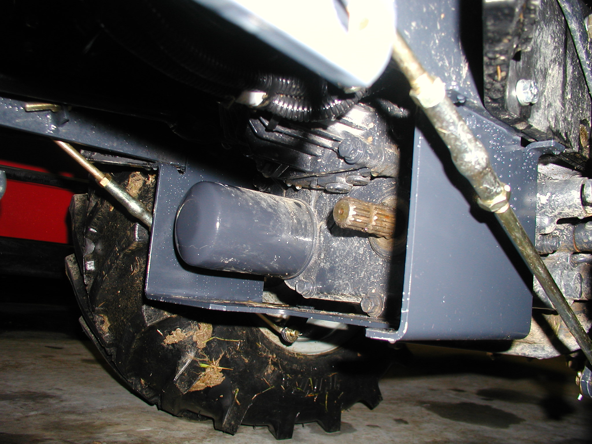

Does your tractor not have a metal shield like in this photo, around the Hydro filter? P1010017.JPG

Mine does not but it would sure add some protection around the filter. Looks like it might add to difficulty in attaching MMM PTO.

Does your tractor not have a metal shield like in this photo, around the Hydro filter? View attachment 469532
Yes it does but not like yours. I took it off before hand to get tomthe hydro filter. Im gonna do a nice write up when im all done with the 50 hr service. Taking a lil while between work :). But ill get it finished.
Sent from my iPhone 2.0 using TractorByNet
I did not know they were making any of these without a filter shield anymore?
It was the second biggest failure point, on early GC's.
After a year and a half, of owners doing serious damage, the shield, which was included on subsequent models, was finally made available to early model owners. At the owners expense, of course.
I suggest anyone who doesn't have a filter shield, order one, and install it, before you inadvertently bust the filter off the rear end housing.
The shield does not have to be removed, to maintain, or attach anything.
