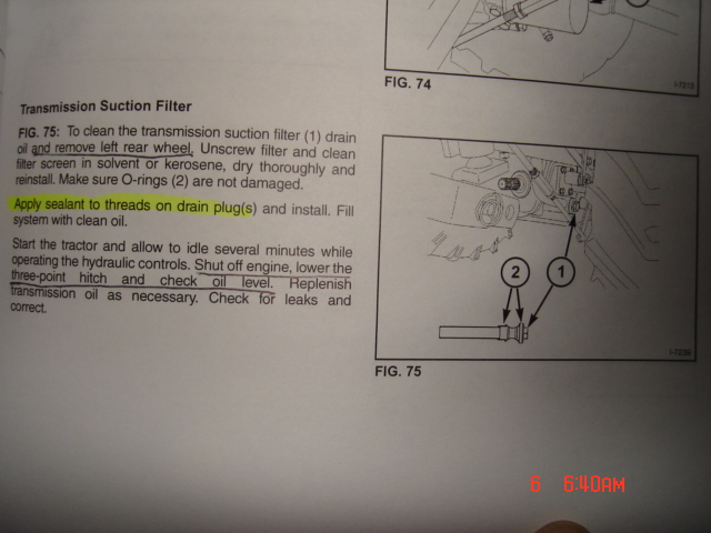

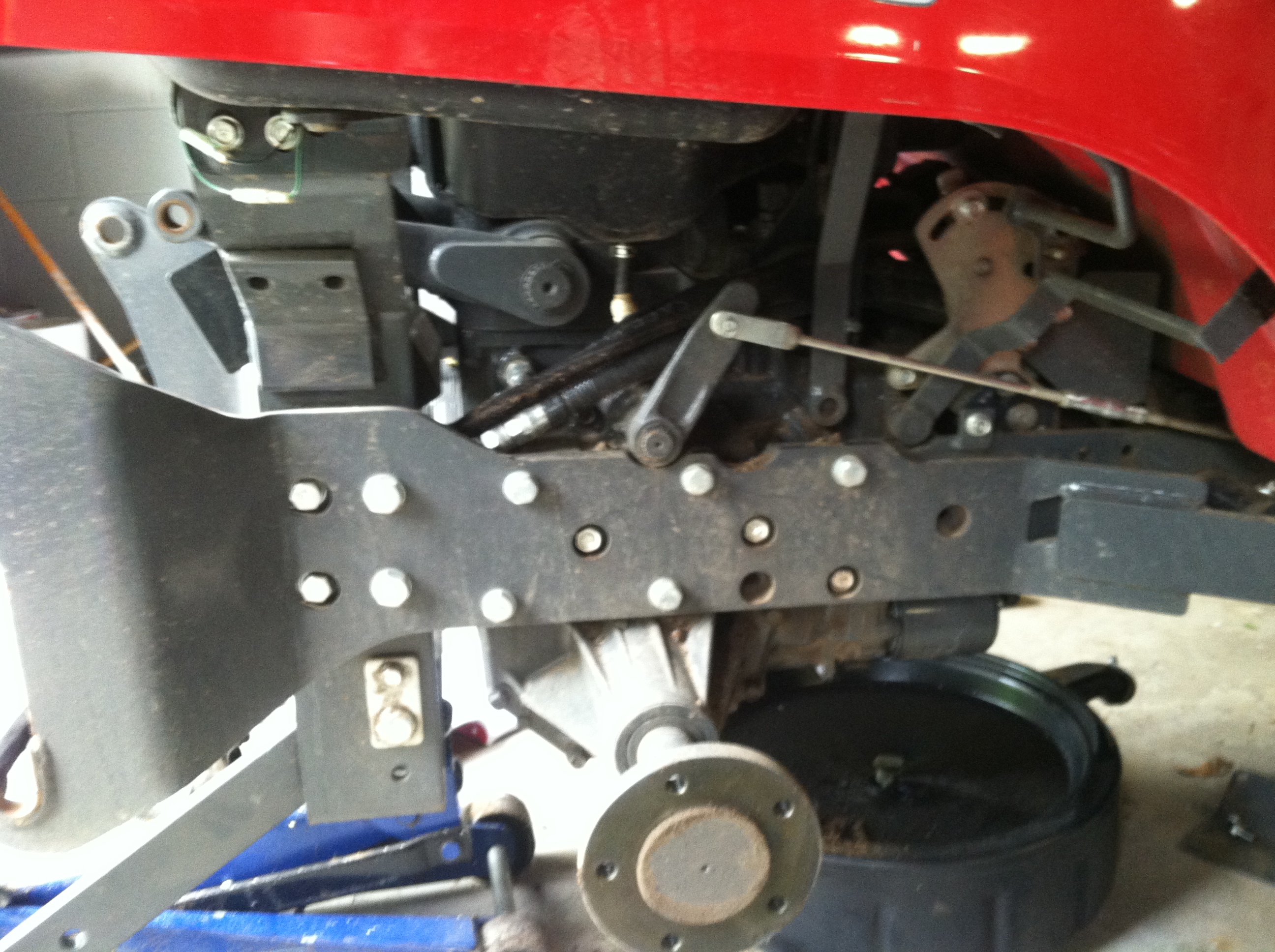

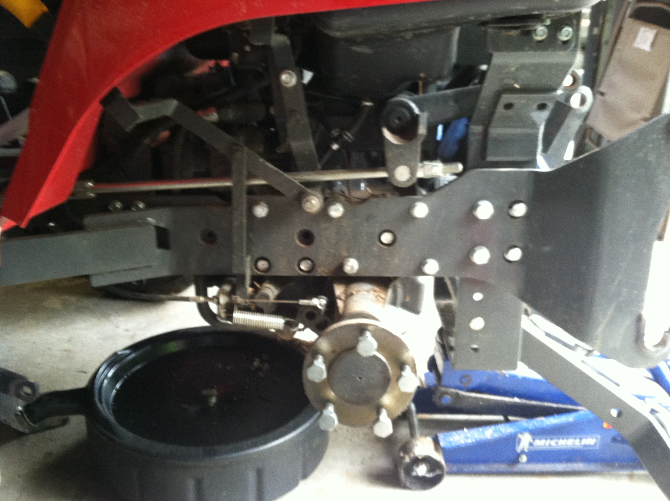

Where the freak is the transmission suction filter. Imtook both wheels off cause the manual says left. So is it on the side where the pto controls are or on the other wide where the transmission hi and low are. I see the diagram in the manual but cant make out witch bolt it is. Anyone have a picture? Im doing the 50 hr now and taking pictures as i move along.
Their no pictures in this thread!

Someone did post a picture, at one point.
I'll look for it for you.
It's a large hex head, like around 1". (Haven't had mine off, in many years).
It faces the inside of the left wheel.
   / DIY 50 hour service questions - GC17xx #58
I assume you saw this?
