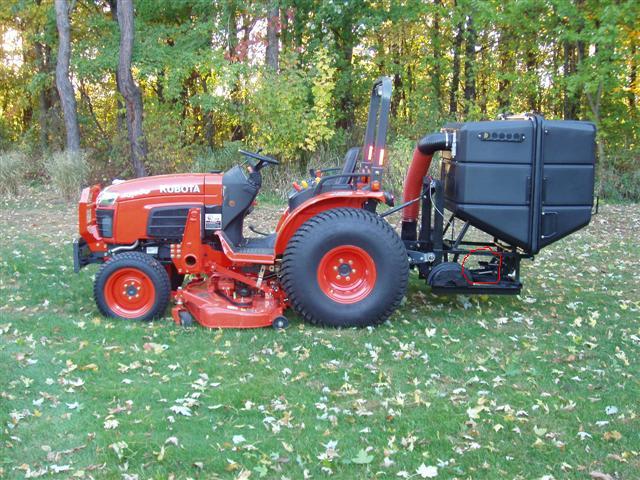

I have a 3 point PTO powered Trac Vac with pull Cart (not original) and it works great. The cart is a pain to dump though. Not enough angle in the full dump position. If I increase the dump angle I think I would have issues with the hose going to the cart. I would like to do away with the cart entirely. I saw a pic of TOOLGUY's setup a few year ago, and it looks like he did a great job. I think he modified his exisiting setup. Here is a pic from an old post.
The idea of some kind of Clamshell container with easy open capabilities seems like it would really work the best for me. I have been trying to find a inexpensive Plastic containter like that for some time, short of paying $500 for something I have not had any sucess.

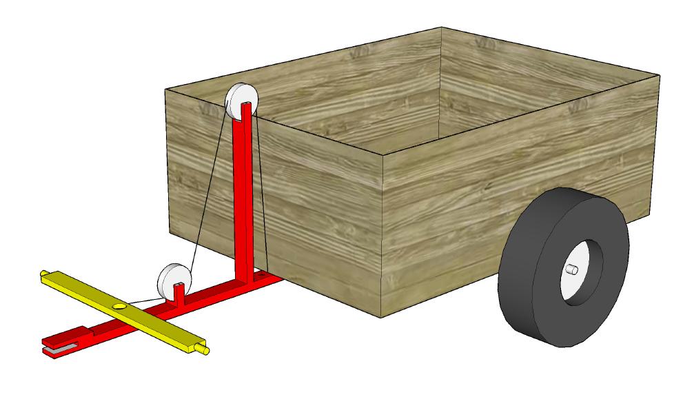

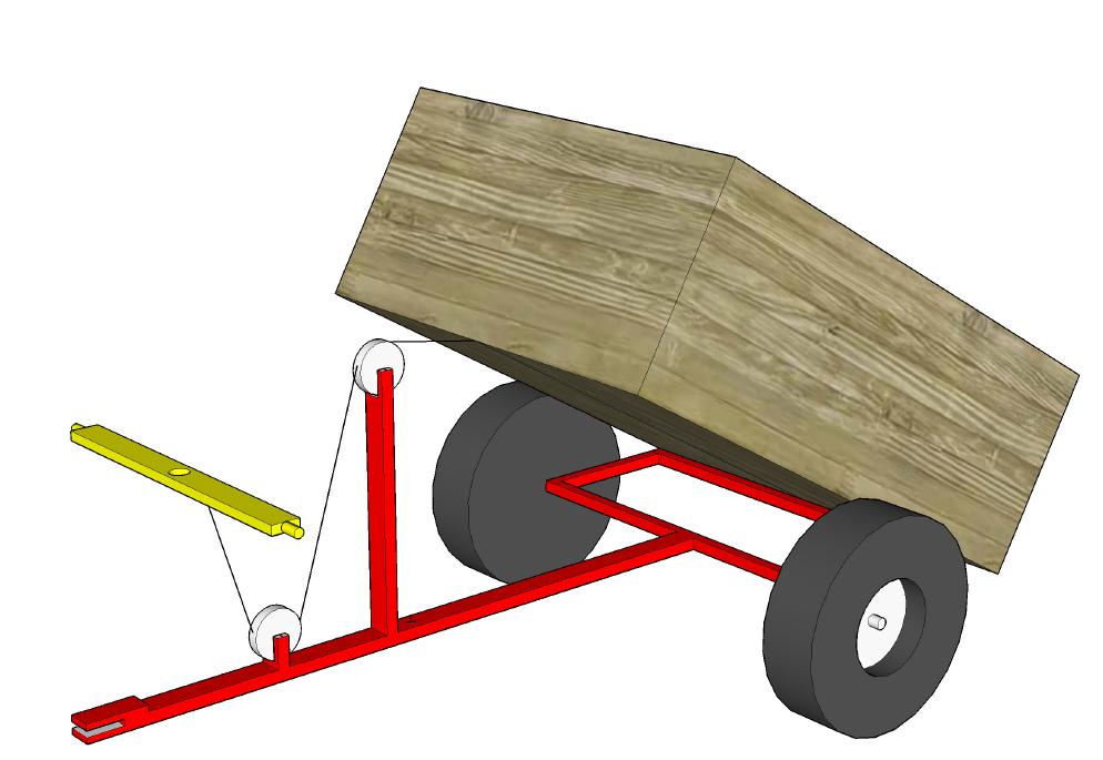

Here's a quick and dirty visual of one version I'm thinking of. Keep in mind I'm just brainstorming here. Hopefully this will spark someone else to come up with an even better idea. I can already see that you'll probably need more travel in your cable than just the 3 pt. lifting will give you.

/ DIY Dump cart? #8
hmm sounds like a good idea with cable and pulleys. just one question though- how can we prevent the tension in the turns? just making a turn will want to make it dump as the bottom tongue hitch and 3 pt hitch center moves away from each other.
Good observation. I hadn't thought of that. I guess until one of us comes up with a better solution, I'll say you just have to build some slack into the cable to allow for turns. that would, of course, reduce the amount of cable you have available for lifting, though.
I also have in my head a sort of hybrid that uses the pulleys as shown for the initial lift and then a hinged rod with a wheel on the bottom of it that travels along a track to tilt the bed higher.
I did the drawing in Google Sketchup. If anyone wants the file to play with, PM me and I'll e-mail it to you.
I'm thinking there has to be a better way to convert the force from the 3 pt. into dumping force for the trailer. Pulleys and cables seem so primitive, and there are a lot of moving parts. Plus, there are a lot of stress points
