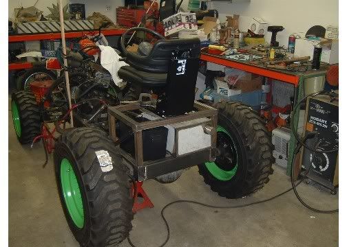

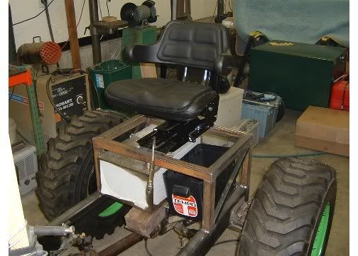

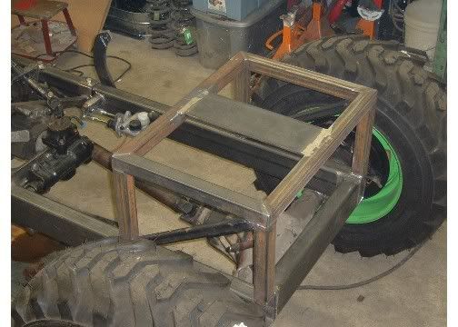

I started on the seat platform. Cutting and tacking pieces, finish welded.
Here the seat is temp clamped on and the battery box and hyd tank kind of sitting in there.

It looks like the seat is slightly offset to the righthand side. If so, I'm just a bit curious why you did it that way, instead of centering it?? I'm sure you have a good reason.
   / DIY Home built compact tractor #285
Battery box is to the left, easier to get out is my guess. :)
#286
Optical illusion, Its centered, however the steering collem is off to the left at the base.
At this point I think the battery is going to slide out the front.

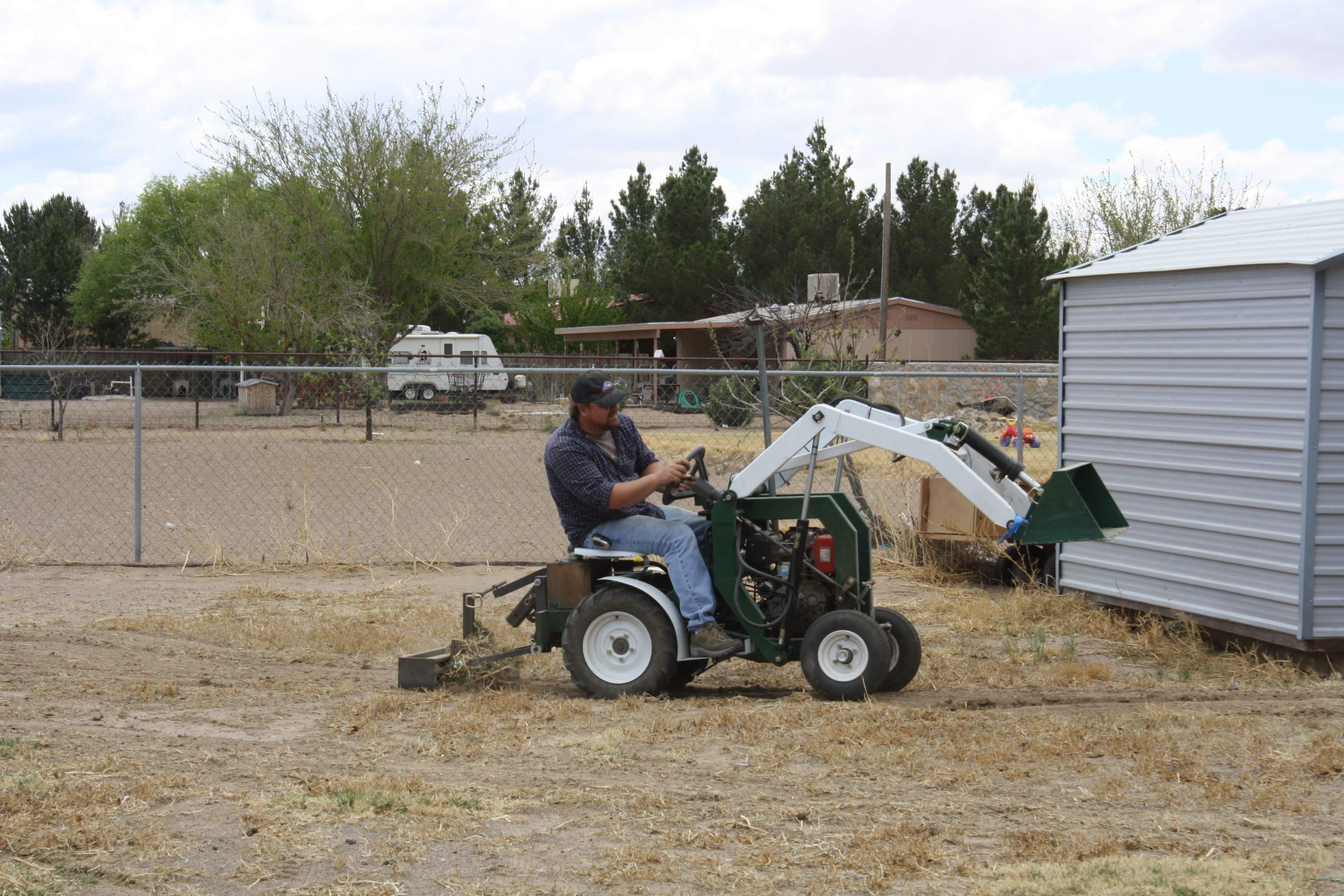

Great tractor! Its looks like it'll be a real workhorse! You really did inspire me, I went ahead and built a small tractor, just on a smaller scale. I have a lot of walk-through gates, so I had to keep mine under 32" wide. Using quick disconnect hydraulics to attach implements, and hydraulic motors to run things like post hole diggers and such.

What kind of set up have you got on the front steering gear?
Tim
   / DIY Home built compact tractor #290
I'd like to see more of your tractor.
