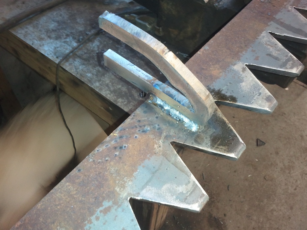

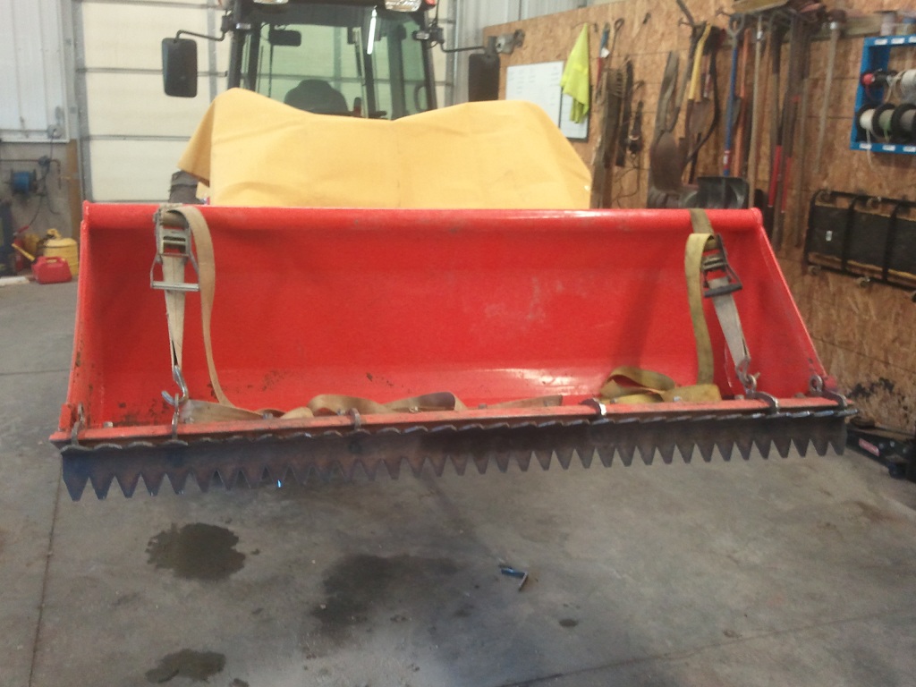

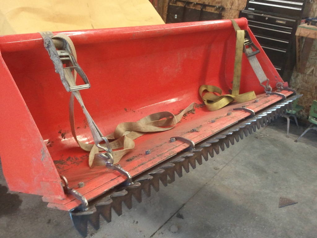

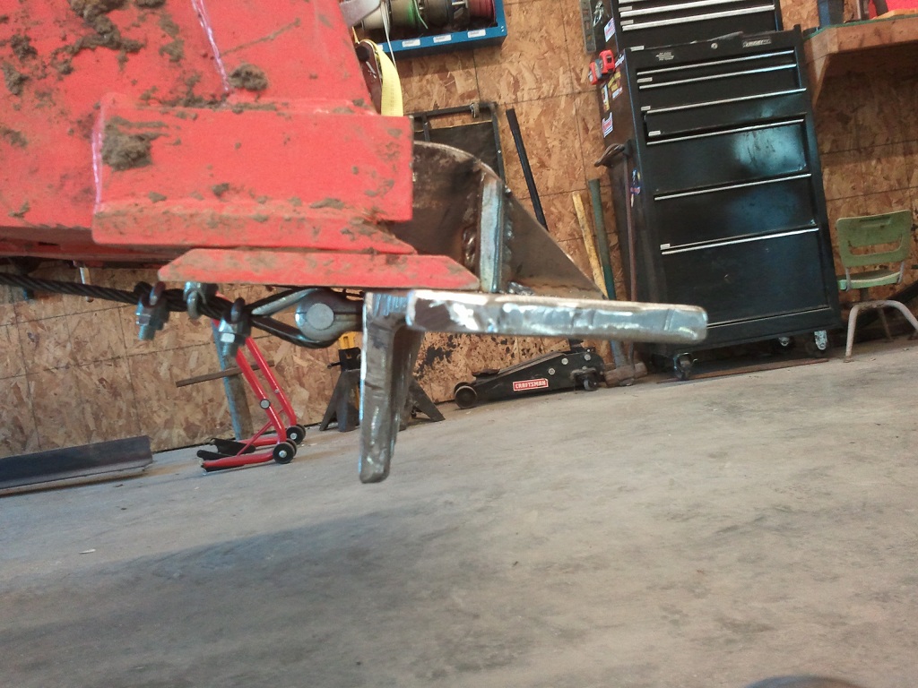

Hey all. I have a couple of little jobs to do and a ratchet rake would be handy. After some research, I realized that it may or may not work on my bucket because I have a bolt on cutting edge. Yes they do have a little tab that you can cut off, but still no guarantee. Also, my many local TSC stores (4 within 20 min.) didn't stock them. So I would have to order it, wait, then find out if it was going to work.
So, I figured really, how hard could it be to make one. Well, I had the metal laying around, the time, a plasma cutter and welder. I figured why not. Tried it out. It worked really well. Still a little tweaking, clean up and paint to go. I won't bore you with the details but here are a few pix.

Good job! I like yours better than the original because your front teeth form a V. That should make it better for tightly grabbing small trees/brush. :thumbsup:

That makes me wish I had a plasma cutter...
One question though, aren't those hooks a little weak? It looks like one with the strap on the left is bent upwards. I'm not bad mouthing your work, it's just that the hooks look under-rated for the tool.
Yup, I noticed that too. I cut my loops of and moved them forward to help with that. But.....
