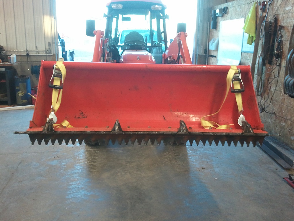

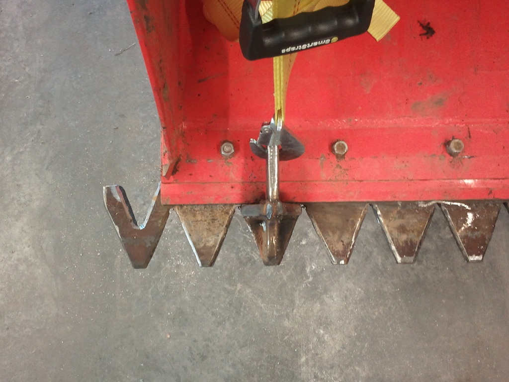

How hard would it be to pop off those blade bolts and put in anew perhaps, then weld RR-Charlie to the blade and re-attach? Buy a new straight blade so when you take Charlie off you can go back to normal?
OR
Remove blade and attach RR directly to those holes? (looses a lot of strength)
If that were feasable you could trash the straps and washers, all for the price of drilling some holes and some new bolts?
The Vine-Ripper on the ends is a great idea, if she holds...:) I predict your
going to want to leave the V that is pointing rearwards out, do not cut it, for reinforcement.
Do a u-tube! Great Job! Sub'd

Ya know, that thought crossed my mind, but two straps are way easier and quicker to attach and remove with no tools than 7 bolts that need an impact. I toyed with the idea of a quick pin on version versus straps, but haven't gotten anywhere yet. I'll let you know if I come up with a better way to attach it.:D You tube ain't a bad idea. Next job I have to use it, I'll try to video.:thumbsup:

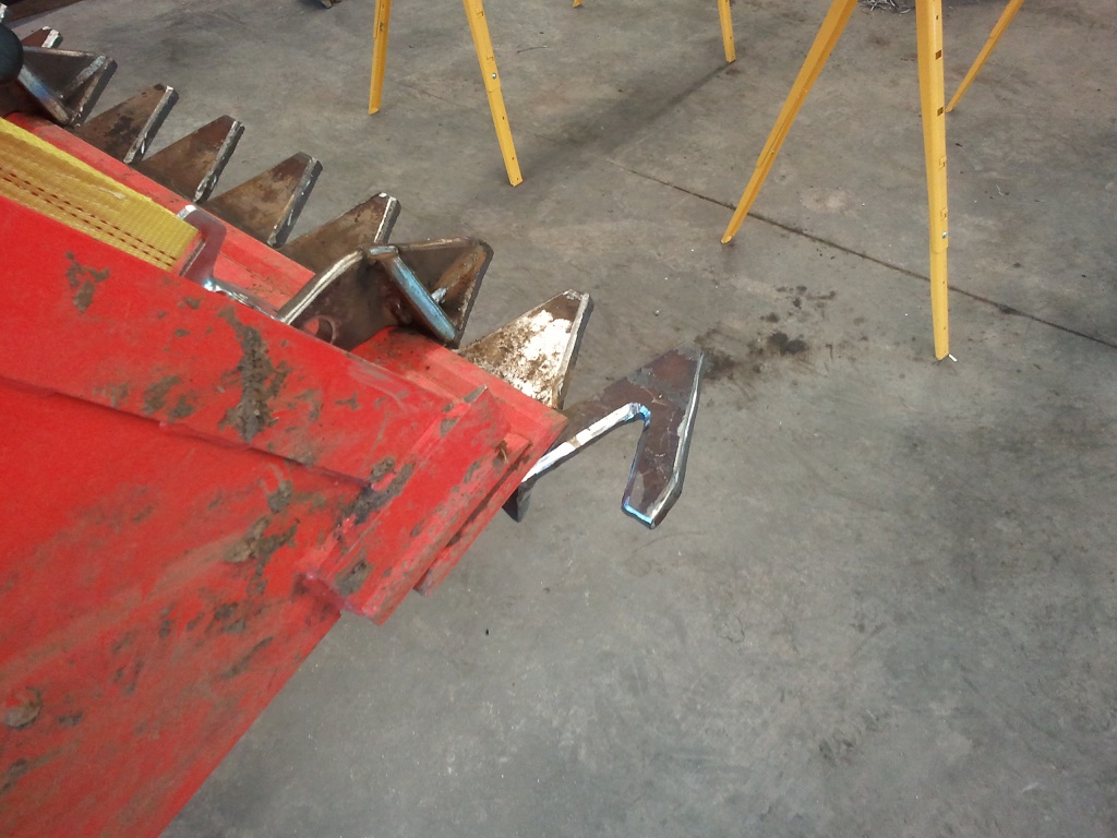

They are kinda different and kinda similar. The root rakes I know of are mounted from your 3 point and can drag some stuff out. However they are pretty flexible compared to the Ratchet Rake and you wouldn't want to try and tear out small trees, roots and all with the Root Rake. At least not the ones I've used. Plus with the Ratchet Rake mounted on the FEL you can reach limbs and vines up high. So, they are kinda different. If was clearing a lot of brush, I would use both. The RR to reach in and get the tough stuff. Then use the root rake to drag all the loose stuff that I removed with the Ratchet Rake, over to a pile to burn, haul off, etc.:cool2:

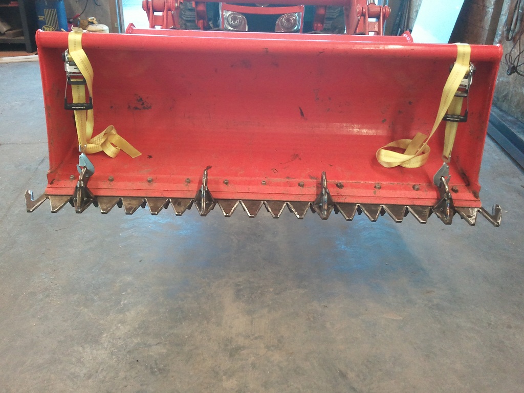

High Compression said:
Black won!
<img src="http://www.tractorbynet.com/forums/attachment.php?attachmentid=254735"/>
Looks Great! I suppose you need my shipping info now? ;-)
