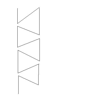

You will need heavier for sure. If you are going to brew your own consider this design; I made a set for my F250 using this pattern. You don't need a welder, no cutting and splicing, chains are easier to put on because they don't slump as much as a straight bar type, and the anglular pattern runs smoother. You would get better traction with 'real' chains with v-bars, etc but I you want a cheap easy solution this might work for you.
This pattern is made from one continuous length of chain and the triangle tips are joined by clevises. Your local Princess Auto will have both go on sale periodically so you don't have much invested. If decide you don't like the tire chains, just undo them and you still have a nice long chain and a bucket full of clevises to play with :D
Interesting! Did you use a normal clevis or an "add a link" sort of thing? And are the sides of the triangles of equal lenght?

Just a normal galvanized clevis; you can also use lap link chain splicer (you crush or hammer shut). I made the triangles to fit the sidewall overlap that I wanted. Took me a couple of tries to get the combination I wanted - after that just count links, clevis, count the links, clevis... the length over the tire is longer than the triangle base (sidewall length) - my drawing is not to scale. My guess is that the triangle base I used (for my 16" tires) used four links on the sidewall (with the trianglar pattern this would be approximately equivalent to a 2-link cross bar). The cross-over length would have been maybe ten links. I don't have them a work to count them but your tire size will be different anyway.
Nice thing is that you can experiment with any chain you have - once you have your pattern 'fingered' out - make your shopping list. Heck, you could even build these using 1/2 inch bolts - cheaper?
edit: Sorry, not a clevis, a shackle like this 5/16" High Tensile Galvanized Shackle | Princess Auto
/ DIY Tire chains #10

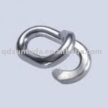

around here those lap links are called "cold shuts"
/ DIY Tire chains #18
MWB that's a brilliant idea for chains. I've been avoiding cutting up my old tractor chains in case I ever want a set that big again, so I think I'm going to use your idea.
I think lap links and cold shuts are two different things as shown in the attached pictures.

my bad. must be using the term generically ; )
