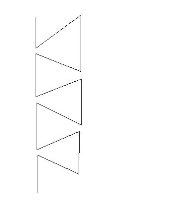

I like the z shape or triangle design diy chain. Has anyone ever tried to make chains that look like the skidder type chains with the large circle link on the tread. I have r4s and I'm afraid normal chains will simply fall between the lugs and be of no use.
/ DIY Tire chains #26
I think with the triangle pattern they will work ok - at least better than just straight bars. If you leave a little slack in the chains then they will fall out of the lugs and get driven on by the tire tread. I think they will work fine.

You will need heavier for sure. If you are going to brew your own consider this design; I made a set for my F250 using this pattern. You don't need a welder, no cutting and splicing, chains are easier to put on because they don't slump as much as a straight bar type, and the anglular pattern runs smoother. You would get better traction with 'real' chains with v-bars, etc but I you want a cheap easy solution this might work for you.
This pattern is made from one continuous length of chain and the triangle tips are joined by clevises. Your local Princess Auto will have both go on sale periodically so you don't have much invested. If decide you don't like the tire chains, just undo them and you still have a nice long chain and a bucket full of clevises to play with :D

The tires on my little tractor stand about 46 inches tall, but the part of the sidewall where I would want the chains to link up would be about a 32 inch diameter circle, OK so that times pi gives the circumference - times 2 because there is another circle on the other side.
201.06 inches so far (WAYyyyy too precise). Lets say 16 ft 9 in ?
These are 17.5Lx24 R4s and to avoid the cross chains going down into the gaps between the lugs I figured the best way to route them would be between the lugs near the edge and over the lugs near the middle, easier to see than to write about, but going from a gap on one side to the best available gap on the other side leads to almost a 45 degree angle along/across the tire.
Anyhow the number of lugs on each side and the offset between one side and the other got me to 12 cross chains each 32 inches long.
So another 32 ft for those makes 48 ft 9 in total without including the effective length additions of the joining links.
Seems 50 ft per tire would do it, 100 ft pail/bucket, so I can price that easily enough.
I think the number of joining links is equal to the number of cross chains per tire - plus one, maybe plus 2... anyway it is a couple of dozen or so.

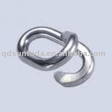

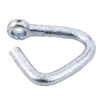

Anchor shackles ain't cheap, neither are the E shaped links with a drive across roll pin. Round numbers, you need so many of them that they cost about as much as the 100 ft of chain )-;

Seems to me that shackles go on sale and are very affordable; what's cheaper - using 24 shackles at $1.50 or less each, or spending hours cutting and welding links? Homemade won't be the quality of purpose made ones but they must be less expensive (shipping to Canada costs almost as much as the materials to make your own).
