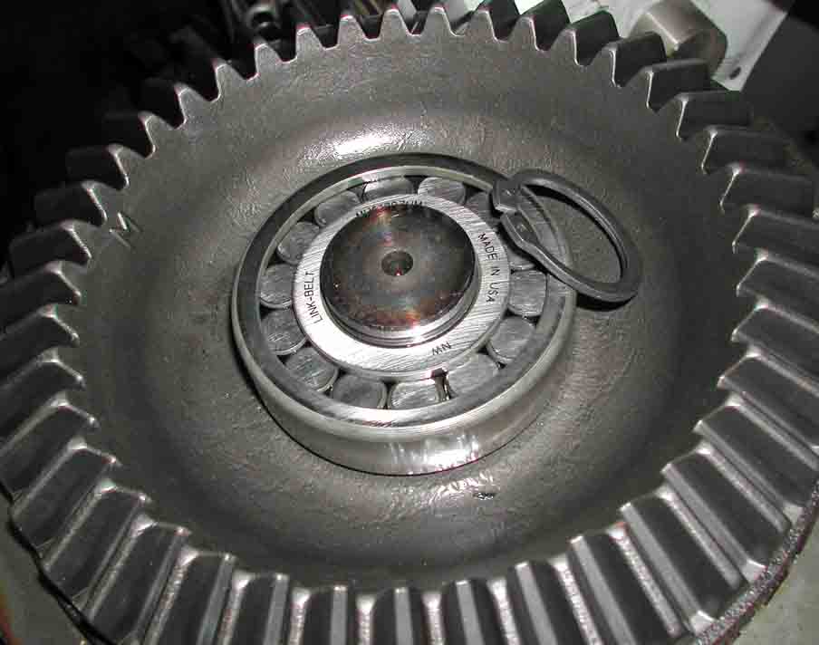

/ DK40 front bearing failure @ 1300 hours #91
That looks like a portal, so easily serviced. Pop the bolts out of the top, use one bolt as a jack bolt to pop the top cover off, and you'll be looking at the bevel gears and bevel shaft.
I don't think I'd bother replacing the gears unless there is a real chunk missing. Too bad about the backside of the portal housing has a chunk missing where it looks like to my eye the bevel gear grabbed a loose bearing and took it for a ride.
#99
Well, the inner bearings are ok, outer is trashed. Now I will have to pull the LF too, check the bearings there and flush everything. Headed to a bearing place today to see if they can match them(OEM bearing is $54.34ea). The OEM oil seals (floating seal assembly) list for $85.87(one side).......both rings on the RF are intact, so I think I am going to just find some O-rings that size.
Maybe the issue is slightly damaged hubs, or maybe it needs a bevel gear adjustment? Looking at the manual, a bevel gear adjustment is a bit intimidating. All I know for sure that something 'aint right'.
