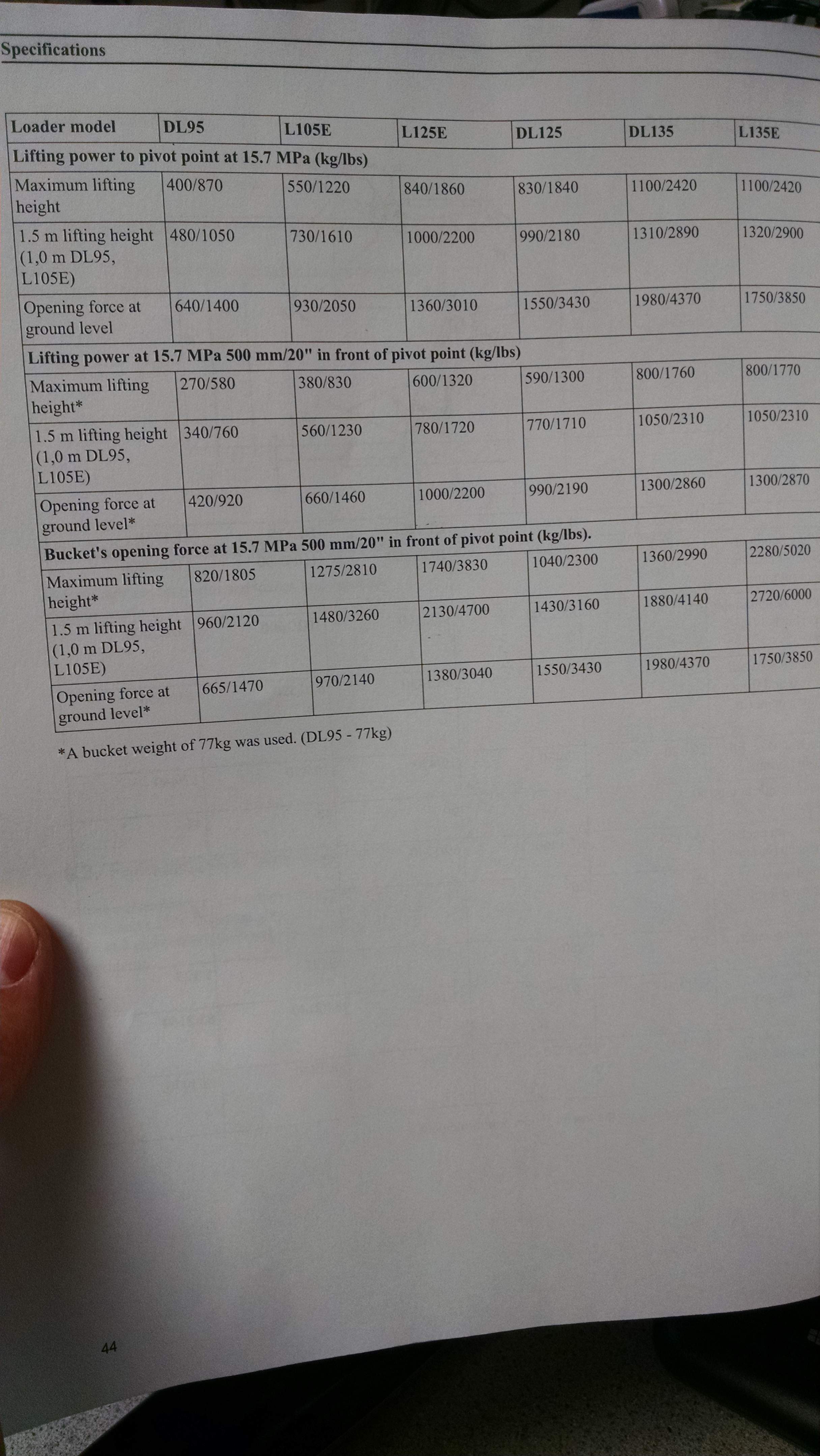

Only took forever to get a manual but here is some info for you guys
   / DL 95 vs DL 100 loaders for GC series #38
I Looked at those specs.
Makes me suspicious. Looks like those lift numbers correspond to a hydraulic pressure at 15.7MPA. That converts to 2227 PSI. Seems to me these tractors relieve at 1914 PSI, which means these numbers are close to 20% more than what would actually be achievable in the field.
Am I right? If so, that is dirty and I don't like it.
   / DL 95 vs DL 100 loaders for GC series #39
Burnm,
Whatever the pumps produce is what they produce . . however we do know that the gc1705 abd gc1710 rate at 22.5 hp at 2600 rpm and with the same motor but changed rpm to 3000 and some pump tweeks we get 25 hp.
So what if the loaders themselves had some tweeks too. Power is a combination of volume and pressure. Each set of models has pumps that have a maximum volume . . The 05 + 10 is 4.3 gpm and the 15 and 20 is 4.8 gpm I believe. But if the dl95 had increased resistance lines . . The same volume would create increased pressure in the lines wouldn't it ??
I'm not saying it does . . I'm asking if that is a possibility.
   / DL 95 vs DL 100 loaders for GC series #40
Cylinder force is the product of hydraulic pressure and the area of the cylinder. GPM from the pump only impacts cycle time.
I am wondering if the GC's actually output 2227 psi? Seems high to me for a smaller tractor and i read somewhere they output ~1900 psi. If this is the case, then these lift numbers they are publishing are garbage. Thats what I'd love to confirm.
