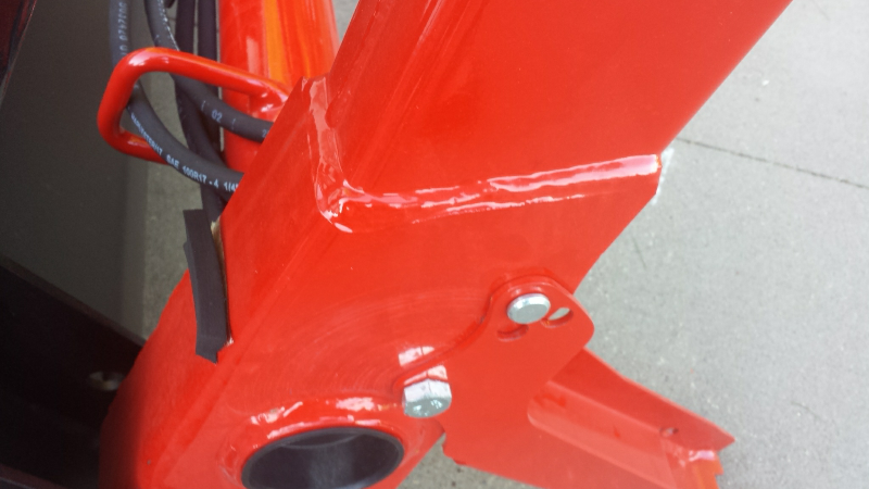

In welding fabrication . . . What are known as "step gussets" or "step sleeving" is what the dl95 has. As an example . . The width of the upper connector pivots is (I believe 2 and 15/16ths). And the width of the bottom attachment points by the bucket are 3 and 7/16ths) meaning at the point of greatest strain there is an additional almost 5/8ths inch of metal sleeving support that extends up nearly 8 inches in a surrounding fashion. If I was normal, I'd claim the dl95 is over built . . but the tradition of industrial arts instructors and machinists is "something can be over priced but never overbuilt" lol

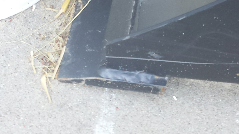

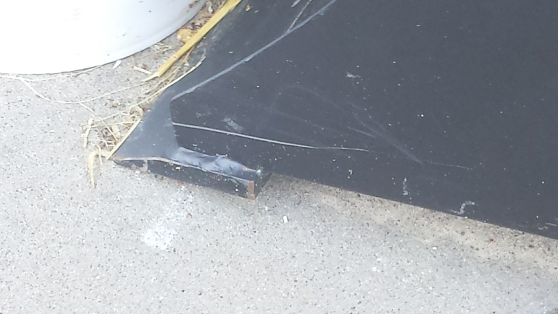

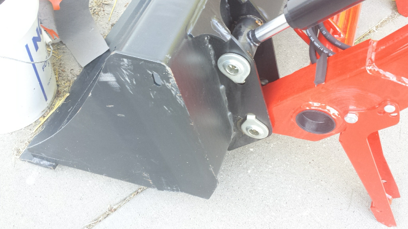

If you get a chance to attach a picture of the bucket, I'll let you know if it's the 95 or 100 version. A number of dealers put the 100 bucket on the 95 to help sell against the 100.
Here
are photos of my bucket. But I'm certain it is not a dl100 bucket because of the bracket spacing and reinforcement additions.

Exactly what do you consider substandard on the DL95 vs. the DL100? .... inquiring minds want to know.

Exactly. Just today I had my bucket off and found the pins on the bucket are 1 and 3/16ths inch instead of kubotas 3/4 inch or the dl100s 1 inch.
I saw some other brands buckets and fel arms/pistons and the dl95 is suvstantially heavier than those as well.
I fail to see how the dl95 is anything other than well built and cleverly designed in its connectors and arm design and anchoring mount posts and. Locator clips.
