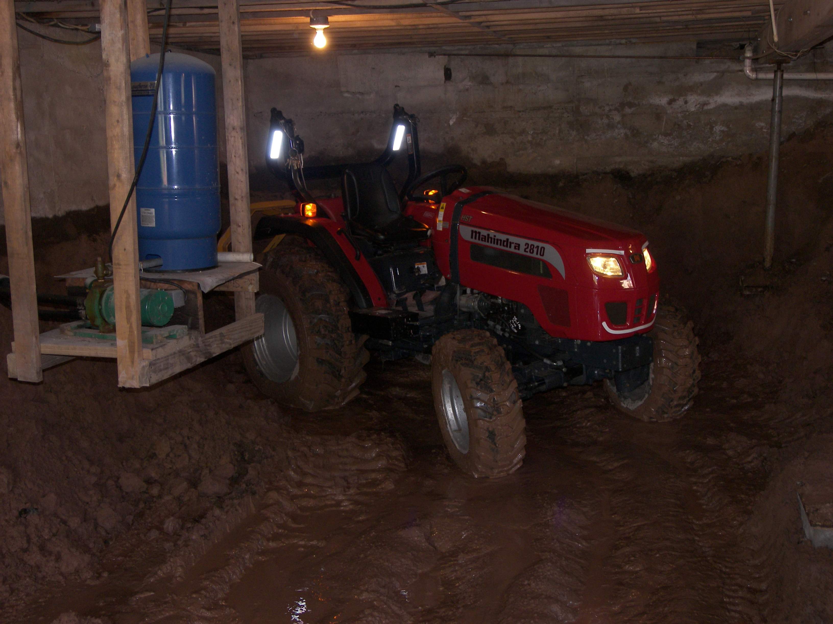

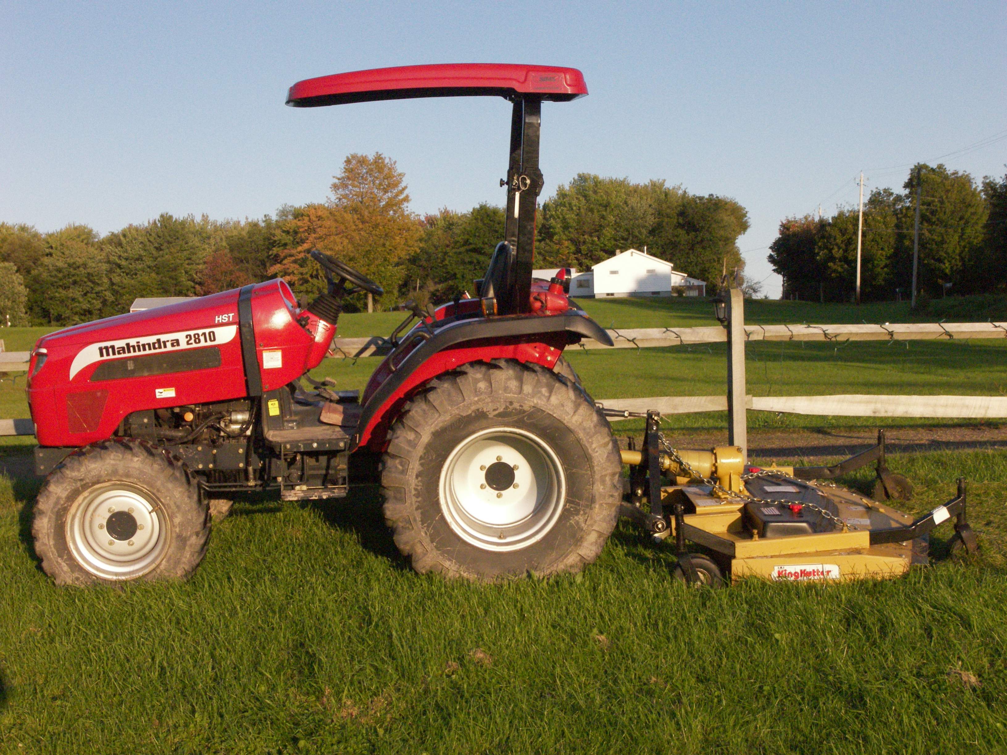

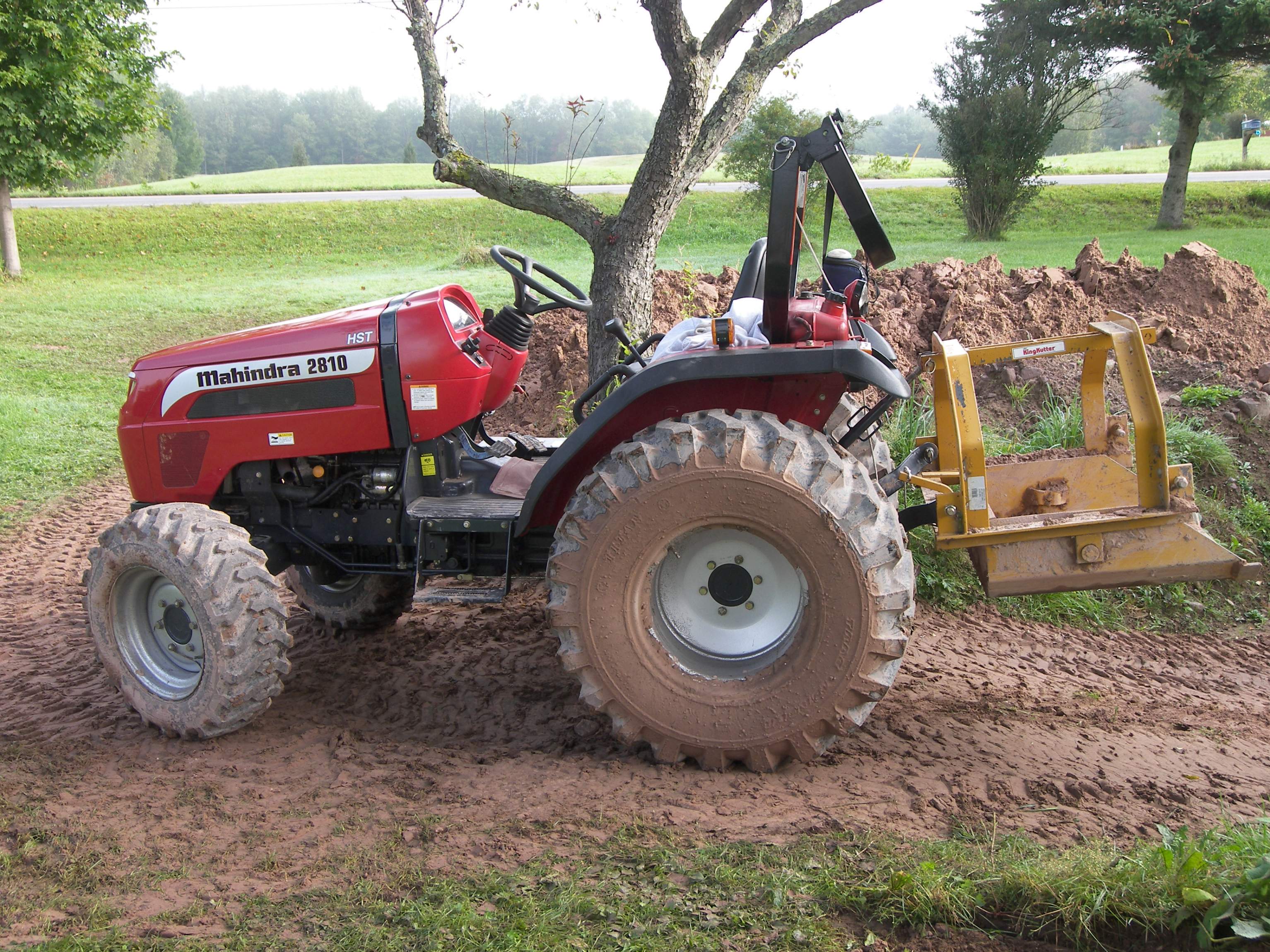

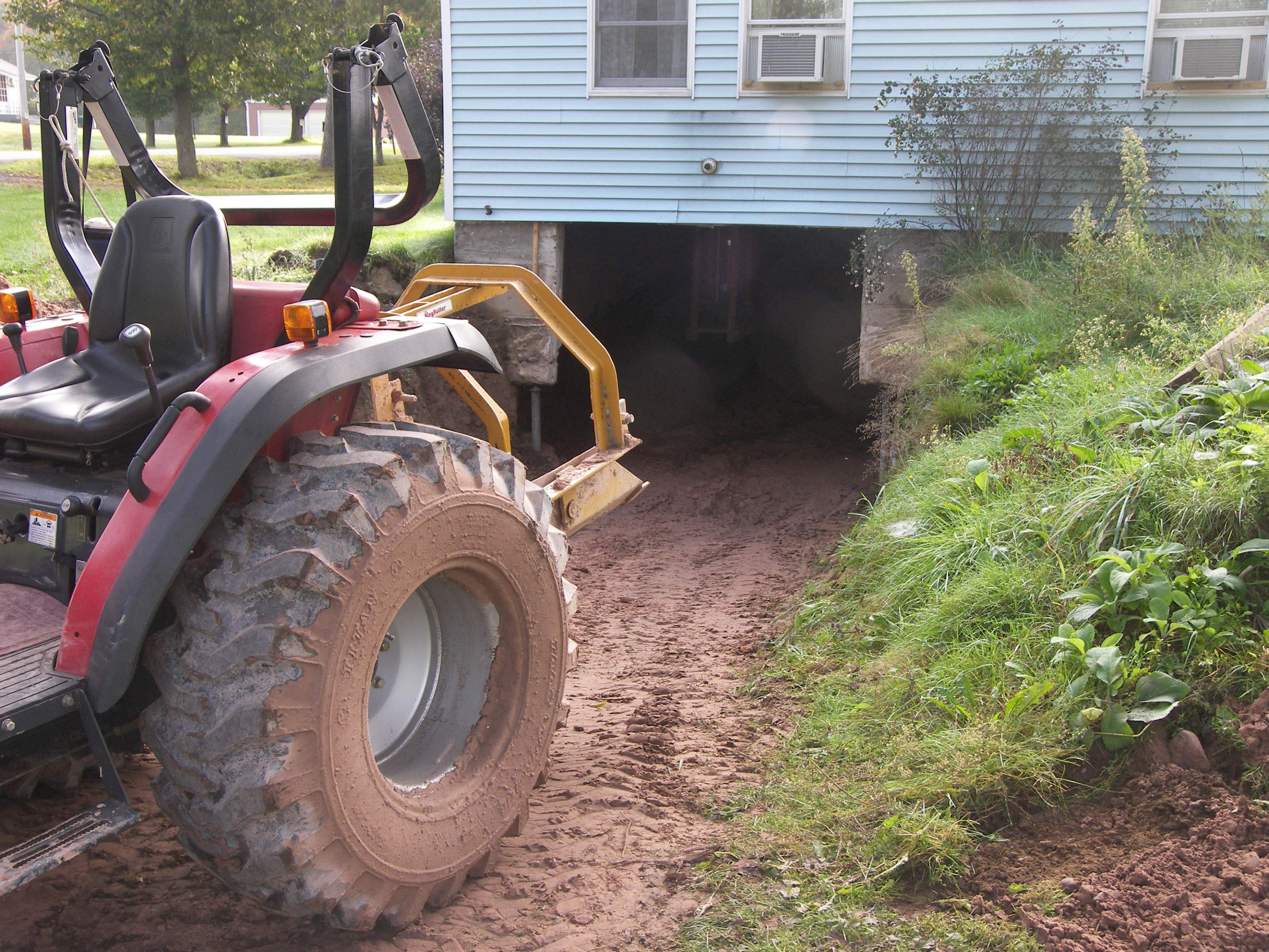

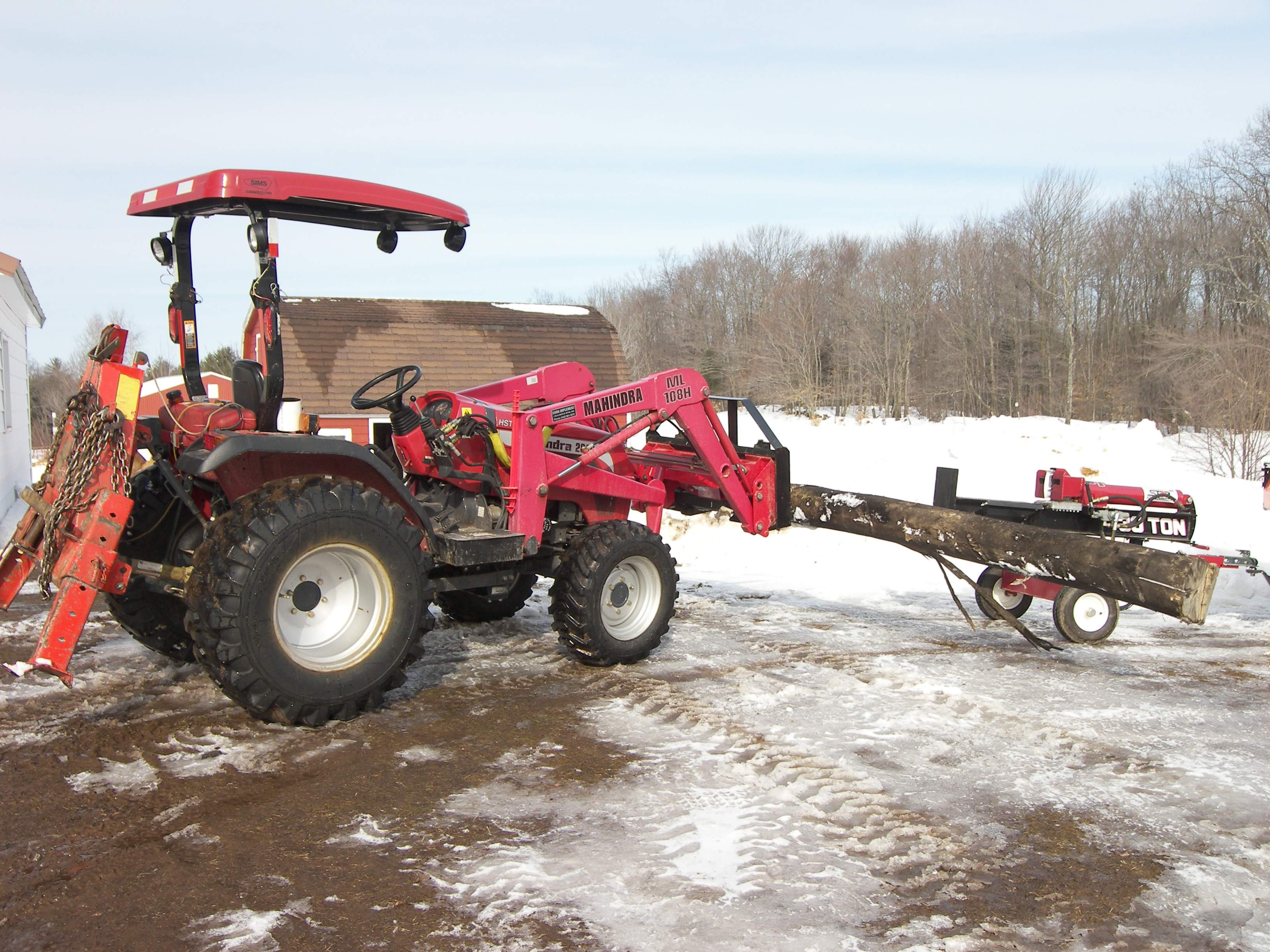

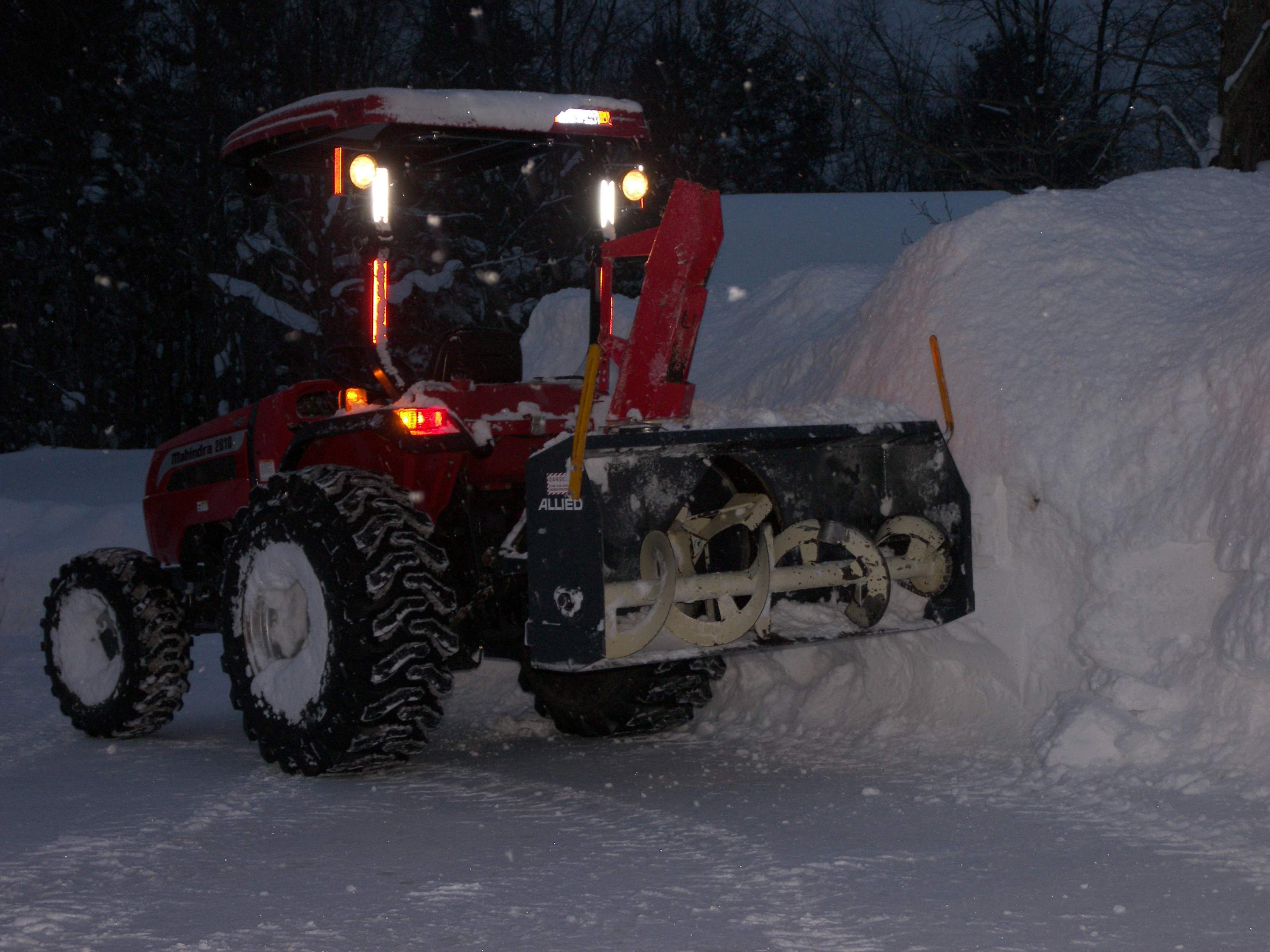

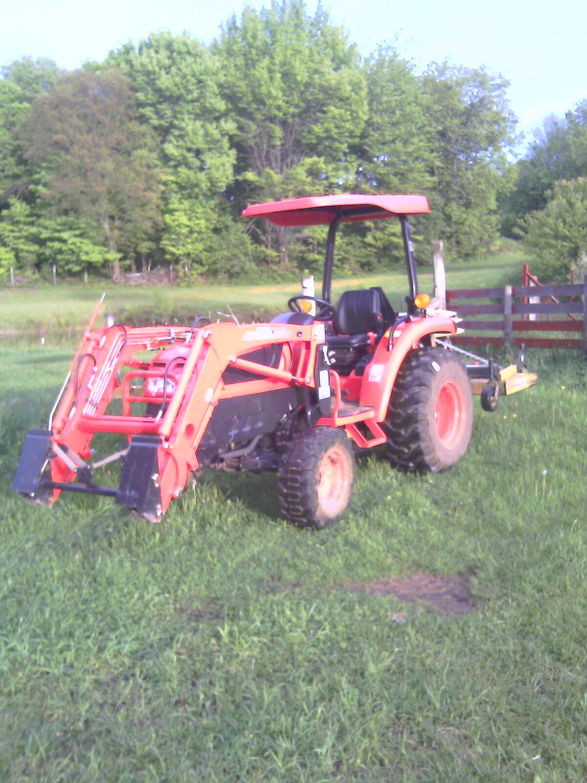

I have two tractors with R4's on them. Both are loader tractors. Both are involved in lawn mowing and on very wet ground too! I use a finish mower behind both tractors with superior results on wet grounds, i do custom mowing on large lawns and nobody i mow for has complained yet. Both tractors work in mud, snow, ice hard pack dirt and skid loggs with my winch on 3pt hitch and even dug a basement under a house.. .There a good tire. Good service on the road too.
The comment " R4s are a worst of all world compromise for a tractor, IMHO. They do resist rim-blowouts during loader work, but are lousy in every other application. They beat up lawns worse than turfs, they are absolutely horrible in mud and snow, and the deep lugs don't wear chains well. For tilling, of course, you'd be better off with AGs, but I wouldn't want to mow with them" I have close to 2000 hours on both tractors, here are some pictures of what i work in, i feel the statement is incorrect. I would noticed long before now. I guess every body is entitled to their opinion . . .John
