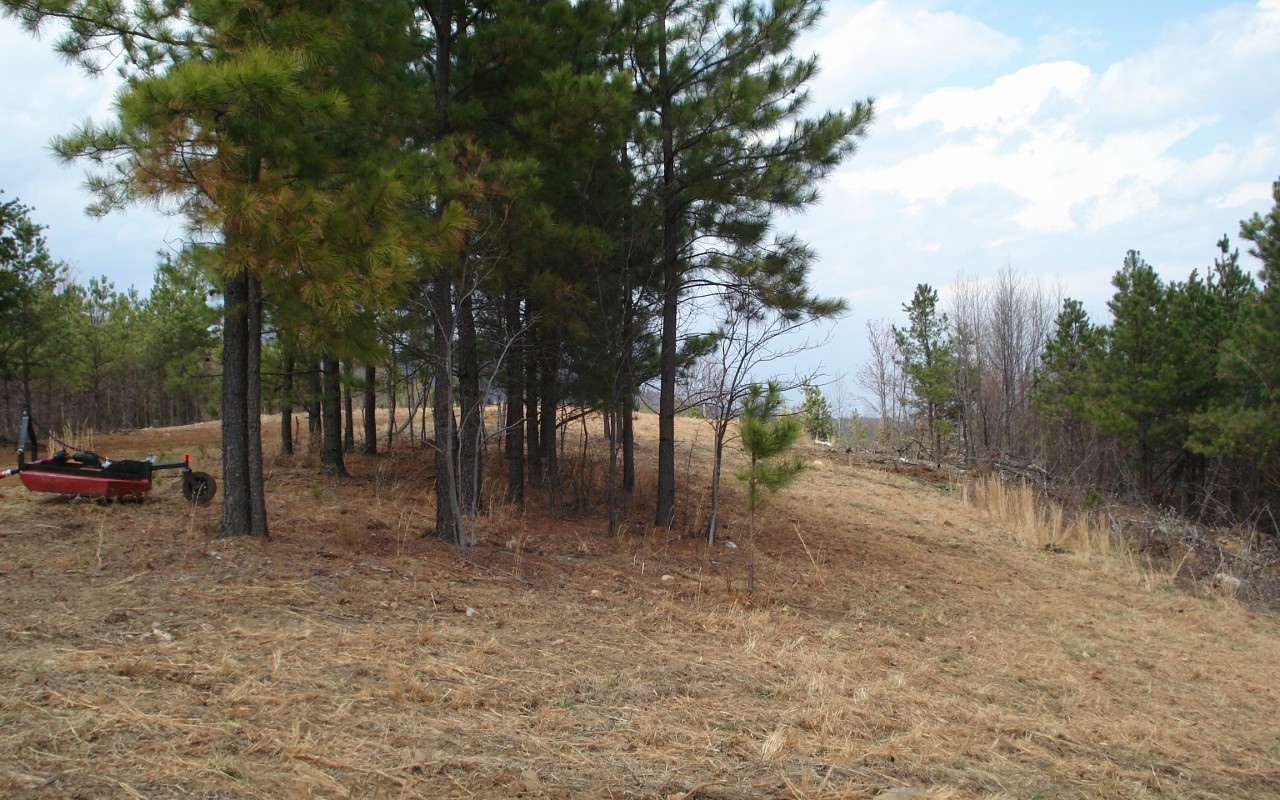

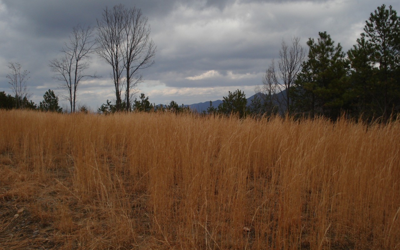

I'm trying to get things lined up to plant this spring/summer. I have a "relatively smooth" 2 acre field on the top of a ridge (nice views). I have a box scraper with diggers to do roughing up work. THEN....???? I have a broadcast spreader for seeding....THEN???
A roto tiller has been recommended (expensive) a DISK has been recommended (mod expensive), a ROLLER has been suggested and even dragging pine limbs has been offered???? IT gets breezy up there for straw and I have no water.... looking to plant clover, brassica, chickory etc.

A pic of the field would help a lot in any recommendation. Type of soil and amount of rock would also help. Limit (or not) on tool purchase or rent would help too.

I had just mowed the 3' high SAGE grass when this was taken..... many 1-2" stones....a few 4" rocks. the ph was 6.3:confused:
