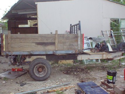

/ do it yourself dump utility trailer... #28
Nat,
Thought I'd post a few pics of my tilt trailer cylinder change. This pic shows the original manual pump cylinder used to tilt the bed. It took about 5 minutes to pump enough times to make the back end of the trailer touch the ground.
/ do it yourself dump utility trailer... #29
Pic 2 shows the new cylinder installed. Its #992030-2604 from Northern Tool. Also got a 0-5000 # pressure gauge. Cylinder has a 3" bore, 16" stroke, 1 1/2" shaft and is rated for 3000#.
/ do it yourself dump utility trailer... #30
Pic 3 shows the power unit I installed inside my winch box. (Just barely fit). I got that from Graingers #4NE14. Also bought the larger 2 1/2 gal. reservoir tank to replace the 3 qt. stock one, 2 Hyd. hoses, brass tee, and several swivel fittings there also.
/ do it yourself dump utility trailer... #31
Last pic shows the trailer in full tilt mode ready to load. What used to take 5 minutes now takes about 20 seconds. Thanks again to those who helped with suggestions.
George
