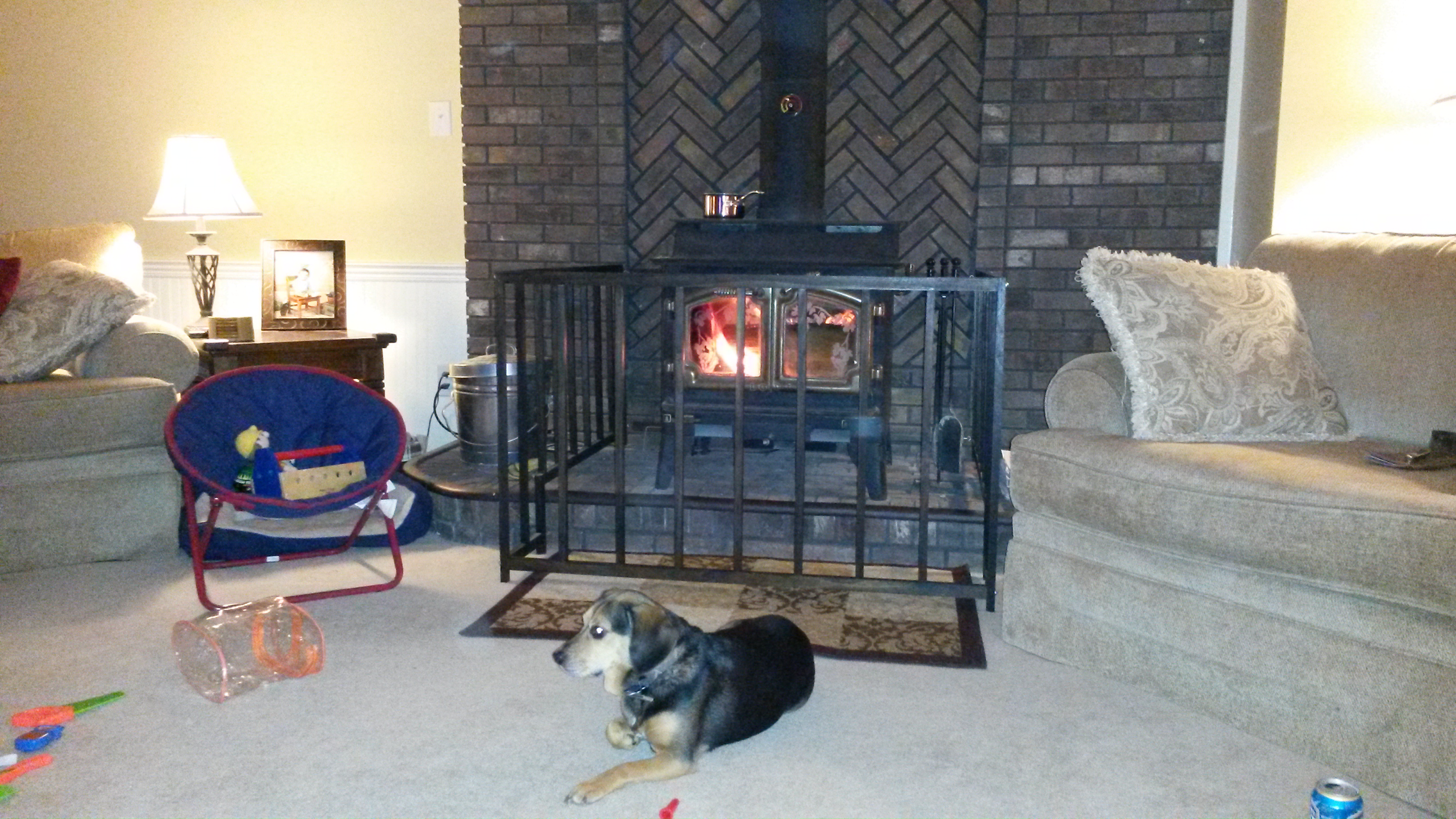

We have a LOPI stove with single wall pipe going into a square masonry chimney with clay liner.
I use a chimguard magnetic thermometer and keep it in the orange.
Always burn oak and hickory that's been split sitting under a canvas tarp for 5 or 6 months.
Clean everything every other year and don't get a whole lot. Most build up is in the tin pipe.
Now isn't that a nice Sat. afternoon picture, got the family dog in it, fire going, couch on both sides and some old time Christmas songs playing in the back ground waiting for the wife to get the beans and hot dogs ready for super. Makes me want to lay down and take a nap and wait for super to. :thumbsup:
Think I might get one of those things and see if I can get it in the orange.
Amazon.com: EXCITING EASY TO READ GRAPHICS. Chimgard Stovepipe Thermometer model 3-4. Durable genuine porcelain enamel with yellow, orange and red zones clearly indicated on black case -- shows safe flue temperatures at a glance. CALIBRATED FOR FLUEPIPES: Home & Kitchen
From the looks of your picture, you will make it glow orange after you cook the paint off hahaha.
But in all seriousness, after starting a fire or putting wood in, I leave the air open till it gets to red and close it down to keep in the middle of the orange. I have checked it with my raytech temp gun and it's accurate.
I never really considered it "exciting". I think the most positive thing I could call it would be "useful". Made in USA too.

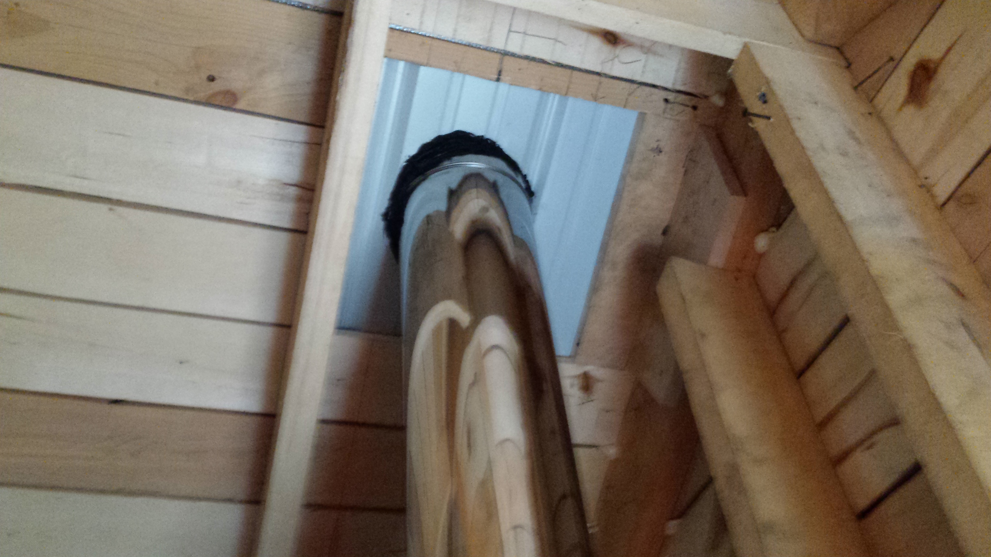

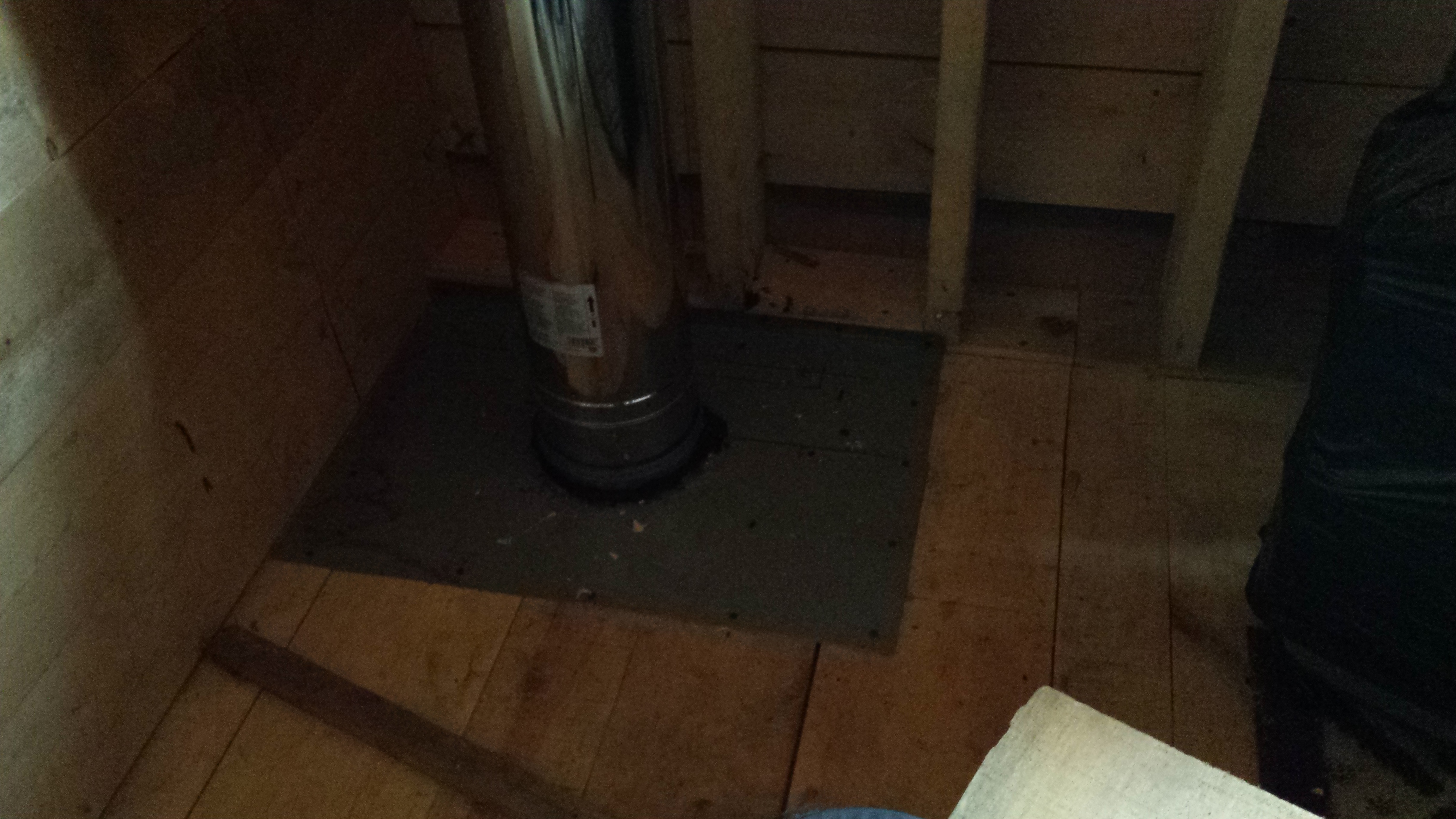

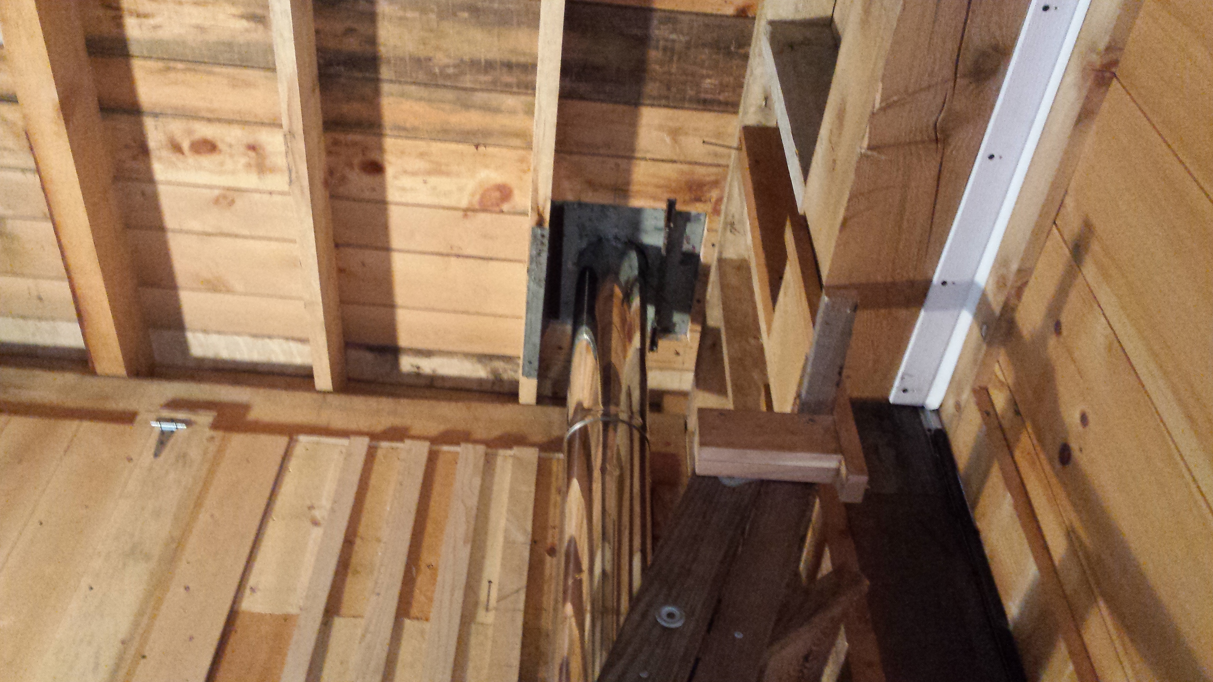

I emailed Selkirk Corp. yesterday with some concerns/questions with some pics. about my chimney pipe, like to stay somewhere near the safety parameters, guess it's fair to say that it's not a professional installation but in some ways better, like he says every 8' should have wall supports and bands, I didn't measure it but I'm darn close with a 22ga. mid floor pipe flashing that has a 1" high lip that is clamped to the pipe but later I will add some more bands.
"The insulated chimney pipe is rated for 1000 degrees continuously, 1400 degrees for one hour, and 2100 degrees for 10 minutes 3 times in an hour. The purpose of the insulation in the chimney is not to keep the chimney outer surface fr"om getting hot. The insulation is there to reduce the clearances to combustibles to a minimum of 2”. The surface of the chimney will get hot. I don’t know what type of stove pipe you have. I believe it may be a little too thin for a wood stove. The stove pipe that we manufacture is 22 gauge. Looks like you could use more supports. Wall bands are required every 8’. The piece of wood is under the tee is a fire hazard.
I hope this helps explain some of your questions."
AND>>> "Also I wanted to add that you may want to purchase a stove pipe thermometer. The stove pipe temperature should be regulated to 300-350 degrees. This will help prevent over heating the chimney system.
Best Regards,"

Threw the floor, underside, couple of these pics. gonna have to zoom and brighten to see them.
Top of floor flashing, clamped and sealed with stove caulking, the clamp bolt is on the back side, you have to turn your laptop to see it.
This is threw the roof, like after I feel when I let my wife win an argument.
