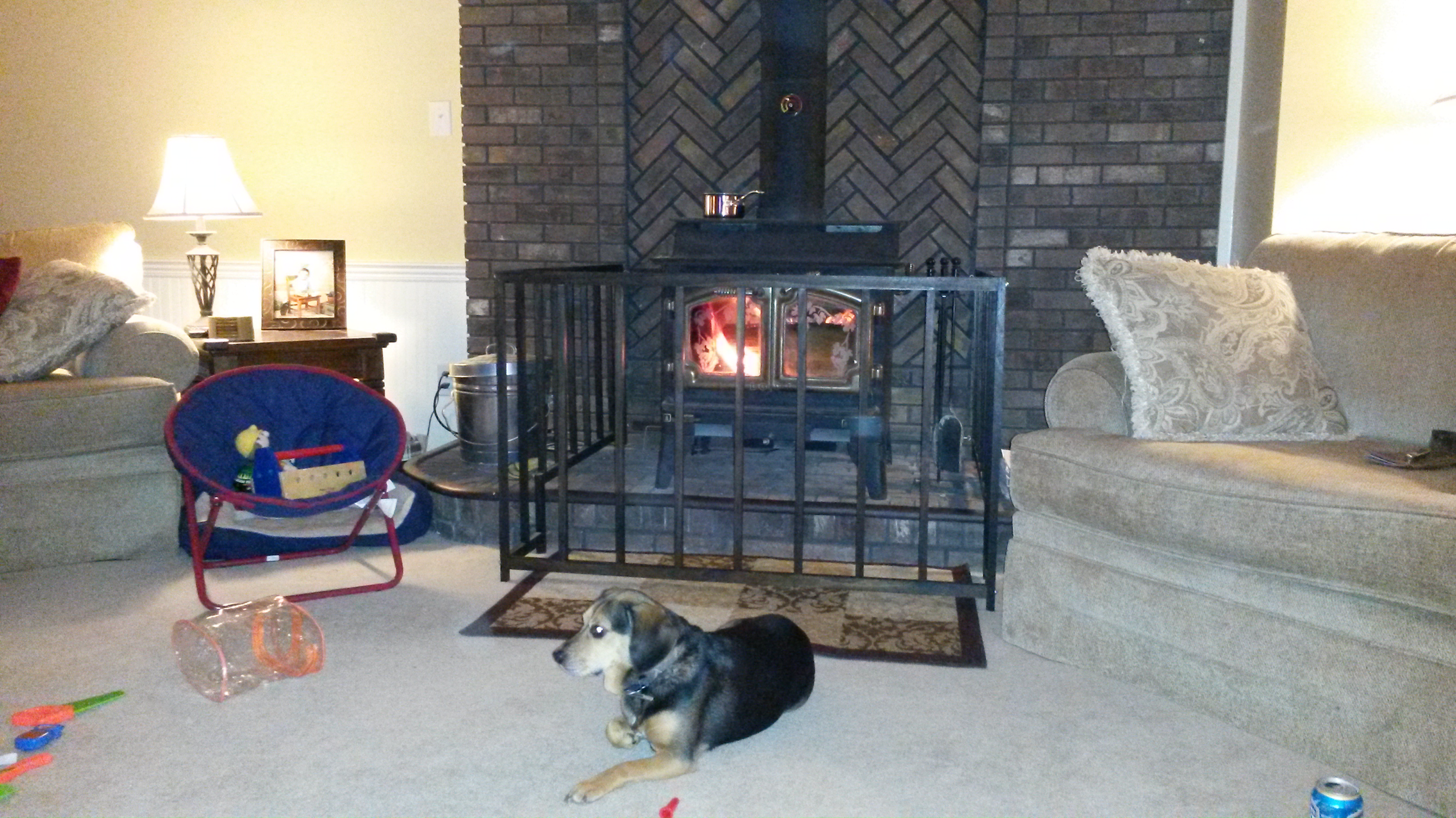

We have a LOPI stove with single wall pipe going into a square masonry chimney with clay liner.
I use a chimguard magnetic thermometer and keep it in the orange.
Always burn oak and hickory that's been split sitting under a canvas tarp for 5 or 6 months.
Clean everything every other year and don't get a whole lot. Most build up is in the tin pipe.
