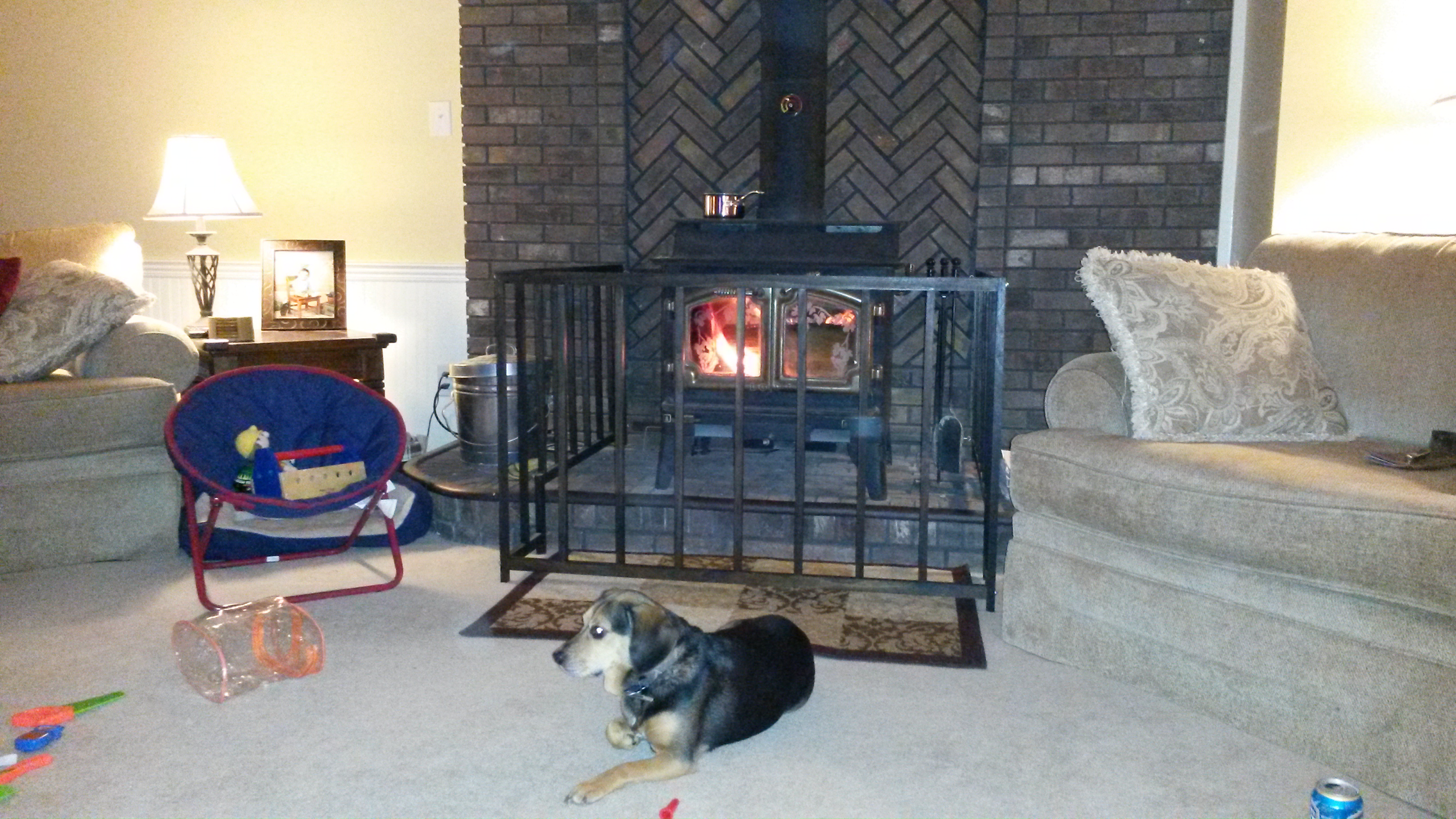

The thing about single wall vs an insulated flue is this: You should be running your stove to keep the exhaust temp ideal, not the stove temp. In other words, if you opt for a lengthy single wall in the living space, that means you will need to burn at a slightly higher temperature in order to keep that flue temp up and avoid deposits. An insulated flue allows you to burn at a slightly lower stove temperature since the exhaust will hold it's heat all the way up. There's no free lunch. Single wall = more wood to burn hotter but throws off more heat. Insulated flue = less wood required to keep flue temps up but you don't get the extra room heat from the flue.
I had over burn and under burn problems until I learned to monitor the flue temperature better. Now I use the look of the fire and the stove temperature as an indicator, but the flue temp drives my controls.
