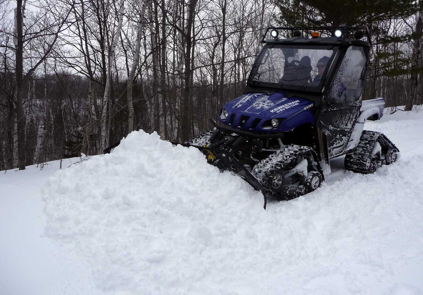

20160302_155952676_iOS.jpg My plan is to keep my current tractor setup and add the UTV/ATV capability for light and moderate snows, along with doing with the 300' of sidewalk duties I'll be picking up next winter. I also have kids that like to ride bikes and quads, and I have fun tailing along behind them. There's no one perfect product, I'm just hoping to find the one with the best chance of serving both functions and providing me the ability to carry a passenger or some other stuff too. Plow trucks and tractors aren't gonna do well on some of the places I plan to go with the UTV.
But then again, the whole point of this thread is to see if my expectations of being able to remove snow regularly on a UTV that can go 40 mph are realistic. So far it seems like we have several members doing it and I haven't had a horror story yet. So who's got one to share?

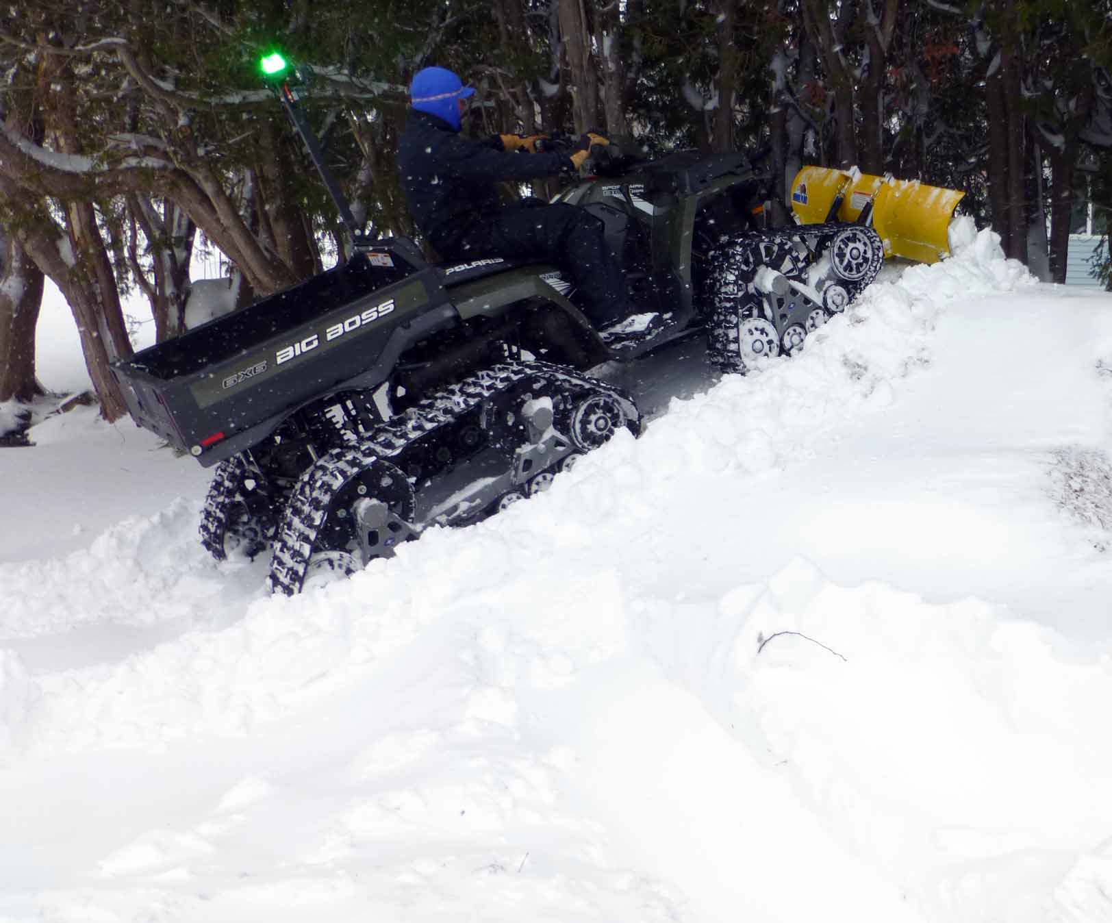

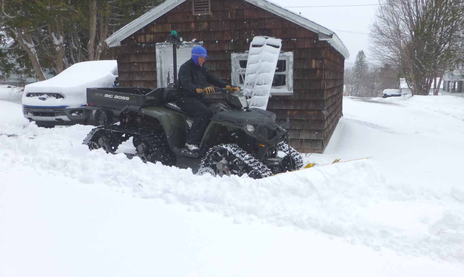

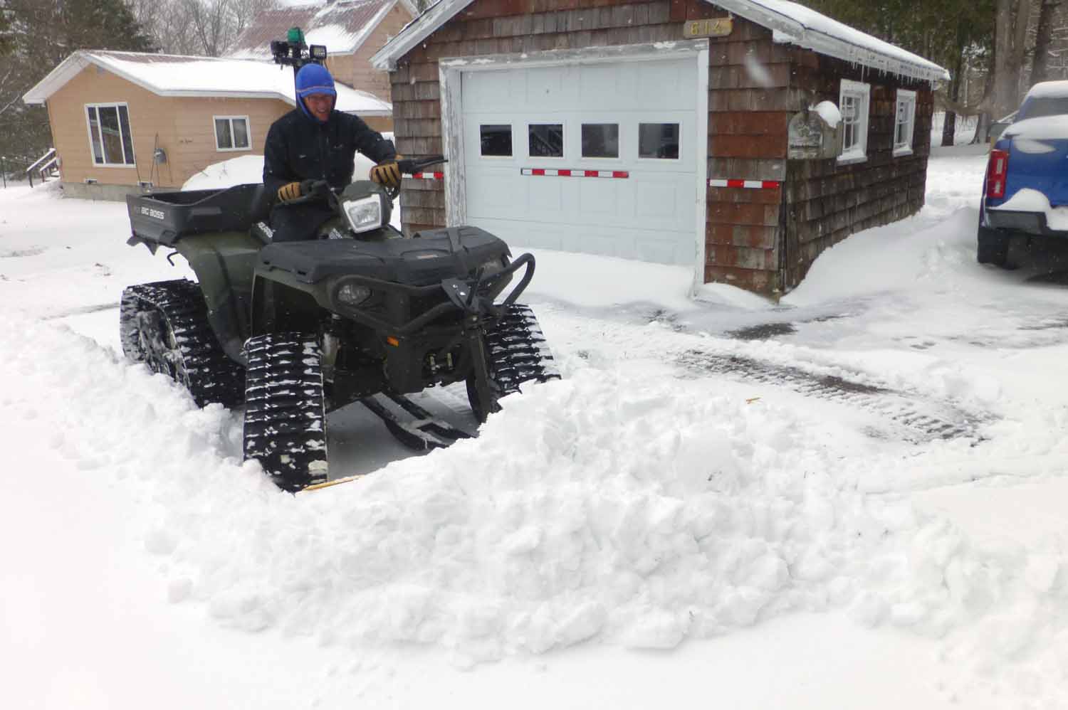

Can you tell us about your atv or utv snow pushing experience?? I've done both, and used our 6x6 to clear our yard and drive with. You couldn't pull that machine from my cold, stiff fingers. Will this machine work for the OP??? No idea!

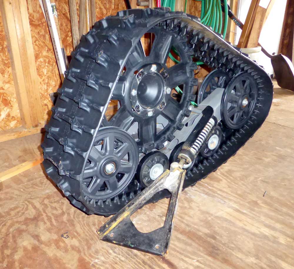

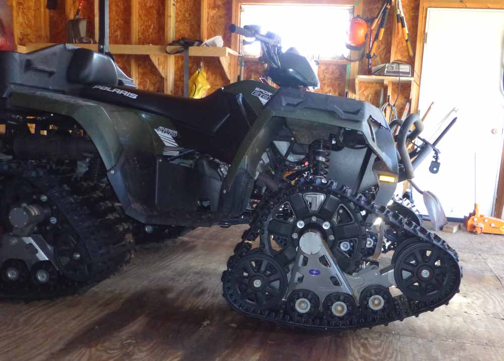

Milk, tracks* or pods, which is there real name are spendy but I'd not push squat of snow without them. Not sure I'd even have a blade without them but most of my snow pushing is on the yards grass or packed snow. Nonetheless, the 6ft blade has been good addition for us. We do not run the pods after snow is gone.
We did do two days of joy riding with the machine in snow this past winter. Below the links are to the events.
Here is one. Here is another we did at a old cat rondo old cats
*tracks are the rubber part with lugs. Pods are the entire unit you add to give you extra flotation.
In this photo, we are parked on 4ft of base.

The key for the OP is he is using it for light snows and sidewalks. He has a tractor for the heavy work. A UTV solution should work for him.
I used a Polaris 850 with a plow as my only snow weapon for two winters. I needed chains and it was useless for piling up mounds of snow, but it got the job done and I live where we get 120-140" of snow a year. I never damaged anything. I had the Polaris brand plow on it. I broke two shear pins so that is how you "protect" the UTV from excessive forces. Carry two spares with you as you SOL without them. You can use a bolt in a pinch but then you might prang something if you are not careful.
I would never recommend a UTV as the only snow weapon for areas with heavy snow.
BTW, those tracks are not cheap and it takes over an hour to put them on and remove them. They will reduce your speed by 50% and throw mud all over you so they need to come off for riding trails. I had a set and sold them.

That's all good feedback shooterdon. So the pods must effectively have something like a 2:1 gear reduction. That would definitely add some grunt to the additional flotation and traction. It would be interesting to try a wheeled version of a vehicle in snow and then switch to a version with pods. Mounting/dismounting, maintenance, longevity, and cost would all have to be looked into more before investing in a set. But, they're still something I'll be on the lookout for an opportunity to try whenever a future opportunity presents itself.
