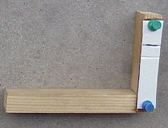

Checks cutting edge height in any blade position, L to R or F to B. No numbers to record or attempt to remember.
