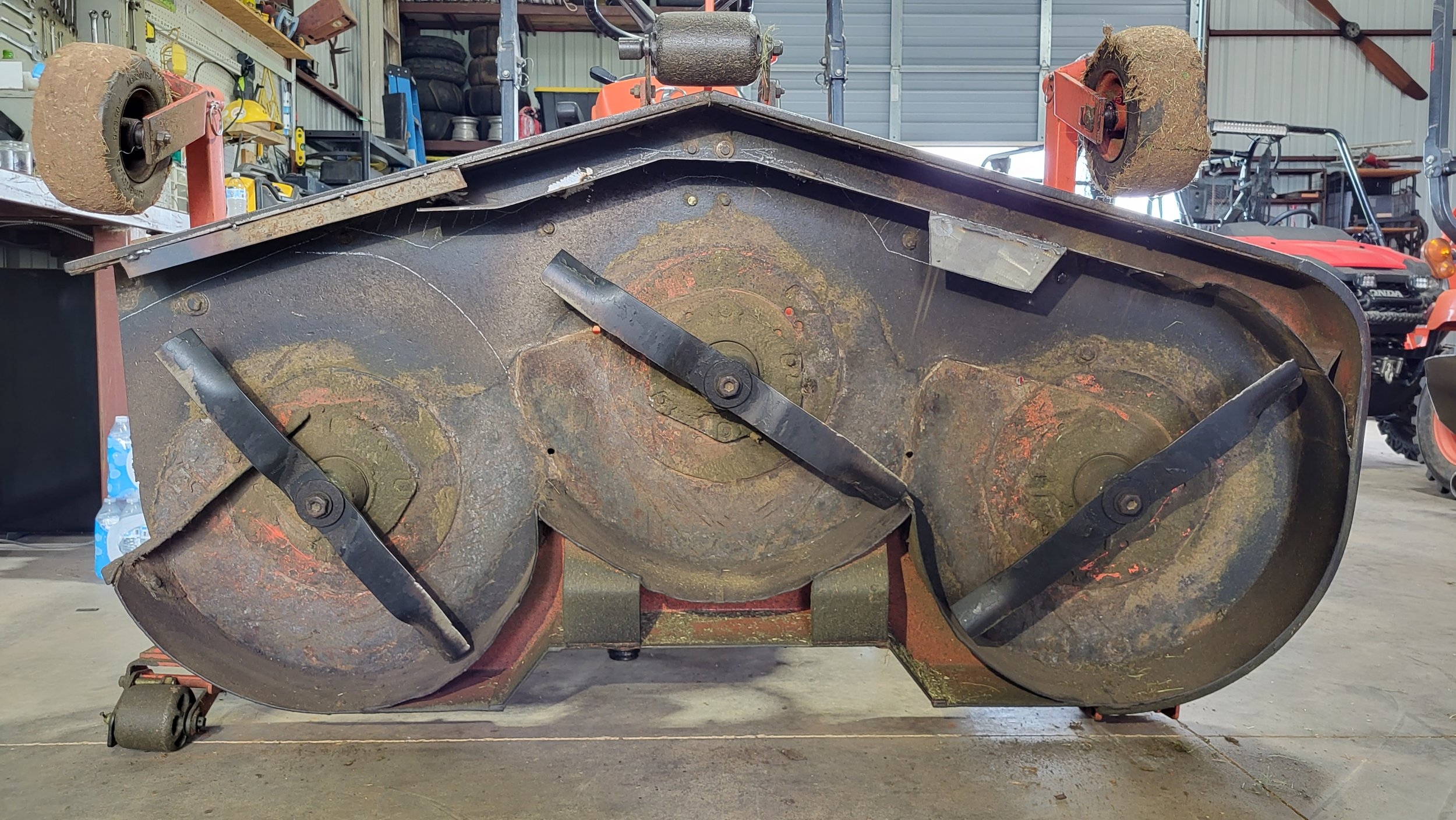

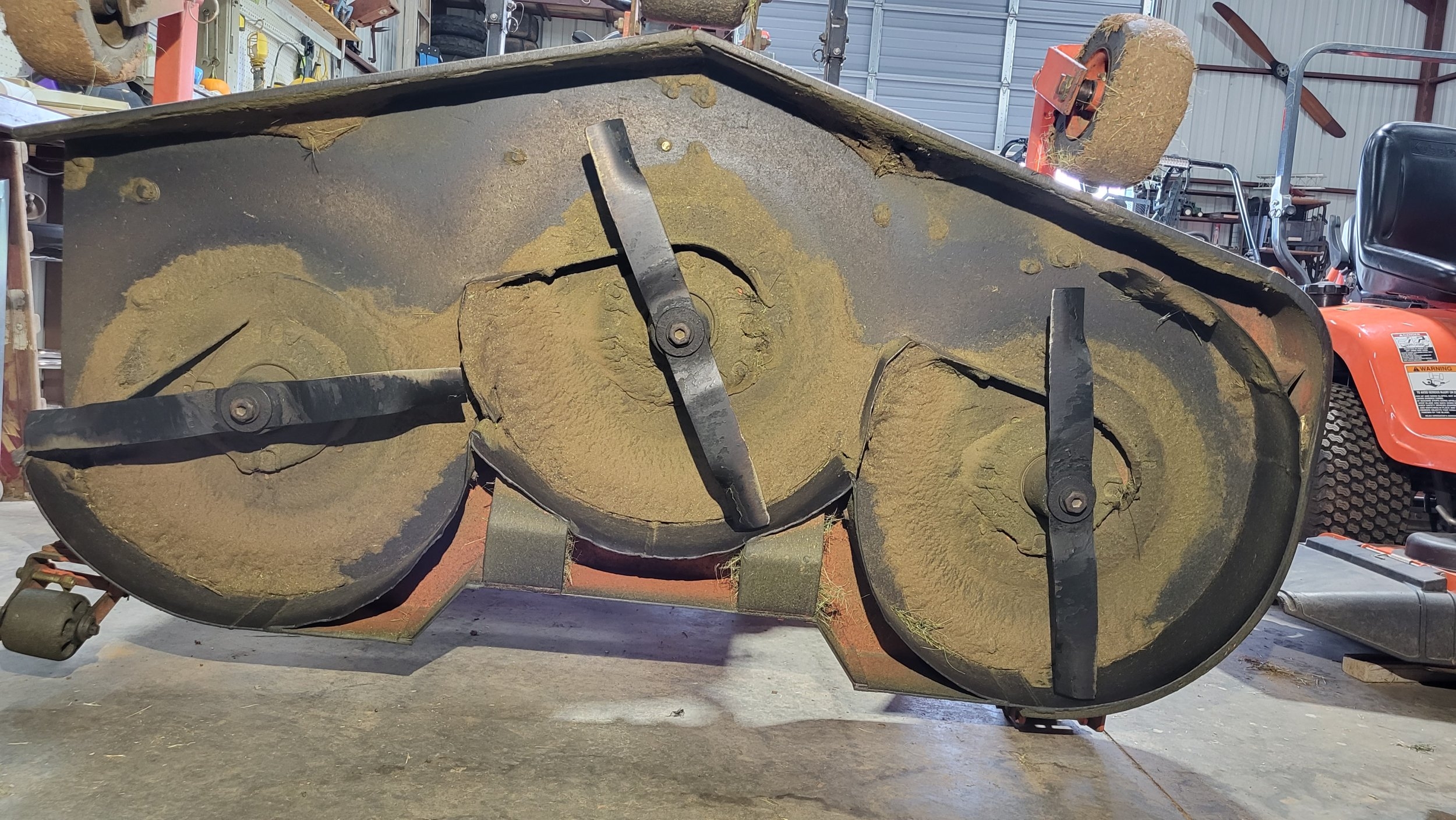

Well the mowing deck gearbox seal has basically failed at this point. The gear oil will leak out after about 30 min of use. Way too risky to continue using.
I'm going to do some forums searches and read a few threads before tearing into it. Hopefully there's nothing else weird going on and seals will fox it. I'm guessing if the shaft(s) are smooth then a seal should do the trick. Any advice or links is welcome!
   / Walker's F Series Thread #83
If the majority of it is leaking out then the seal is damaged. If it were just seeping a bit, I would check the vent but a clogged vent won't create that much fluid loss.
It is good that you caught it in time so that hopefully a seal is all it needs but while it is out I would seriously consider bearing replacement.

There was a puddle under the deck where it sit all winter.
I took the gearbox off and replaced the lower seal. The bearings were all intact and spun freely, everything looked good and clean from what I could see.
So far so good but I've only used it for about 2 hours so far. Time will tell.
At any rate I now know how to take it apart. I honestly forgot all about the shop manual I had on the shelf... I just started taking it apart. I got it apart but it wasn't per the book. If I remember correctly, the book has you drop the whole lower spindle carrier.
I may pull it completely apart next winter if I'm just looking for something to do. I could have gotten a better look if I had that whole piece out on the bench.
