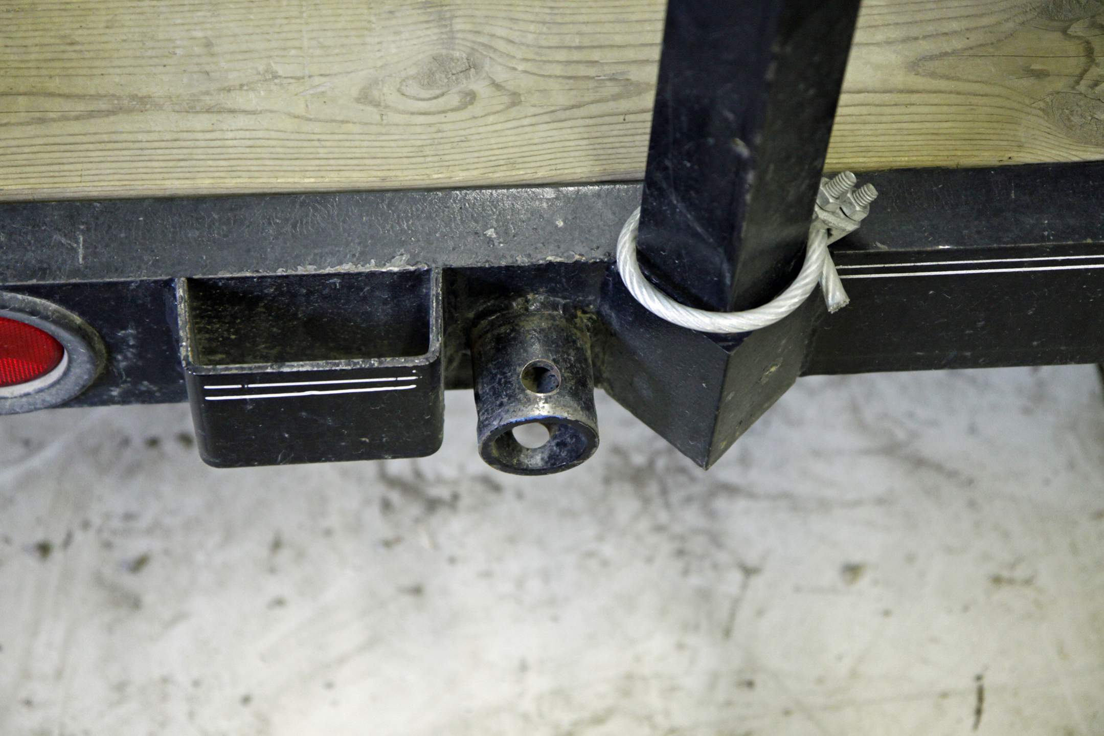

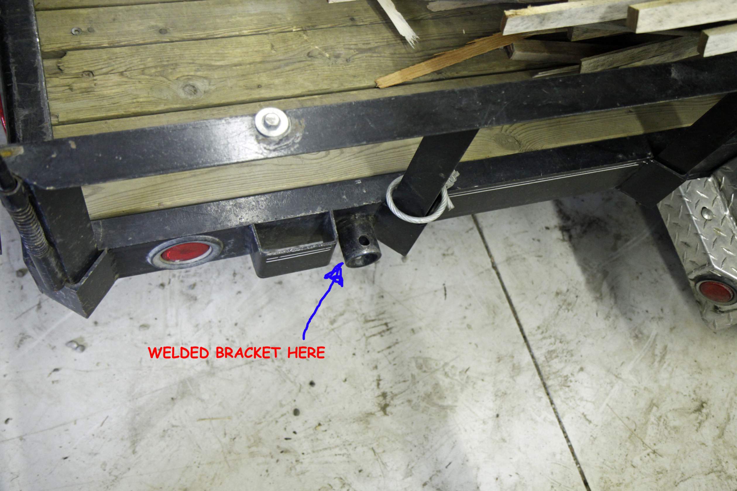

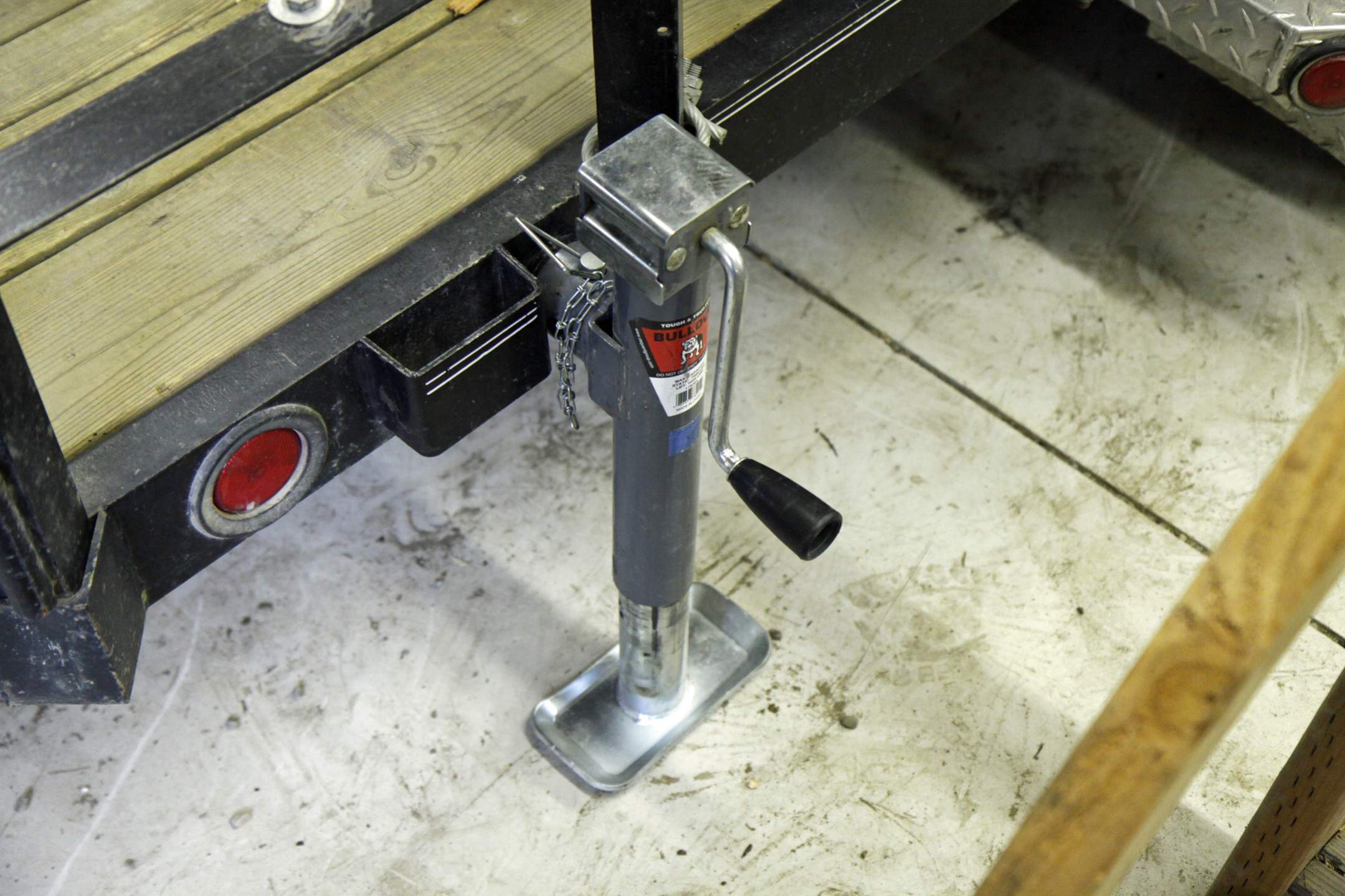

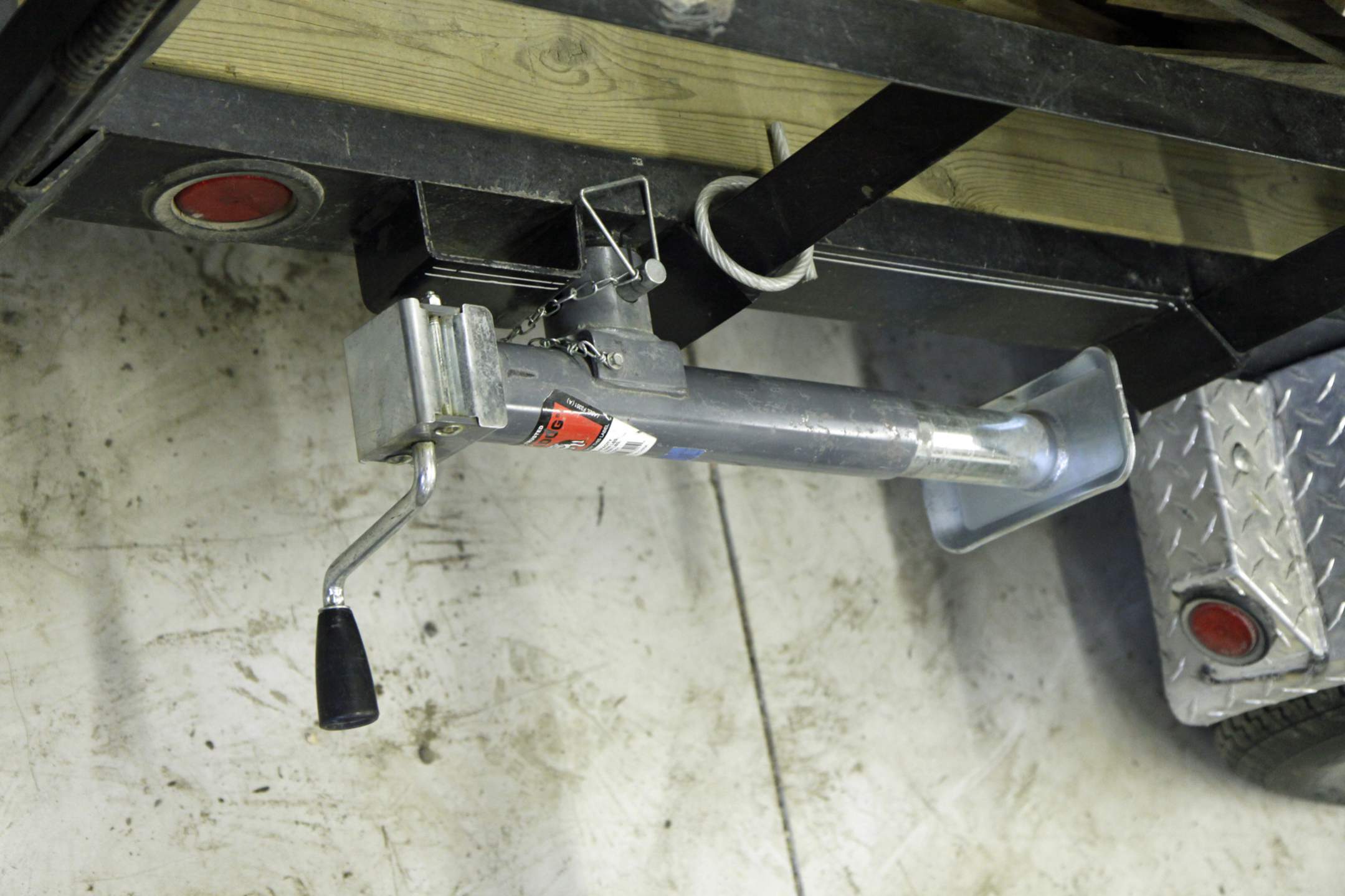

on my old trailer i added 2 swivel jacks to rear of trailer. beats the heck out of blocks. made a big difference. My new trailer is a tilt bed, so no longer any issues. TRAILER BRACKET 4.jpg TRAILER BRACKET 3.jpg TRAILER BRACKET 2.jpg TRAILER BRACKET 1 copy.jpg
