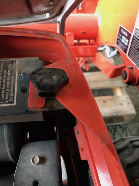

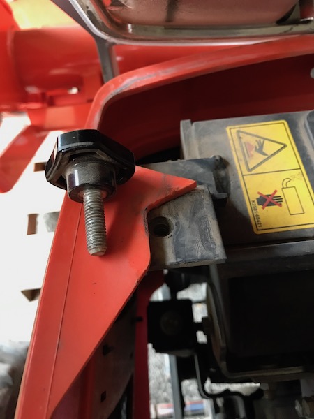

Almost hit 400hrs (393) and decided to do the maintenance while weather is nice for a change. Changed oil/filter, transmission/filter, and front axle oil. All went pretty smooth. Biggest pain in the butt was removing the Brotek skid plate to get access to the tranny filter. Second biggest pain was installing the engine cowling after I was done. Broke the little tab off of one of the plastic retaining clips. the fluid changes themselves were simple.
All was going well with little mess until the end. I was filling the front axle that I had lifted off the ground and didn't realize the fuild was coming out of the breather hole on the opposite side. Big mess in the driveway. Oh well. Feels good to have that done. Still need to replace the two fuel filters but that will be another day. Thinking about it, I should have at least replaced the upper fuel filter while I had the cowling off. :mur:

Mark, you must have missed the post I did a couple years ago. Just mount that second filter underneath like the other one. After breaking one of those OEM plastic ones and losing 5 GL diesel on something; I went to the metal cased generic ones. The 2 hoses just interchanged. Was able to manage it w/o removing the cowling. Also get one of those finger type filter wrenches made to go on a 3/8 socket extension. Oil filter changing is done w/o removing the cowling. I have banged up my cowling and hood so much when I had the forest that am thinking of replacing both this winter. Sure rattles a lot w/a lot of the connection points broken. The age of plastics.
