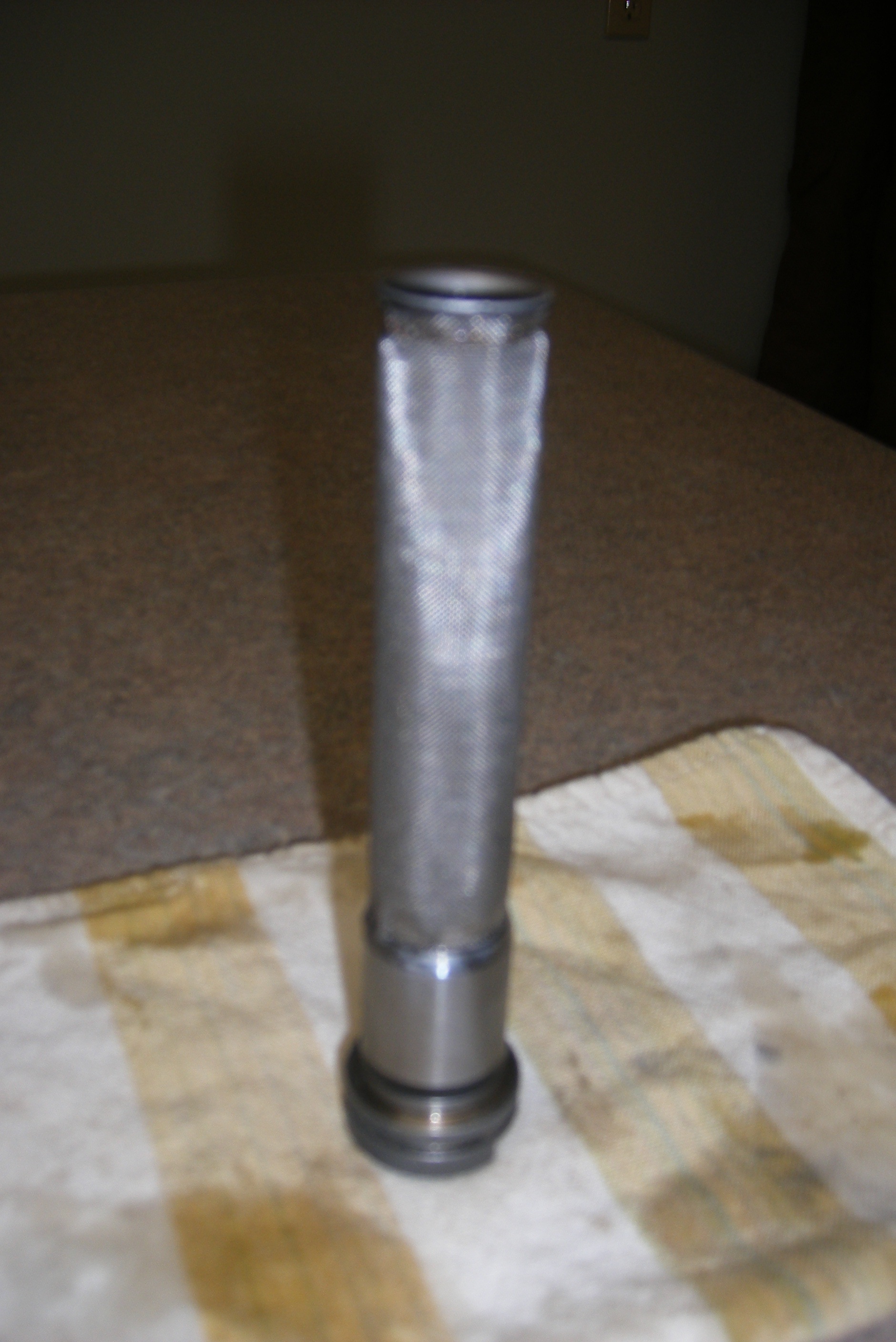

   / Do your own Fluids and Filters on a BX #243
Did my 50hr service a little while back on my BX2370. When I pulled the strainer I had #5 stopper ready to put in. Big problem...the #5 stopper was way too small. Put the strainer back in and tried the shop vac. It sucked....in a bad way. Sure there was no fluid leaking out, but the vac was sucking the fluid out. Took my stopper and wrapped it with rubber tape and was able to make it work. All in all I lost about a gallon of fluid. I need to find another stopper that is bigger for the next time.
   / Do your own Fluids and Filters on a BX #244
I could be wrong but I think all BX HSTs are the same size. I think you may have gotten a smaller size rubber plug from the bin or it was mislabed. When I bought my #5 rubber stopper from Ace Hardware's bulk bin there were several different size plugs in the #5 cubby. I looked at the smaller #4 and larger #6 and deduced the right #5 size. If the tape works around the one you have - great. It's not a tool that get's much use anyway.
I haven't tried the shop vac method but next time don't put the hose end so far down the fill hole, or your vac is just too powerful.

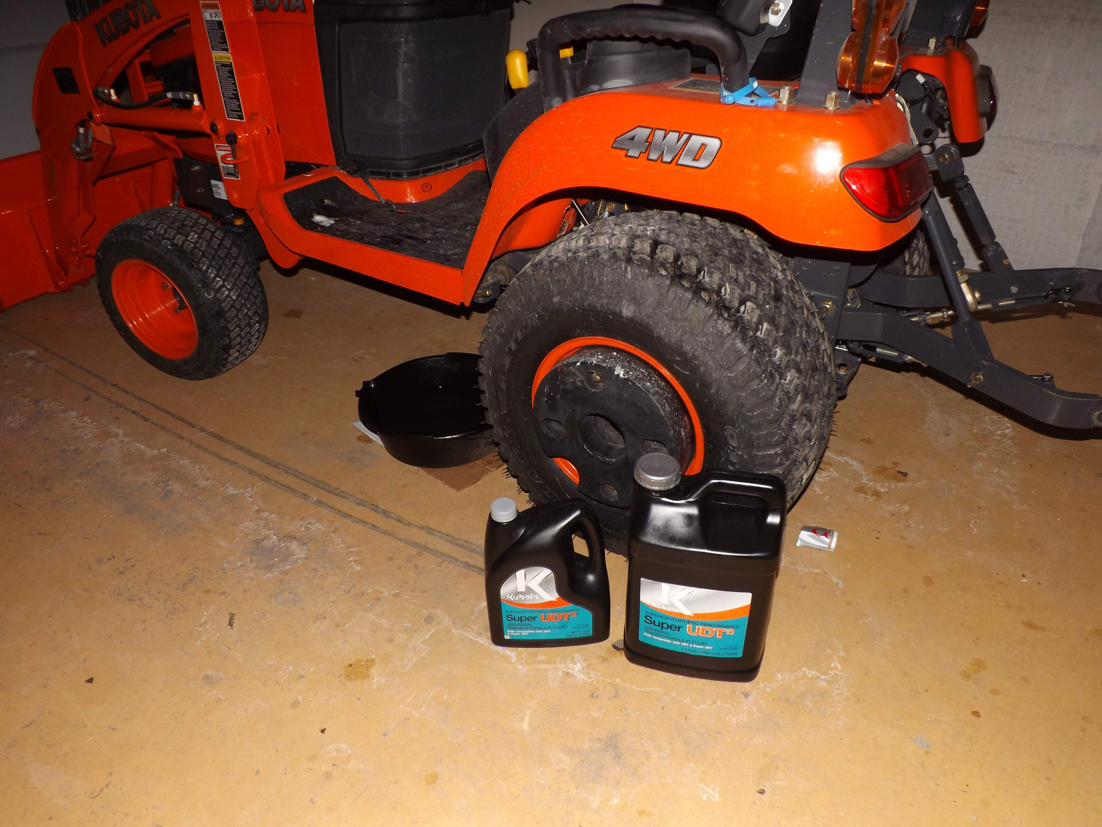

Cannot help you with the vacuum method, but I just dumped the HST fluid on my new BX2360. I had prepared cardboard for "the mess", but I gotta tell ya. Must be because I've done a few of these Kubotas over the years now? I don't know, but it was flat out the neatest job I've done. Piece of cake.
I just drained from the bottom plug. When my 2 gallon catch pan was getting full, I simply stuck the drain plug back into the stream and finger tightened it back up. Sure, my hand had a bit of fluid, but nothing bad at all. Rubber gloves or gas station cheapo plastic gloves would be just fine.
Brought my second drain pan into play and let the rest flow. Once done on the bottom, I moved back to do the screen, clean and re-install. Replaced the filter, took the bottom drain plug out one more time, just to catch the last of the dregs. Started refilling with the new SUDT-2. Ran the engine, then sloooooowly crept out to the drive to do some forward-reverse moves and worked the hydraulics and FEL. Gently crept back into the shop and topped off with maybe a pint. Done.
