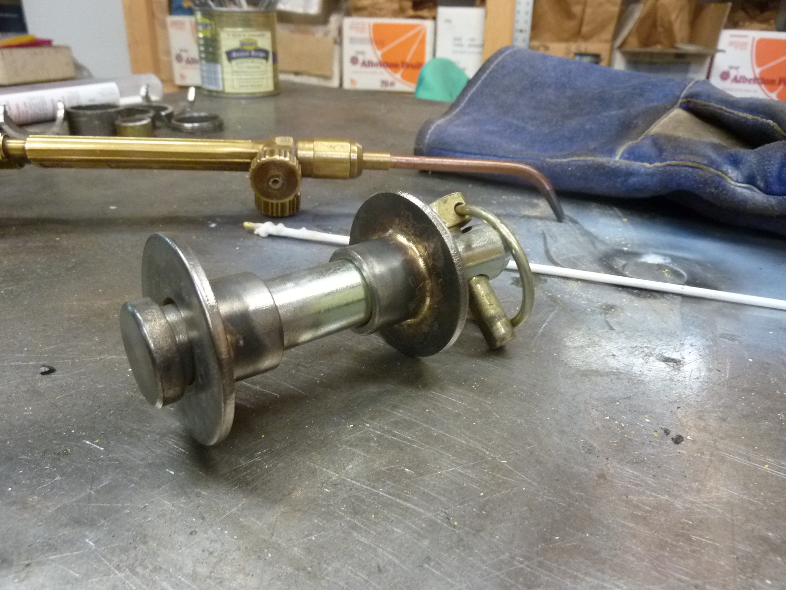

I had to make a split bushing today so I could use a Cat 1 top link on a Cat 2 implement. I brazed the short bushing pieces to the washers so the parts would be easier to find in the tool box and easier the assemble. Brazing was fast and easy. Maybe 5 minutes. I never hear anyone mention brazing now-a-days. Is it just to mundane to talk about or is it a process of the past? I still braze lots of stuff. If I tried to stick weld this it would be a mess.
gg

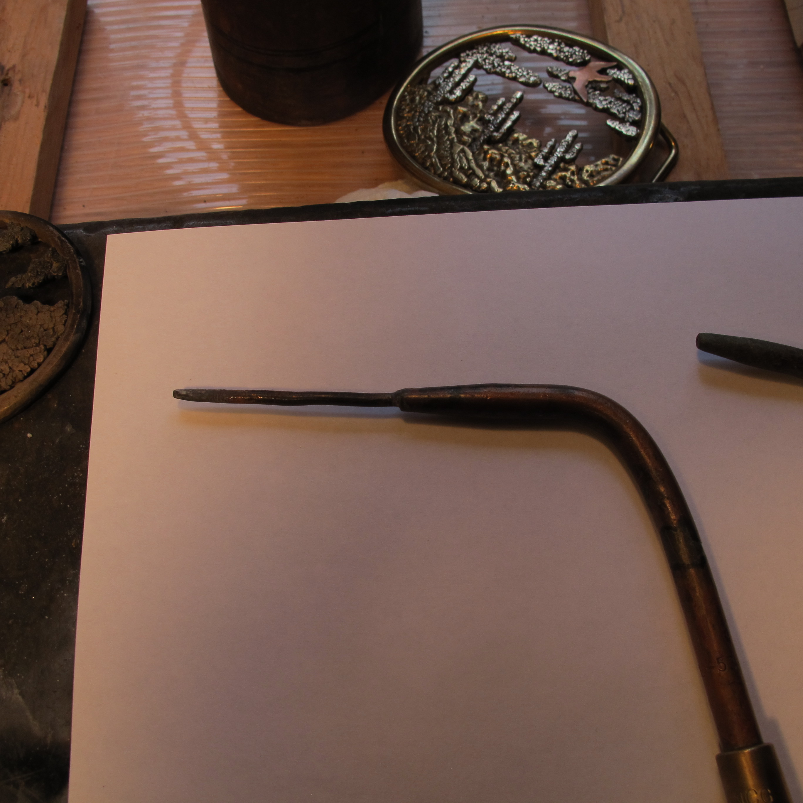

I like that #14 nickle bronze rod too. Sometimes it was called nickle silver but I don't believe there's any silver in it. It works almost exactly like regular brass brazing rod except like you say it has a higher surface tension as it melts. That's useful for doing free-hand work with the torch because a guy can wiggle the puddle into shapes as it melts. There used to be a whole world of non-ferrous rods available for oddball oxy/acetylene welding and brazing - but not so much anymore.
Here's a couple of examples of torch work along with a torch tip I made for doing fine work. The belt buckle's outer ring is regular low fuming brass or bronze rod wound around a piece of water pipe, brazed into a ring, and beaten into an oval over the horn of an anvil. The silver colored metal used for the inner design is that #14 nickel silver you mentioned.
The belt in the picture is 1 1/4" wide, so that buckle is about 1 1/2" tall overall.
enjoy,
rScotty
