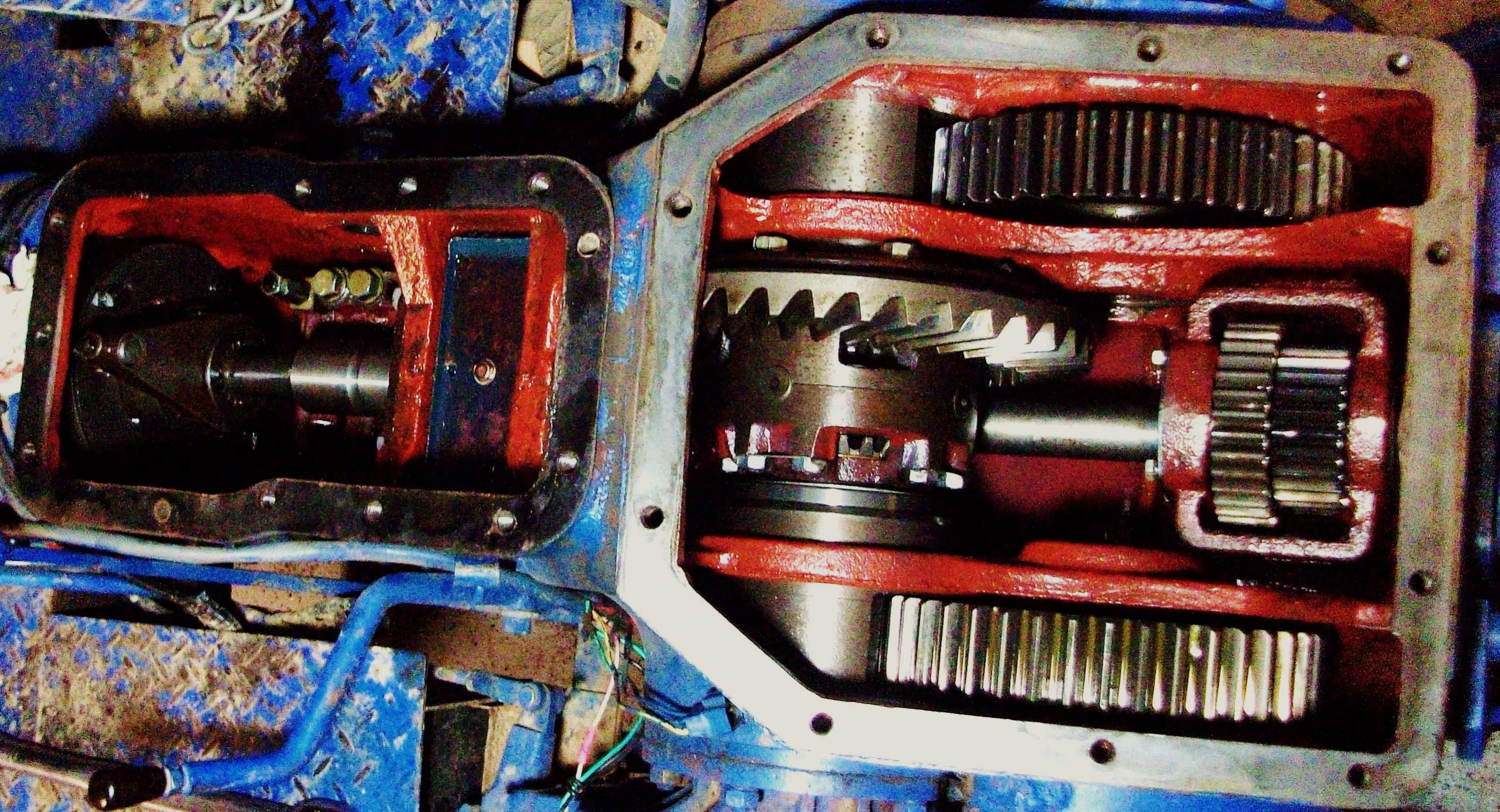

I disagree as to the oil pump being the culprit here - most pistons and cylinder walls are lubed by splash from the crankshaft throws (although some engines do utilize pressureised oil thru spurt holes in the rods and some do use oil thrown off from the rod journals) ... If the oil pump had failed it would be much more likely IMO to have siezed or spun crank or rod bearings especially on a new engine .
I think Rich is on the right track that heat- as in running a brand new engine hard right off the get go and then on a hot day running a high RPM implement like a rotary brush cutter at full speed and load- clearances tightened up friction increased and rings broke...If there are compression rings that are still in one piece I would insert one down its bore and check the end gap.. just to see if the gap is enough that the ends are at a minimum of around .014" wouldn't be the first time an engine suffered from being assembled a little tight... or not being broken in as per manufacturer ( and some chinese tractor engine manufacturers break in is a little brutal ...)
as for sealing the interior castings - all of the insides of the sumps of chinese manufactured tractors i have seen on TBN and my own have been sealed at the factory- and IIRC my American tractor was not...
