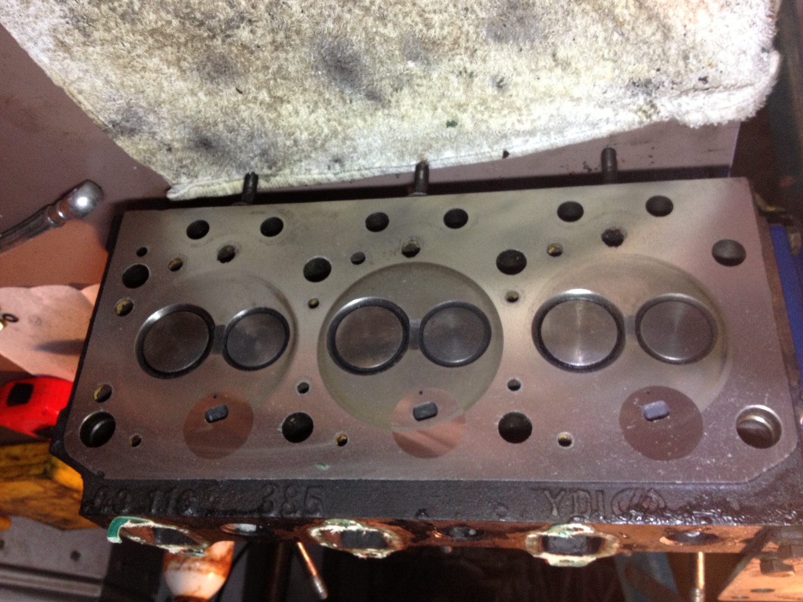

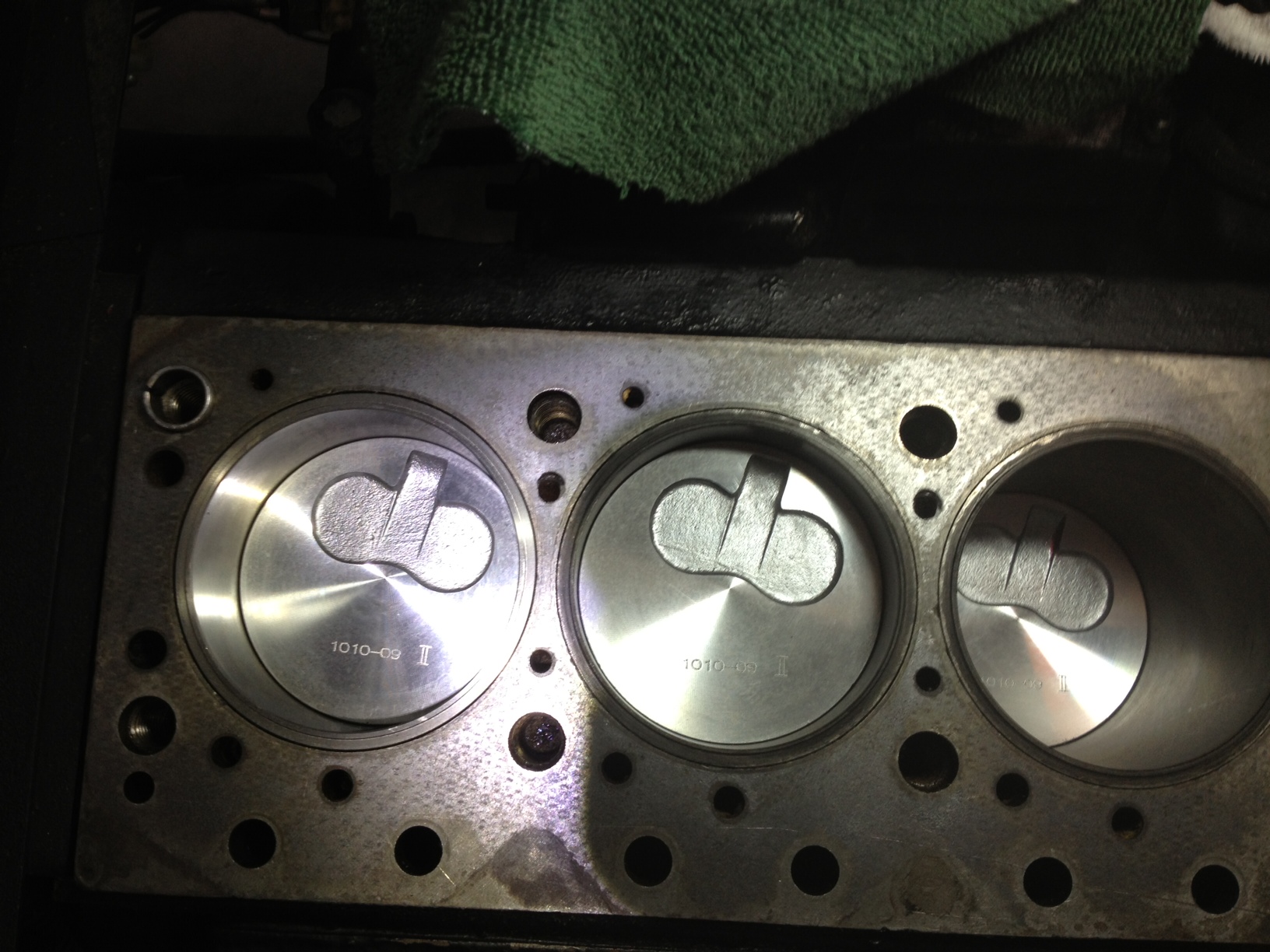

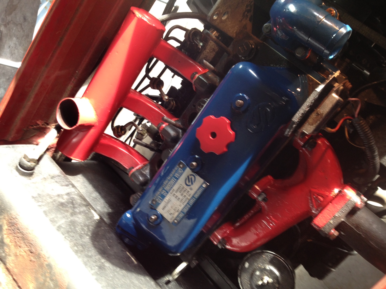

well shes back together, well everything except 2 injectors and oil, water, rad hose and to bleed injectors, ran out of time but ill fire it off tomorrow morning, I torqued all the rod bolts down to 80 ft lbs and head bolts down to 120ft lbs and all went good, i also torqued all the oil pan bolts down to 20 ft lbs, and did the valve train to 20ft lbs, ill add a few pics

well she runs but now i have another problem she wants to run away, good thing i had my hand on the fuel shut off or she might of blown, she fired up and got to about 2500rpm before i had time to shut it down, can i take the part of the ip pump that has the throttle part in it and try to fix it or will there be a bunch of crap that i cant put back together in there
