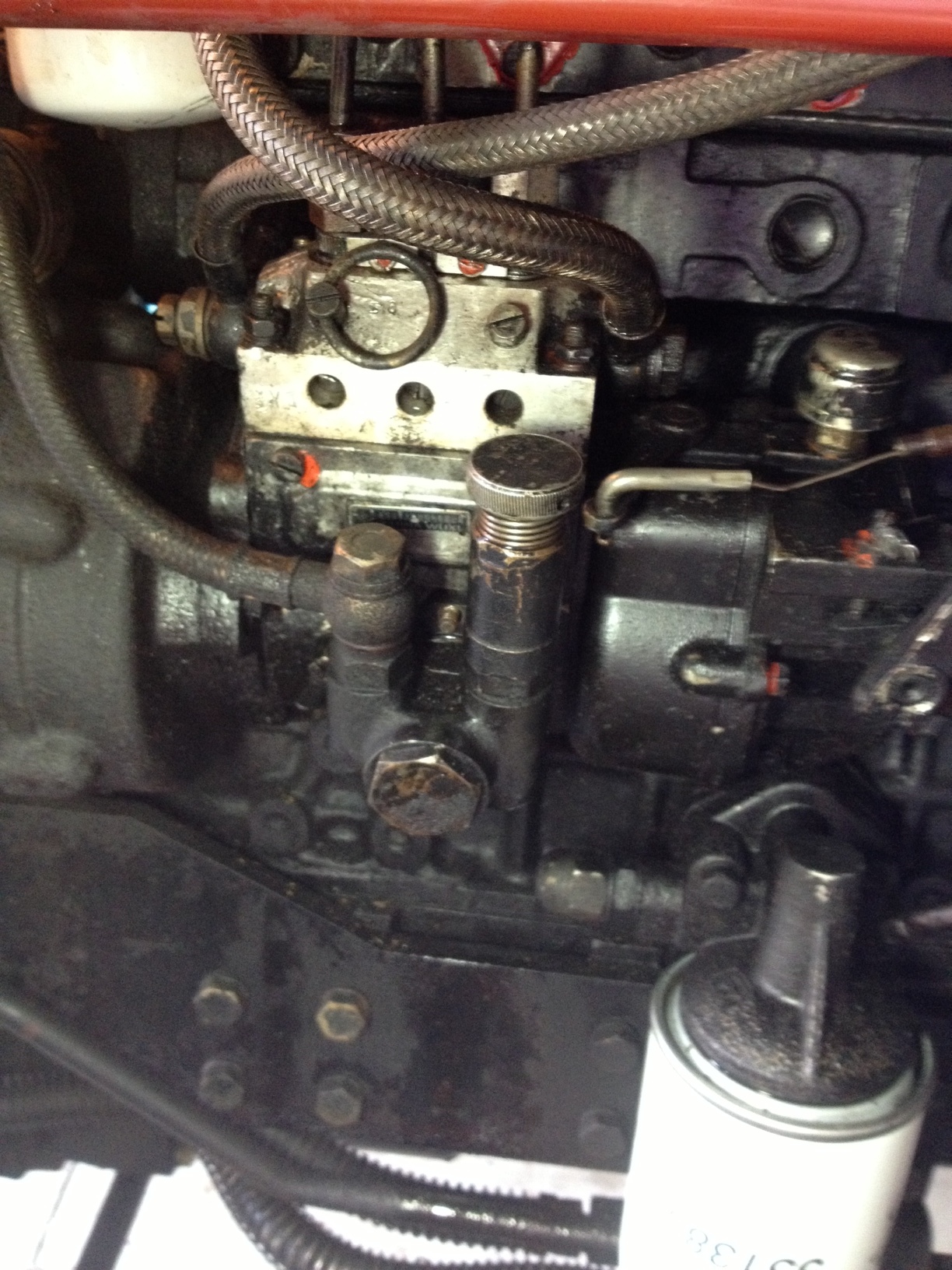

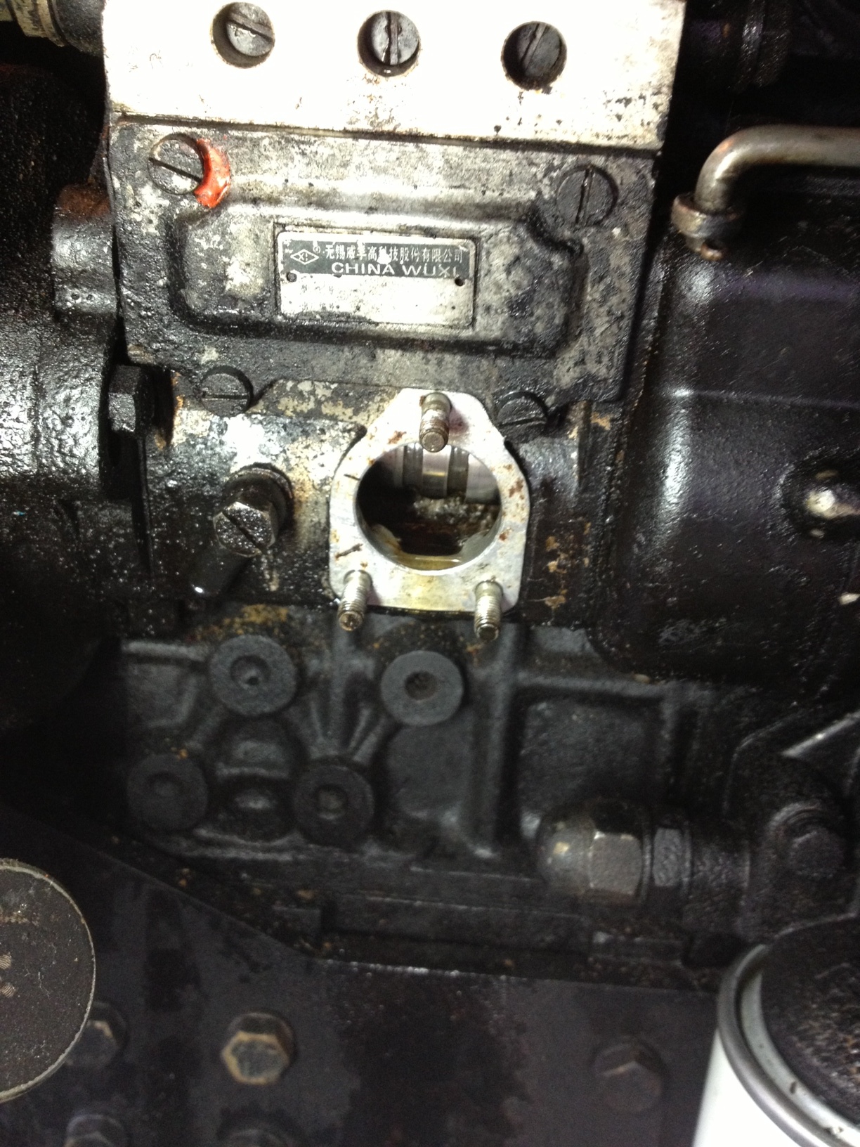

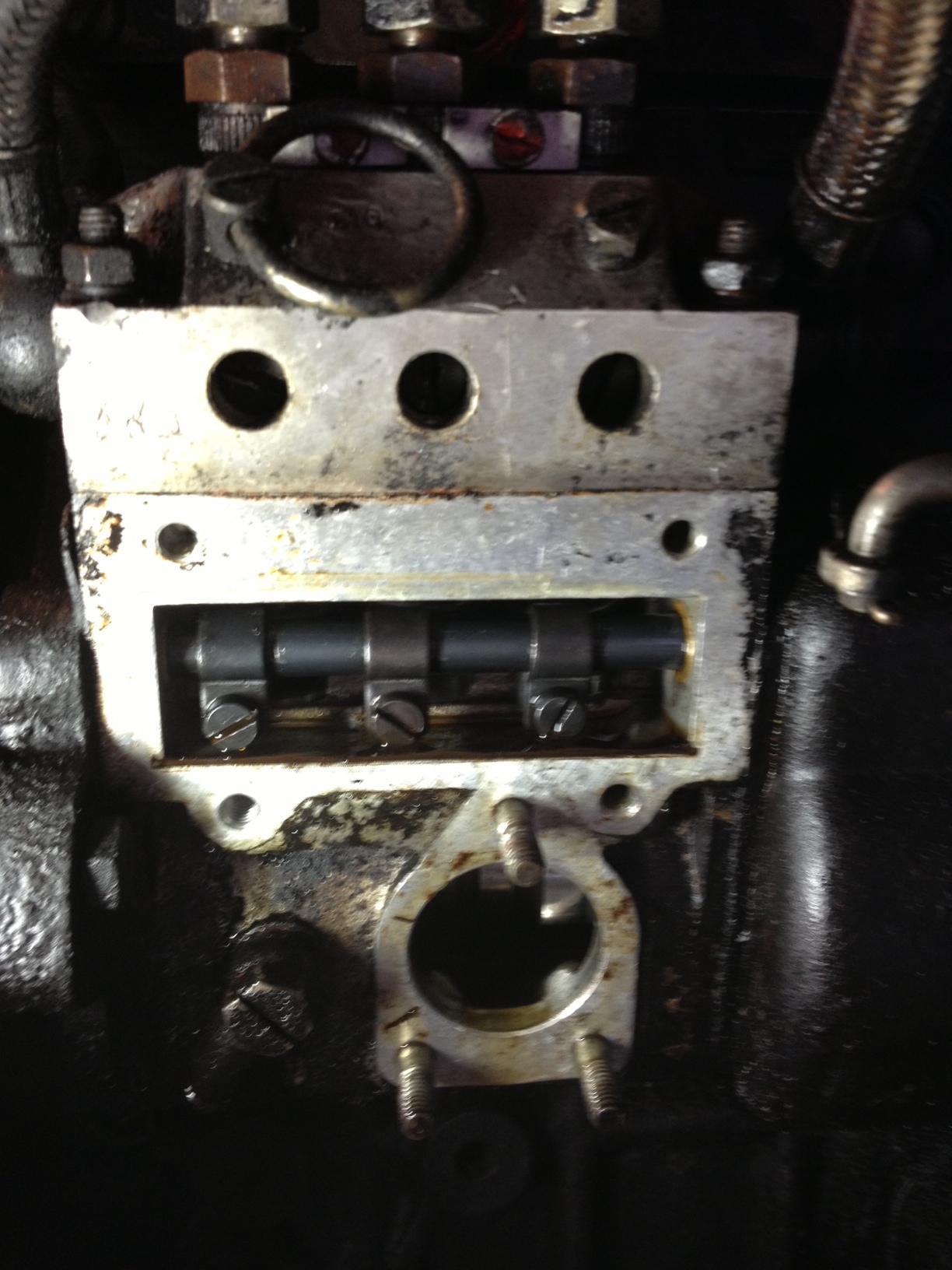

It sounds like your governor rack is stuck open, alright. Glad you got it shut down in time!
You could try draining the lube out of the injector pump and refilling it with kerosene, let it sit overnight and then drain the kero out and refill with oil and see if that frees up the governor. You MAY be able to open the governor side and check it out, I don't know. Bob Rooks can probably advise you better on this. You definitely cannot open the IP side of things unless you want to buy a new pump assembly - not serviceable at all.
   / dongfeng tractor with y385t wont start help
#182
its all good I called tommy at affordable tractor and he told me how to get in there, and yep the rail was stuck and there was some crud in therte that no soaking would of helped, I took pics of how to get into the pump were the rail is, its pretty easy first you take the 3 small nuts off holding the primer on the ip pump, take the fuel hose off comming from the tank so the primer caan swing out of the way, then behind it there are four flat head screws holding on a plate, take those out and there is the rail it is a dark grey bar with 3 screws on it, it needs to be able to move free, under mine was a blob of gunk you can see it in the pics , spray it all out with wd40 and your good to go, put it back together and fill her up with oil and if that was the problem it should work, mine is running great a little clackity but i guess thats how these chinese engs sound

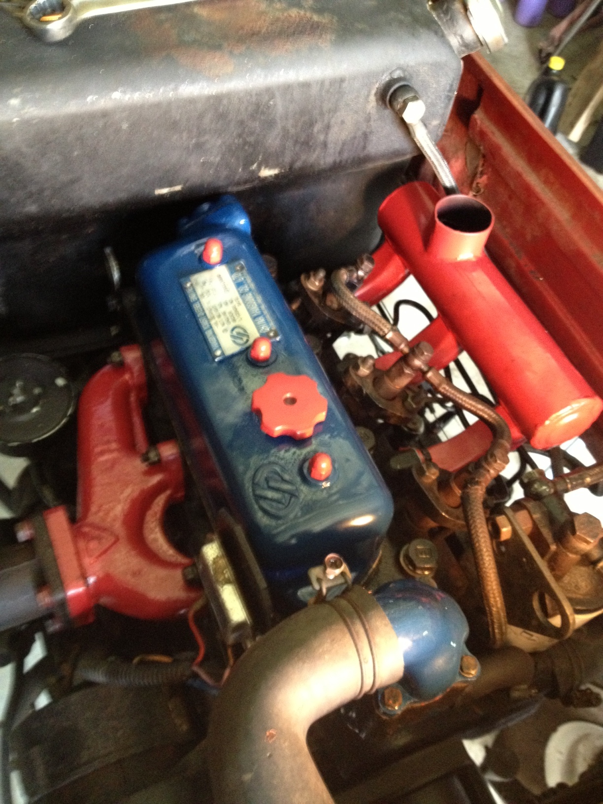

It looks Great, glad it is going, now all ya have to do is get the air cleaner and little things back together and start using the beasty...
M
#184
yea i still have to sand and ospho the fuel tank, then re-paint it and im not sure if ill re-paint the air box or not it looks kinda bland just black, I also have to change out the fluids in the trans, I would of got more done today but I had a b-day party the fam and I had to go to so I had to leave it, but after church tomorrow ill be back at it, in one of the pics above I shot the oil pressure at idle 800 900 rpm is that an ok oil pressure it does rise to the middle of the .4 and .8 on the gauge when the rpm is up around 1100rpm
   / dongfeng tractor with y385t wont start help #185
Oil pressure looks real good - in your picture it looks to be pointed at .4 to .5 MPa on the gauge which if set up like mine works out to between about 55psi @.4 to about 72 psi@ .5 Glad she's up and running:thumbsup:

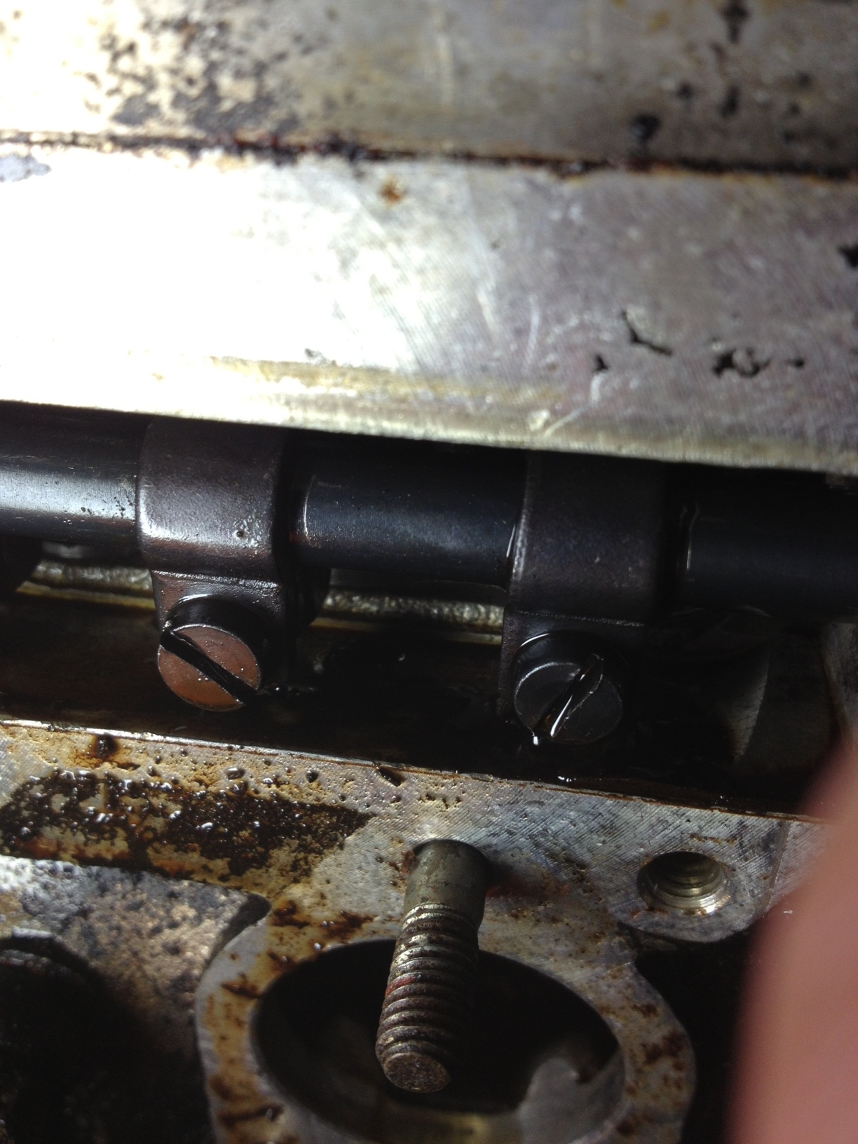

Guessing those injectors could be a little gummed up, after sitting for so long- may just need some running time to completely clear all air out of the injection system and smooth out or you could have a bad injector..?? May want to check the valve clearances when head re-torque time comes -loose settings making the top end a little noisy
