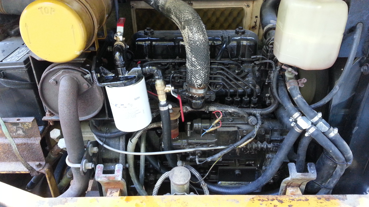

Just as an aside and FYI, here is the coolant filter I just installed on the excavator. It was pretty easy because there was already a cab heater and I just tee'd into the lines.
