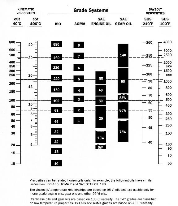

hey bob i just ckd and if iso 46 is the same as n46 thats what i have and the iso 46 is has the same weight as SAE 20 or its Equivalent
I keep forgetting that it's not a Jinma. Sorry.
I can't say if n46 is the same as ISO 46

N46 is the Chinese expression for either ISO46 or AW46. All three are the equivalent of a light 20 weight engine oil. N68/ISO68/AW68 is a slightly "heavier" 20 weight equivalent. But ISO46/AW46 are specifically hydraulic oils, not especially suitable for gear trains. You should be using trans-hydraulic fluid, commonly called UTF or THF. Whatever the name, it too is a 20W equivalent - but is actually formulated for gears AND hydraulics. On your tractor, one common fluid is shared by the transmission/rear diff and the hydraulics. The front differential however, is independent. You can use UTF/THF up there, but personally I'd recommend conventional 80W90 gear oil.
