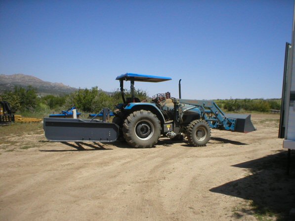

I made one on my L4350, works pretty slick, I have to keep the 3PH lever in the down position when I use it and use the down pressure cylinder to lift. It does allow a certain amount of grader type action but the weight of the tractor has a lot to do with it. I have been meaning to do some more refining and probably will when time allows.

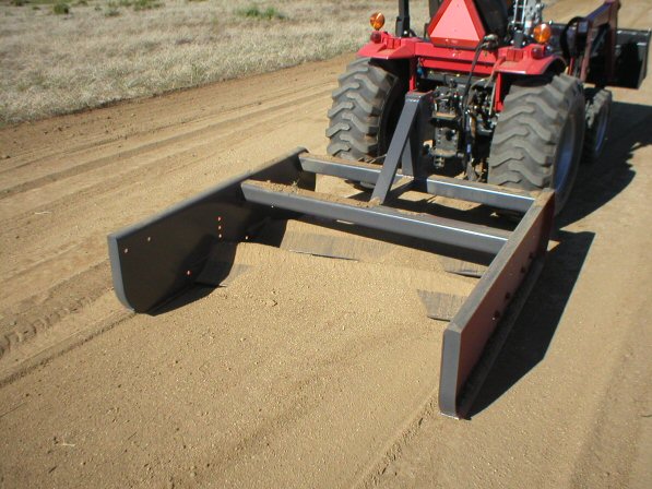

My driveway is .25 mile long with many layers of limestone of different sizes over 20 years added to the clay soil. It still gets humps as he described in the winter and spring and it too dries out like concrete in the summer. I adjust my rear blade at an angle and while it, and the tractor, are on level ground I drop the lift and draft levers all the way down then bring the draft back up just enough to hold the blade edge at ground level. A couple trips down and back gets rid of the hump and fills in the tire grooves. Then as it dries out more a couple passes with my landscsape rake brings the limestone up and evens it out. Looks like a new load after a rain washes off the clay from the stone.
It's not a perfect solution, I guess, and it takes some learning of the controls, but I have 20 years worth of that.
Most folks try to dig too deep with one pass and make a worse mess than before they started. The length of the top link is important too so the blade will dig in but not too aggressivly.
All this wouldn't matter in your Florida sand where the leveling is easy:)

This.
Shallow pases, angled blade. Move the gravel over to the left, move the gravel over to the right. Move the gravel back to the middle. Go in the spring or whenever your ground just kinda starts to dry out. Angled blade gets rid of washboards. Straight blade or boxblade magnifies the washboards. Potholes you need to cut down the road to level of the bottom of the pothole all around, then get the gravel spread out again over the road level. Potholes like to reapear, just dumping loose gravel in the dips makes a pothole reappear.
Down pressure really isn't going to help a whole lot, angle & tilt of the blade means more.
And the last passes with a landscape rake are spot on, angled & a little on the faster side, brings the rock to the top. If I get the right day in spring here in MN, I just use the landscape rake, it cuts through the wet gravel good and levels everything up with about 5-6 rounds with the rake.

Depending on what you want to do, how much of it is to be done, etc.
ONE alternative might be to use a FEL Skid Steer to 3pt adapter and do what needs to be done backwards.
I have one, I use it with a sub soiler for picking at roots, then spin around and use the hoe to get the rest of the root ball out.
It is also handy when I just need to throw a rake or something on and the back ends of all available tractors have hoes or some other inconveniently large implement on them.
