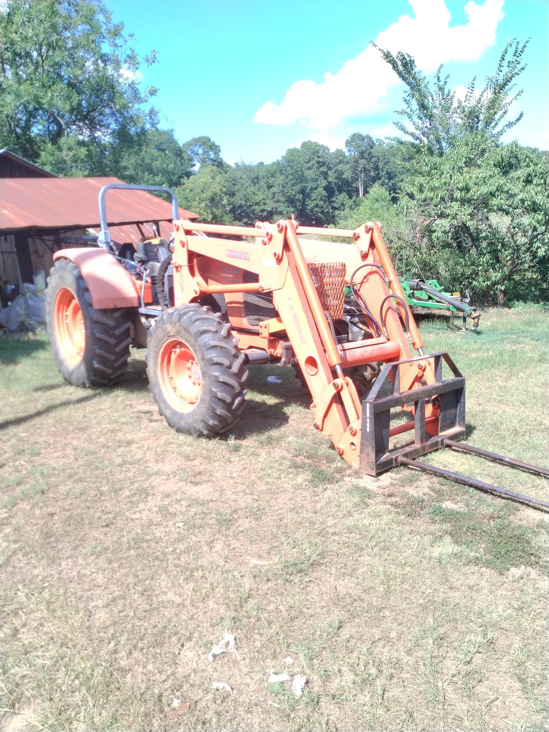

M105s, he may have a cab tractor.
/ Dozer Blade or Grader Blade?
I've still got the B7500 - I've widened it and put ballasted trencher tires on it though. Now it's almost 70" wide in the rear. The M105S is still in route to me. Those pictures are what it is, no cab.
What size are those tires??
Mine is coming with ones quite a bit bigger and I'd like to get shorter and fatter.
